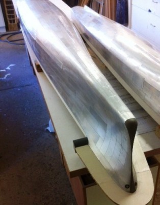

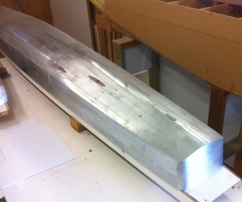

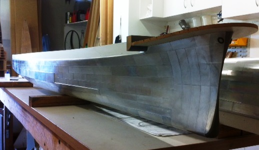

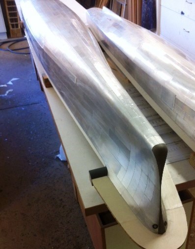

G'day All,
Just got an email from Tim at Southern Cross Models as he has just finished the 1/72 scale plug for the Baltimore class Heavy Cruiser. This plug will do the first four ships of the class Baltimore, Boston, Canberra, and Quincy once the mould is made Tim will modify the plug for the round stern hull of the rest of the Baltimores and Oregon City class and make a second mold...
Price for Hull will be $700 AU (which is about $553US at current xchge rate) plus shipping, contact Tim at Southern Cross Models if interested. There are some other really cool hulls available too.....
Here are some pix of the plug.....
Cheers Bruce
PS This hull is 2.85m x 0.30m with about a 12cm draft....
