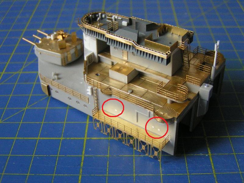

Hello Town Class fans,
I’m currently in progress with Trumpeters HMS Belfast. I use the Flyhawk and WEM set as well as some scratch build parts. References are AOTS, Man o’war 5, Warship in Profile Vol. 3 and some other resources including www.
Due to all the references there are only limited photos of HMS Belfast in her 1943 fit and at the moment I’m searching for information about the paravanes attached stb. and port to the superstructure – see red circle. There should be a derrick to handle the paravanes, but I could not find any detailed information. The sketch in AOTS shows a “structure” next to the paravanes, but I’m not sure if this is a derrick and/or how it should look.
Would be fine if some of you shipmates can help.
TIA

PostPosted: Tue Feb 03, 2015 4:12 pm
Posts: 435
The photo at http://www.naval-history.net/Photo06clBelfast2NP.jpg shows a paravane boom roughly halfway between the locations circled - admittedly on the starboard side. AOTS shows two stowe,d when not in use, on "B" Gundeck, one either side. The photo's said to have been taken in 1942.
PostPosted: Wed Feb 04, 2015 1:43 pm
Joined: Tue Nov 21, 2006 7:44 am
Posts: 559
Location: Germany
Hehe, looks like I did not see the wood for the trees :big_grin:
Thx tjstoneman for your very kind help and support :thumbs_up_1:

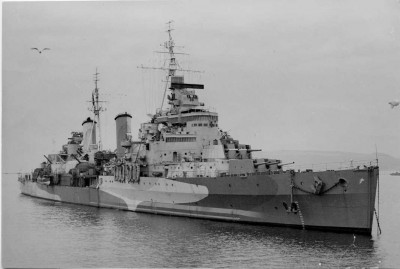

OK, finally returning to work on my Trumpeter Belfast after a 2-year hiatus...
Trying to figure out Belfast's Admiralty Standard Scheme. I know the colours are:
507A Dark Grey
B5 Dark Blue-Grey
B6 Blue
507C Light Grey
For references I have been using Ross Watton's Anatomy of the Ship, Ensign #5, Warship Perspectives Volumes 2 & 4, "British Cruisers" by Raven & Roberts, a few other books, box art, painting instructions from both Trumpeter and Airfix, and images culled from the net.
There doesn't seem to be any consensus on the pattern or on what colours were used in certain areas. Specifically, there seems to be disagreement as to whether or not there was a B6 panel below the B5 panel on the port bow, whether the aft HACS director was B6 or 507C, and - the one that's really giving me sleepless nights - what is the dark colour carried on her port side amidships?
Conventional wisdom seems to be that the port side of the aft funnel was painted B5, and the side of the hull and superstructure below it 507A. However, in photos where these two colours are side-by-side, you can see that the B5 is a lighter tone. You can see this in the photo of Belfast taken off her starboard bow. The first panel is B5 and the panel directly behind it is 507A. Now, when you look at the second photo, taken off Belfast's port beam, notice the tone of the aft funnel compared to the hull. To my eyes they appear identical. So is the funnel actually 507A or is the hull in that area B5?
Opening the floor to opinions...

PostPosted: Mon Jun 13, 2016 1:45 am
Posts: 1813
Hi longshaor,
I'm just trying to resolve the same puzzel, and your photos are very helpful, thanks!
Speaking about the port side picture, to my eye the funnel is a shade lighter than the hull. So I opt for both funnels being ap507c and b5, although on different sides.
Brings me to the conclusion that b5 was only used on the bow and on both funnels. But I have to admit it's arbitrary... Wish there were better references!

PostPosted: Mon Jun 13, 2016 3:49 am
Posts: 1813
Added here two more views from the port side, and I'm starting to rethink your view: that rear funnel is very dark indeed, could it be that it was in ap507a after all?
But there is more to see: have a look at your picture from the port side: what shade do you think is the patch on the hull, below the forward superstructure: could it be B5 possibly? On the pictures I post here it seems to be much lighter. Maybe there was some variation in the paint scheme too, over the time it was worn?
And another one: what do you think of the colour of the forward 6" director, when you compare it to the rear one? It seems darker to me: maybe B5 too?
Questions, questions....
Roger Whittaker +9/13/2023
PostPosted: Wed Jun 15, 2016 1:57 am
Posts: 1813
When you start looking closely at the picture, you begin to see more and more...
I'm getting the strong impression now that the port side of the forward funnel is also one shade darker than always assumed. That means it would be B6 blue instead of ap507c. This seems to be confirmed by the head-on picture from the stbd bow as well.
What do you think?
