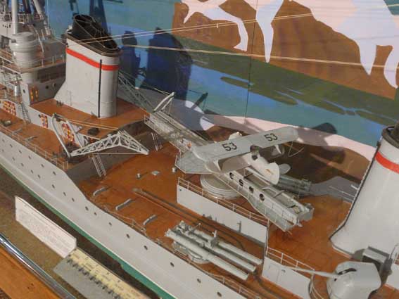

Does anybody know what color the main decks of these ships were? I can find only 1 color picture of the main deck, (that pic is posted here) and it seems to be a kind of chocolate brown. I have Combrig's Maxim Gorky up next in the pile and I can't find any good pics of their decks, even in black & white. Did these ships have wooden decks? Any help is appreciated. Thanks.
PostPosted: Tue Mar 28, 2017 2:42 pm
Joined: Thu Aug 23, 2007 5:51 am
Posts: 197
Location: Bedfordshire England
There is a large scale model of Kirov in the entrance hall of the Northern Fleet Museum in Murmansk. The decks appear to be a medium brown which might be similar to the colour of linoleum. The decks don't appear to be planked.
PostPosted: Thu Mar 30, 2017 3:07 pm
Thanks, finnfan, that helps a lot. There are very few pictures of these ships on the web that are NOT taken at sea level, and from a distance, so making out details such as deck color and material is a challenge. I was able to find one or two B&W pics that seem to show, as you said, a linoleum-like surface. It clearly doesn't look like wood, and the Combrig kit does not have planking scribed into the deck. Their Sverdlov kit, however, does have planking scribed, so I am assuming that class of ships had a wooden deck?
PostPosted: Fri Mar 31, 2017 1:11 am
Posts: 3851
Location: Bonn
The Sverdlov class had wooded decks, whereas the Kirov class had linoleum. I checked the special volumes about both classes by Okręty Wojenne (Nr. 18, 29, and 30).

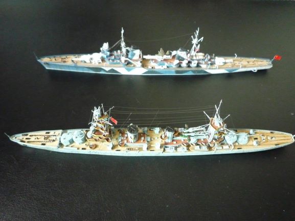

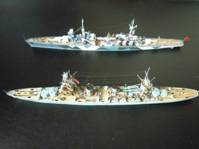

PostPosted: Thu Oct 25, 2018 3:35 am
Posts: 128
Location: Shanghai,China
PostPosted: Thu Oct 25, 2018 11:54 am
Posts: 3851
Location: Bonn
Nice models!
Do you used a kit for Krasnyi Kavkaz?
PostPosted: Thu Oct 25, 2018 7:26 pm
Posts: 128
maxim wrote:
Nice models!
Kirov use combrig,and the other
