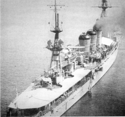

PostPosted: Thu Nov 06, 2008 4:16 am
Posts: 352
Location: roma, italia
it is a foto of the kuma with the deck looking like extended on starboard side
ciao peppe

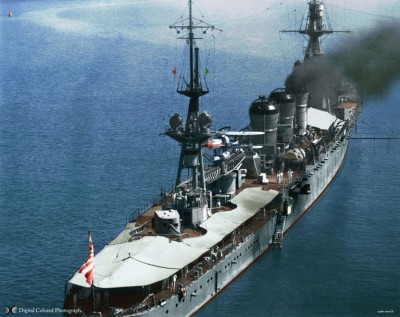

PostPosted: Thu Nov 06, 2008 1:35 pm
Posts: 8848
No, no, no, it's to her port side. Easier to see in this colorized version
Hi Dan,
:Oops_1: , I stand corrected. You are absolutely right. I have checked on my "Lacroix and Wells Japanese cruisers of the second WW" and you have on p.190 Kuma's drawing showing clearly the aft deck extension on the port side. On the other hand, Tama's aft deck extension is being confirmed on the starboard side according to the drawing on p.197.
Question for you : why is there such a difference for two ships of the same class ?
cheers
