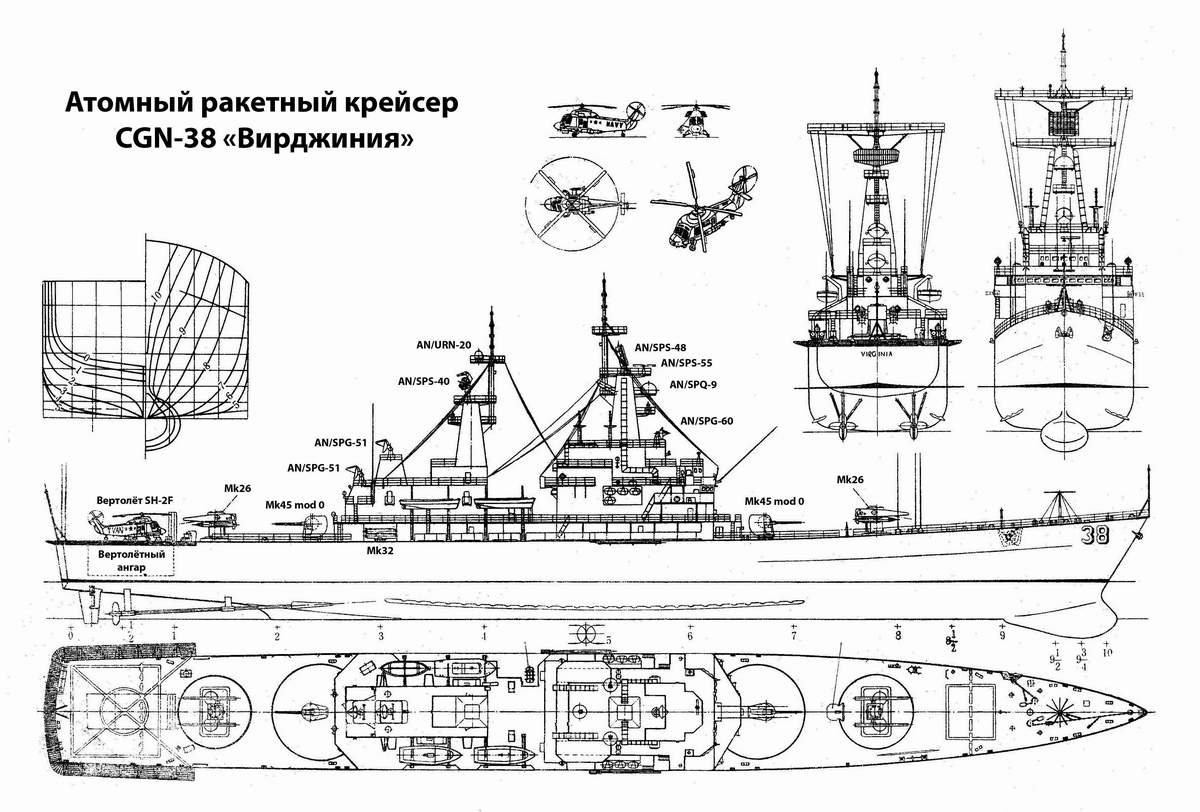

Posts: 12325
Bob, no doubt the accuracy of this would be in question, but it might be able to help you as a starting point:
Taken from the airbase.ru forum.
Here's a really poor-quality scan from elsewhere:
