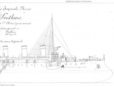

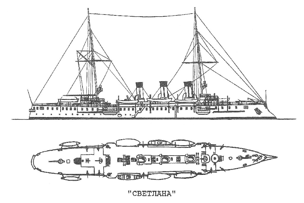

I am looking for plans of weapons/fittings and hull sections for this vessel. I have the pictures from Navsource.narod.ru (http://www.navsource.narod.ru/photos/02/016/index.html).
I have also looked on the Airbase.ru forum, and found a couple of overhead and side profile drawings, but still require the hull sections and some more detailed drawings of the fittings. I am including these attached below to avoid replications.
I know Combrig makes one in 1/700, but am thinking of trying my hand at scratchbuilding one in 1/350 or slightly smaller.
Thanks in advance!

Here is some info on the Russian guns of the period that you would need for Svetlana:
6"/45:
http://www.fortification.ru/oldforum/in ... topic=1107
http://svsm.org/gallery/152mm_Canet - this one is on the coast defense mount, so there will be some differences with a ship mount.
75mm/50:
http://www.fortification.ru/oldforum/in ... topic=2340
http://svsm.org/gallery/75mm-m1892
47mm Hotchkiss:
http://upload.wikimedia.org/wikipedia/c ... rine-1.jpg
37mm Hotchkiss:
http://www.fortification.ru/oldforum/in ... topic=1150
http://svsm.org/gallery/37mm-Hotchkiss
There is more info, but it's on the sites that this board doesn't allow to be linked to it (for copyright violations). If you want that info, send me an email - yak_v @hotmail.com
Vladimir

No, they were installed above the casemates before the ship went to Tsushima. Here is the location of the guns:
http://russiannavy.net/models/mics/SvietlanaGuns.JPG
BTW, do not use this drawing, it's inaccurate. Use the other ones that you linked.
Vladimir

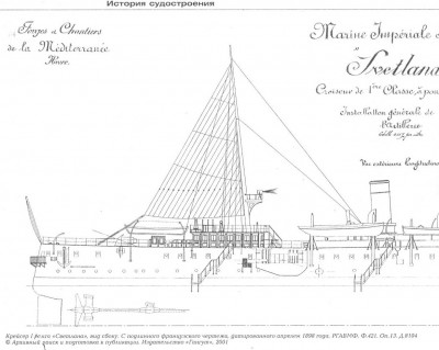

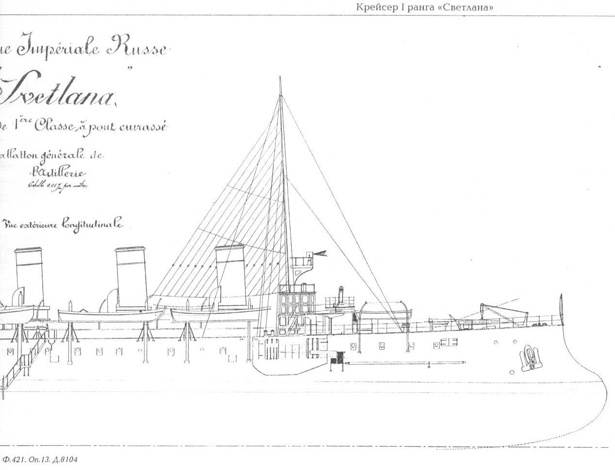

Here is all of the info that I have on Svetlana, two articles and some drawings (27MB):
http://www.russiannavy.net/uploads/Svetlana.rar
Vladimir

I assume the 2001 plans are more accurate?
PostPosted: Wed May 06, 2009 3:31 pm
Joined: Tue Feb 15, 2005 8:40 pm
Posts: 358
Location: Fremont, CA
Timmy C wrote:
Got it, awesome!
I assume so, they seem to be the reprints from the archival plans so I'd assume that by default unless you can get the photos to confirm it, they are the more accurate ones.

Here are some more photos of Svetlana:
http://tsushima.su/RU/shipsru/shipsruss ... lanaphoto/
Vladimir

In the 2001 plans' profile view, do the diagonal lines on the masts indicate sails?
PostPosted: Thu May 07, 2009 3:30 pm
Posts: 358
Yes.
