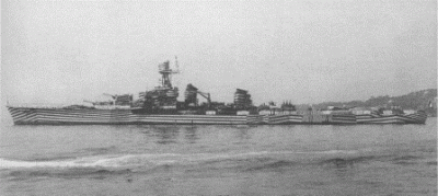

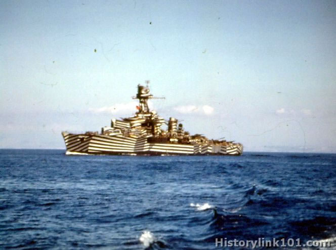

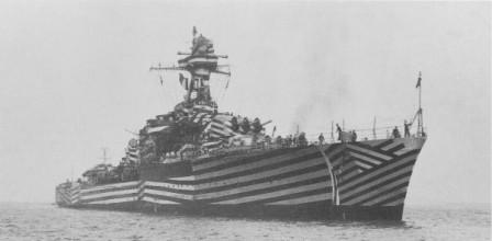

I'm new to this forum and surprised to see little on these magnificent cruisers in this forum or on the internet as a whole. In my research for this ship I havn't found much on small plastic kits and none in the larger 1/350 scale for these ships, which is a great shame.
I decided to build a large model of this class a while back. I have received my new plans of the Georges Leygues from France about 3 months ago, they are very nice i must say. And the hull master is well under way.I'm planning to build the Gloire in it's 1944 camo pattern in 72nd scale, as i have almost finished HMAS Hobart 1945 in this scale ,too. Here's 3 photo's of this painting challenge;
