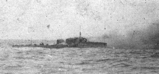

Thanks all - where is the photo of HMS Mary Rose sinking from? Do you know which ship it was taken from? Thanks
PostPosted: Sun May 10, 2015 3:51 pm
Posts: 437
Found Mary Rose here:
http://www.warshipsww2.eu/lode.php?lang ... trida=2200
Pic was most probably taken by the germans (SMS Brummer or SMS Bremse).

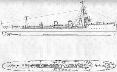

Calling all British Destroyer fans - does anyone know a source for plans "Acorn Class" destroyers, 1910 (20 ships).
I have tried all the usual plan suppliers but no-one seems to carry these.
I work 1/100 to 1/200 scale but drawings of any scale would be useful as I can scale to suit.
Bill of N.Z.
PostPosted: Thu Jul 27, 2017 3:50 pm
Posts: 437
Joe,
There is top and side view in "British Destroyers" by Edgar March.
I started building one using a plan of the Acheron published in French magazine "MARINES & Forces Navales n°95" (Feb-Mar2005).
Same magazine n°94 had an article about the Acorn Class.

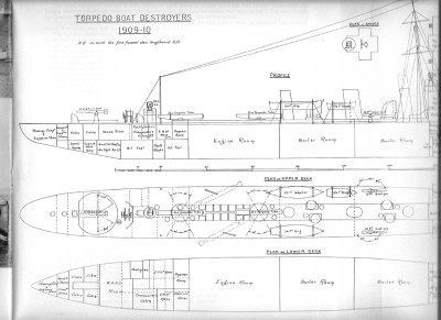

Hi Joe,
The top and side view in "British Destroyers" by Edgar March is a Sketch drawing. These were sent out by the Admiralty so that builders could quote the scope of work. Attached is the drawing. Note that in the upper left corner of the stern drawing it states that the forecastle was lengthened 6 feet.
As you can see, these are very preliminary drawings.
March did provide a very good set of drawings for the I Class HMS Ferret complete with General arrangement and Section drawings. PM me if you are interested.
George

Thanks George and Moomoon - I am getting somewhere at last - maybe! I have March's book on order from our local Library so that may turn up something. Why I am pushing this particular ship to model, is because I have been asked to make a model for a presentation to a retiring director of an organisation, where the name "Acorn" has some significance. There are no other ships that I can find that carry the word "Acorn", except for an old time sailing vessel. In the usual way I would put this in the "too hard basket" and make a ship that is well documented, plans etc.
If I can't get the March book through the library, I might ask for a copy of H.M.S. Ferret and adapt from there. Just hold at present.
I have a very good plan set of H.M.S. Swift, which I made a couple of years ago, which is very similar, so with combining all this information, I could manage.
Joe-N.Z.
PostPosted: Tue Aug 08, 2017 11:58 am
Posts: 437
Joe, Georges is right, the plan in March's book is just a sketch drawing that doesn't look much like the real thing.
There is a better one in Norman Friedman "BRITISH DESTROYERS From Earliest Days to the Second World War".
The plan of Acheron class in Marines Magasine is HMS Ferret
There are pics a detailed 3D model on "Dreadnought Project" website (Acheron).
