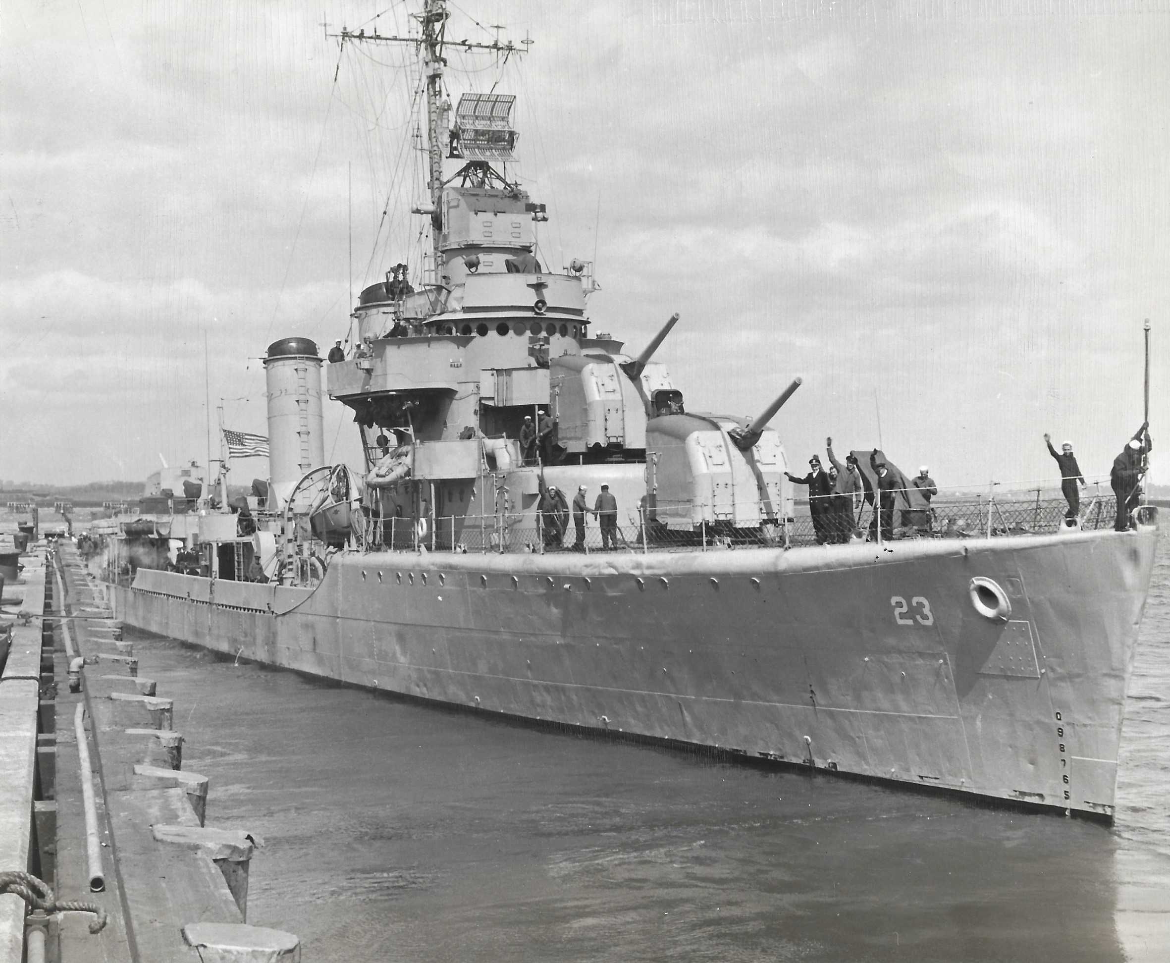

PostPosted: Fri Oct 29, 2021 11:07 am
Joined: Wed May 12, 2021 9:48 am
Posts: 6
Caption: "USS Macomb sets sail from Boston for Panama" Date: April 1st 1947
USS Macomb DMS-23 Departs Boston for Panama April 1st 1947 resized.jpg [ 292.62 KiB | Viewed 3629 times ]
Conducting Tier 12 ops at Fort Living Room.
