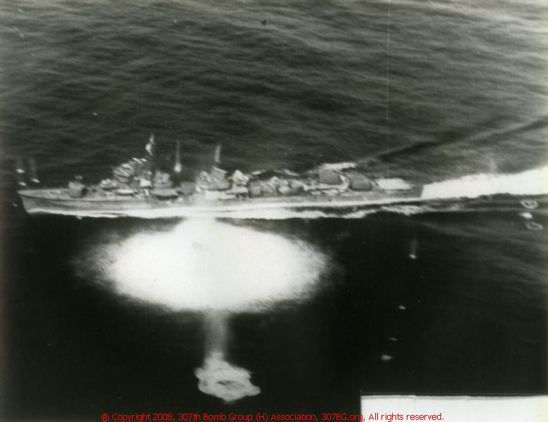

The Amagiri had an interesting midwar AA fit. She gained a twin 13mm in front of the bridge on a bandstand, as did all of the Fubukis (initially) and also two twin 25mm AA mounts on the platform in front of #2 funnel. Among the Fubukis, I believe only Usugumo also carried twin 25mms in this position. This all came to light recently when Gakken #70 was published as it included a reprint of her official midwar layout as sketched by a naval constructor (possibly Fukui himself). The kit is faithful to this new layout. No triple 25mm AA is mounted at this time.
As to whether or not she carried white ID striping on her funnels is open to debate. I believe she probably did. The photo below was taken during the November 1943 raid on Rabaul, where Amagiri's TROM registered both her presence and a near miss from a bomb. I believe that it is Amagiri, based on process of elimination. Not all my contacts concur but, my Japanese ones do. Now, this photo takes place several months after the PT-109 incident so, we can't be certain of her appearance at that time but.........no one can prove you wrong, either. There is one thin band around funnel #2.

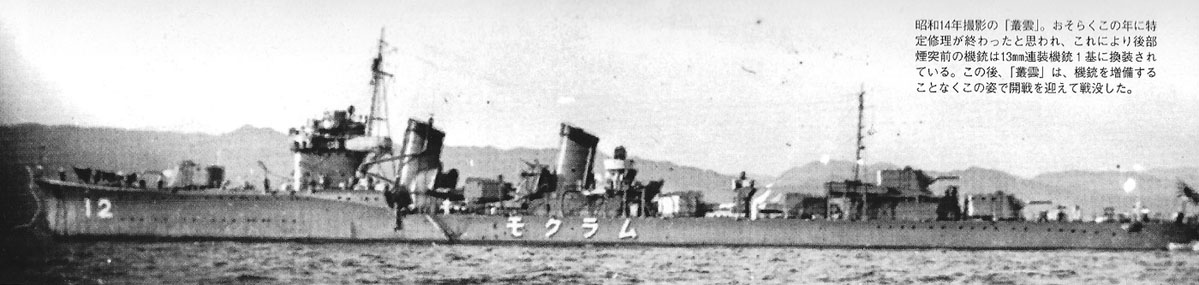

Funnel rake - here is a previously unpublished photo of Type I Murakumo in 1939 from Gakken #70. This is the configuration and fit of all the Type I Fubukis upon entry to the war, less the writing on the hull sides, plus the addition of a degaussing cable. The angle and height are as good a guide as you'll get.

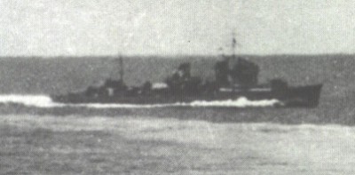

Hatsuyuki's & division mate Fubuki accompanied cruisers Aoba, Kinugasa and Furataka at Cape Esperance in October, 1942. This photo of one of the DDs was taken on the eve of battle from Aoba. A closeup shows her to be wearing 2 funnel bands on #2 funnel, much like Shirayuki 5 months later. I can't remember my reasoning at the time but, I've labeled her as probably Hatsuyuki.

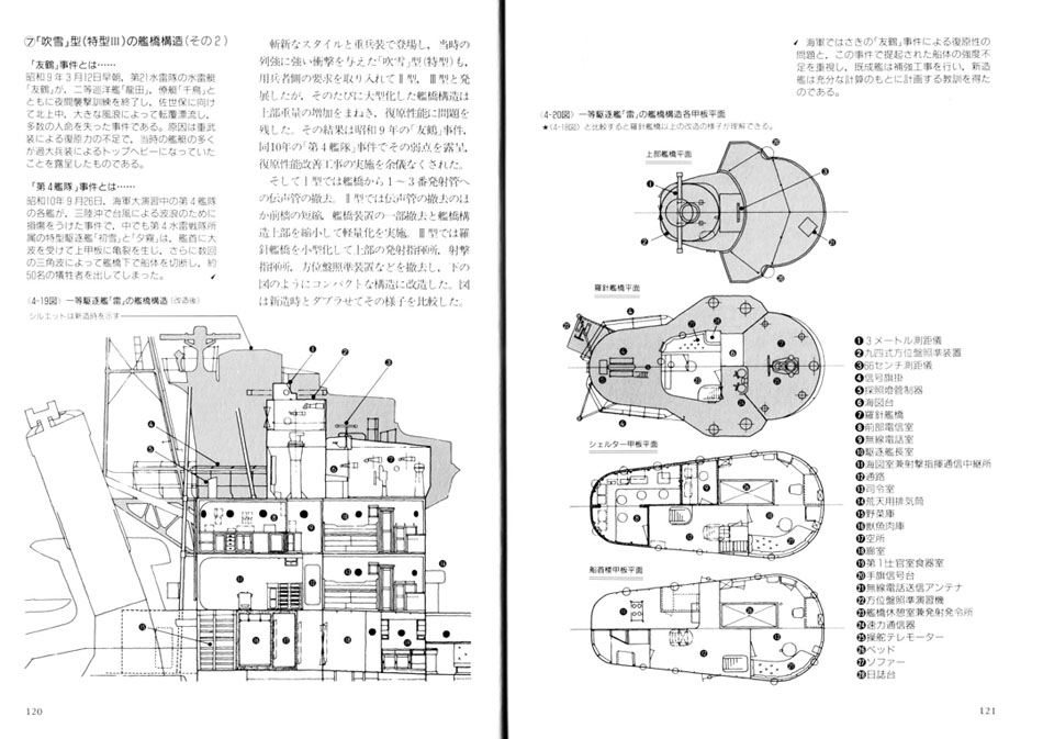

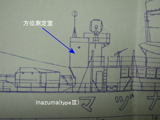

PostPosted: Fri Dec 14, 2012 12:44 pm
Posts: 8844
I'm actually surprised that FineMolds hasn't stretched it's line into the Type Is or IIIs as of yet. Seems so inevitable to me.

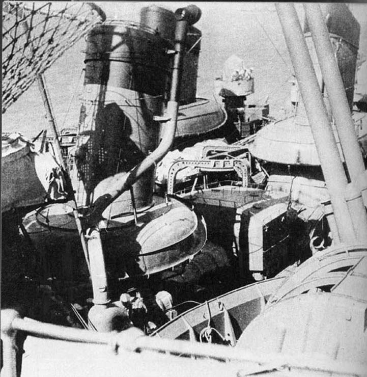

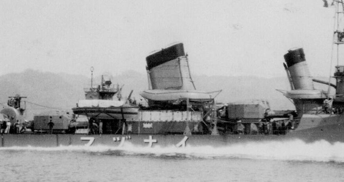

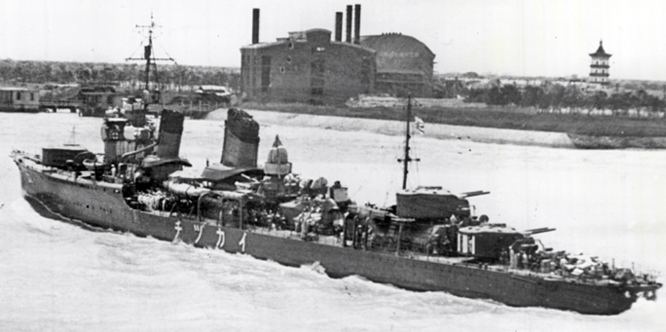

Sounds like a great project, Mike. OK, so what would it take to convert their current Ayanami/Shikanami kit into a Type III? Let see:
1) Bridge - yes , it can be done. Note, though, that the bridge base has to be extended back almost to the forecastle break (when viewed from above). I'll repost a shot that shows this aspect, as well as a nice Gran Prix Shuppan illustration that can help, along with a photo of Ikazuchi's bridge facing that is similar to the one of Hibiki.
2) Forefunnel - This will have to be completely fabricated as new. In cross-section, it will be completed round, which should simplify things, as is the lack of a rake to the funnel cap. Keep in mind that this funnel must be the same height as funnel #2 and that both funnels will be a little lower in height than those for Ayanami/Shikanami. Nice new photo below posted recently by Bill Somerville over on the J-ships board.
3) Air Intakes at the base of the funnels - These must be swept up in back instead of wrapping around straight across. Another view of Ikazuchi from astern below that shows this aspect nicely.
4) RDF compartment - the base between the front of this compartment and funnel #2 was lengthened slightly to make room for two 13mm mounts. You can make this out in the diagram and Inazuma cropping below.
I think it's all achievable. You might want to investigate using a 3D printer for the new parts. If it works, a conversion kit would be a nice offering. The new air intakes could also be used to modify the Ayanami/Shikanami kit into one of the Type II b ships - Akebono, Oboro, Sazanami or Ushio.
Please keep us apprised of your progress, Mike.

A correction - to make room aft of #2 funnel for the 13mm mounts, I think they moved the whole seachlight tower and RDF compartment back slightly.

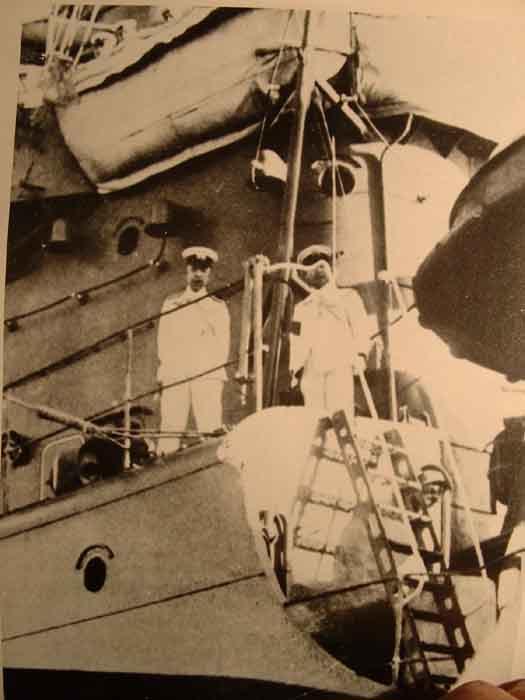

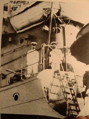

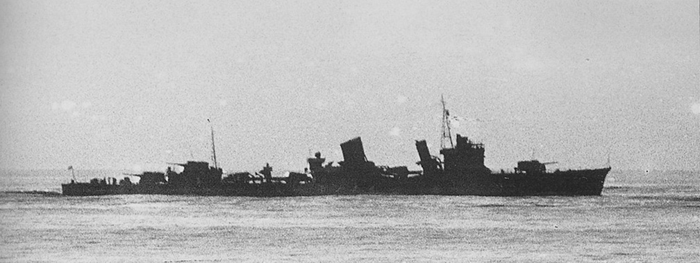

It looks like it will be a bit more complex than I thought. I found plan and profile views in Model Art #25 and did an overlay using drawings of Inazumi (Type III- 1936) and Sazanami (Type II- 1936). Apparently, the aft funnel and #1 torpedo tube mount were moved forward to make room for the 13mm gun platform (or because of the different machinery arrangement, or both). It also appears that the aft funnel was shortened between the line of the funnel cap and the second row of horizontal grab bars. It's a little difficult to see from the image because the waterlines of the different layers are not quite parallel.
This will change the footprint of the midship structures on the Fine Molds deck (same for the bridge), so it's going to take extra work to get the new parts to blend with the existing plastic parts. I suppose the only sure fire way to get Fine Molds to do one of the Akatsuki class is to go ahead and start scratch building. :roll_eyes:
PostPosted: Mon Dec 17, 2012 12:45 pm
Posts: 8844

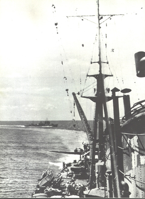

That's a very smart juxtaposition of images, Mike. I suppose the good news is that the FM kits have molded all the funnel housings and superimposed structures separately from the main deck. In looking over the instruction sheets, you'll have to alter the base of #1 funnel by cutting and shortening/reshaping parts D32/33, then moving the #1 TT mount up a bit. Then, adding an insert aft of funnel base #2 for parts D29/30 for the new AA positions.
Attached is a nice silhouette of Ikazuchi that helps outline this area. Also another close-up view of the proximity of the aft end of the bridge the #1 funnel (ignore the red outline - from another discussion).
