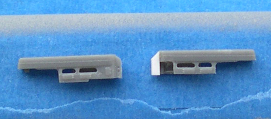

I apologize as I am still a bit confused on how to go about modifying the loading bays :oops:
I attached some additional pics to show my dilemma (moderators, please feel free to drop me a line if I'm over-posting my pics)
The first 2 pics below show the kit's port-side loading bay together with WEM's outer and inner PE frames that can be attached to it. The problem is attaching the inner frame would entail removal of the inside of the tt bay support.
Dry fitting the PE parts to the loading bay show's an even bigger problem.... ... at first I couldn't believe my eyes, but as seen below, the WEM parts are too big to be used for the kit :big_eyes:
For the inner portion, I think my best option is to just leave the inner structure/inside of the tt base support untouched.
For the outer portion, I'm contemplating on either opening up the kit provided plating or scratch-building a new one from card or styrene sheet using the WEM PE as templates :?
I'm a bit lost on these loading bays so any suggestions/ alternative options would be much appreciated :help_1: :please:
-Aldo

Your last, bottom two posted photos correctly depicts the area in question as well as the possible reconfiguration.
Re: the WEM PE part, I think Denstore has it right in that it's oversized becasue it was probably engineered for the slightly overscale Hasegawa version. You therefore have two choices: trim down the WEM piece (if brass, shouldn't be terrible) by removing the frames from the bottom or, forget the WEM PE and just trim the plastic.
If you go with the WEM option, I think you would be better served by not using the rear brace and just opening up the plastic guide on the left in the rear (forward most side). Don;t eliminate the entire guide.
If you go with trimming the plastic, then I would try to replicate the opening as I have done below with the 1/700 Fujimi Kagero bays as part of an experiment. The piece on the right. The advantage to sticking with the plastic is that you can also drill out lightening holes along the top, as in the Makinami photo.

PostPosted: Wed Dec 05, 2012 4:49 pm
Posts: 8835
Well, there are two access hatches down there so, I wouldn't open those two holes too far south.
It turns out that only a handful of all the Kageros and Yugumos have the openings in the center; most sisters have solid sided compartments in that place. Here are two views that may be helpful.
