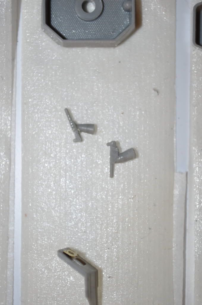

One tip I can pass on. As anybody who has built Buckley can attest, the mounts for the 20mm A.A. guns are, shall we say, rudimentary. I was fiddling around, trying to come up with a better presentation when I hit on an idea that has worked out pretty well. I took a length of sprue and chucked it into my Dremel tool's little hand held extension tip. Turning the Dremel on the lowest RPMs I wet sanded and then used an X-Acto knife with a chisel tip to form a solid, conical looking base for the 20mms. I have to say, they turned out pretty well. I then cut the molded on base off the guns and sanded a flat spot on the top of the turned bases to let me mount the guns in whatever position I wanted. I did most of them in an elevated position, like they would be found when not in action. I'm pleased with the result. Definitely looks better than the straight kit gun. Again, I'll try to post some photos as soon as I find that darned charger!

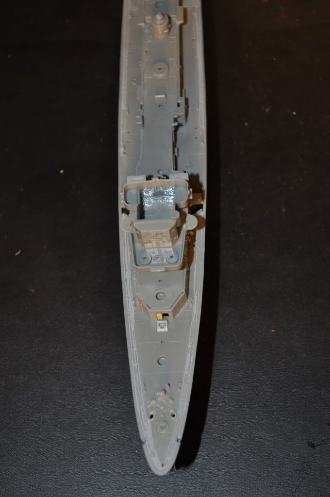

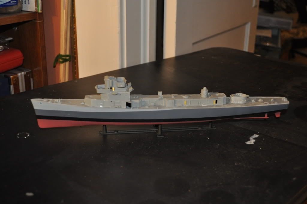

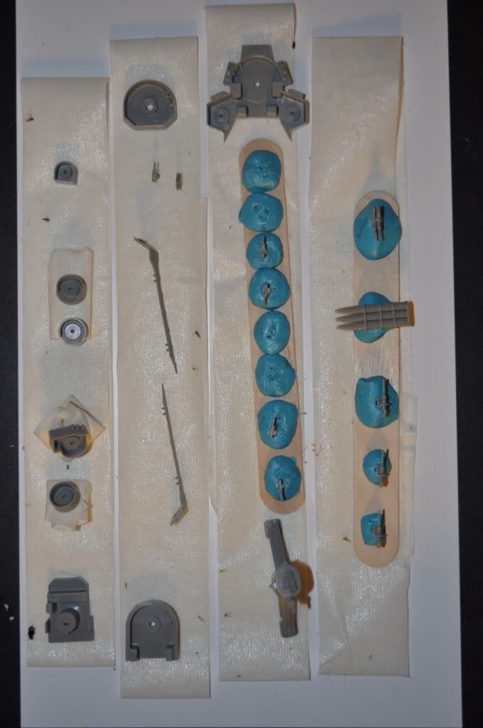

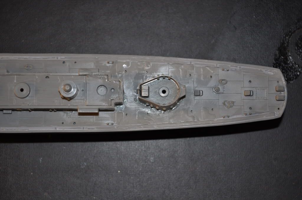

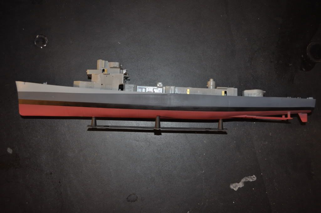

PostPosted: Wed Aug 10, 2011 3:33 pm
Posts: 2025
John, she's looking good. You're going to have a model you can be proud of.
I don't want to hijack anybody's thread, but I thought I'd throw in a few pics of my Buckley in progress. Hull is painted and I've got the deck and some of the superstructure attached. Need to paint the verticle surfaces, then once that has fully dried, masks and paint the decks. I'm using the GMM PE set for her, so I've ground off the ready lockers for the K-Gun depth charges. Also removed the molded on stantions. Comments are most welcome.
This will give you a little better idea of what I've done to try to dress up the 20 mm A.A. guns. I know they aren't perfect, but I think they look better than stock kit.
Finally, various parts of the superstructure, etc, awaiting painting.
Thanks for looking,
Bob

Bob---hijack away!!!! I did LOL. Looks like your off
to an excellent start. I am going to add another one
to the stash and after I move and resettle do her up
right! Keep the pictures coming, I need ideas! Are
you doing the sonar dome? I have some good information
if needed.---John
