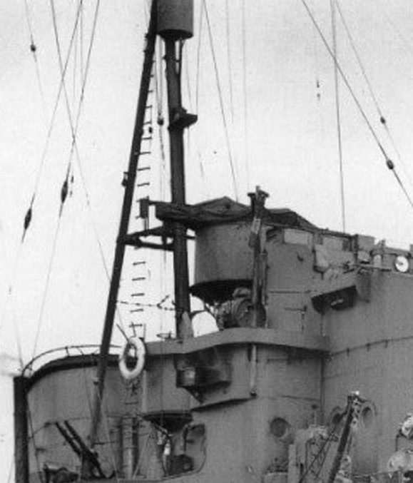

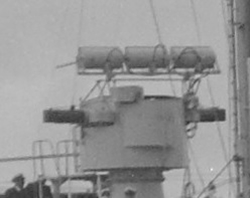

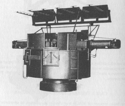

True what you say Jamie, not absolutely sure on the Canadians, but RN and RAN were fitted with MK III, the Canadians look a little different in director enclosure shape so you may need a bit more reference. More than likely MK III.
The 285 array appeared later half of 41.
I can tell you that RAN Arunta and Warramunga were as built, fitted with early 285 which had 2 double element reflectors and a single element reflector in the centre, they were later fitted in 44 with 3 doubles.
Each antenna rod was fitted with 7 elements, also hard to identify is the MK III had stabilizer boxes fitted in front and also behind the prism tube.
I am fairly confident the IWM photo is a MK III.

PostPosted: Sun Sep 17, 2017 6:15 pm
Posts: 345
To clarify, forgot to add in previous post.
The early 285 Yagi array, each reflector was fitted with 4 very thin stabilizer rods terminating in a collar fitted around the element rod.
Later arrays did not have these stabilizers, they are very hard to see, can just be distinguished on the previous Arunta attachment.
