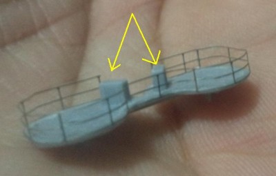

First question: on the Tamiya kit, there appears to be a solid railing (splinter shields?) on the search light platform aft of funnel number 2, and on the gun director platform forward of the aft torpedo storage (see below):
Are these correct or should they only have 2-bar railings similar to the AA gun platforms?

PostPosted: Thu Nov 28, 2013 10:26 am
Posts: 8837
As you have surmised, both platforms are surrounded by railings that are sometimes covered by canvas (hence, the solid representation). The torpedo davit is as you have circled it, aft the starboard 7.5m launch, next to the tip of the #2 TT mount.

Thank you so much for sharing that picture Dan, this confirms the 2-bar railings on the platforms I mentioned, as well as the davit on the starboard side of #2 TT mount, as depicted in the Tamiya kit :smallsmile:

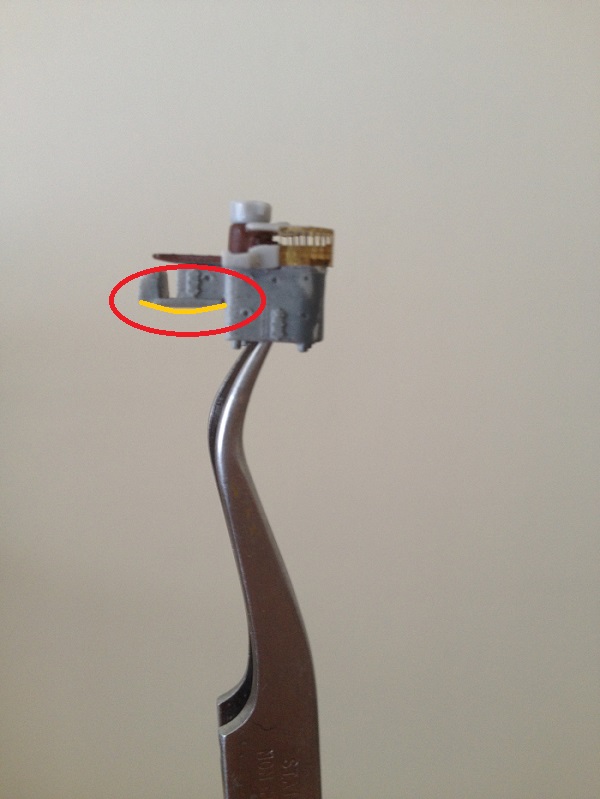

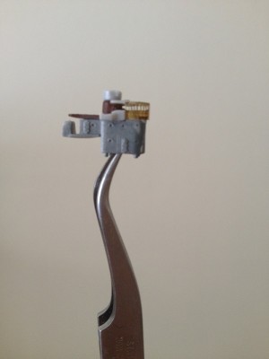

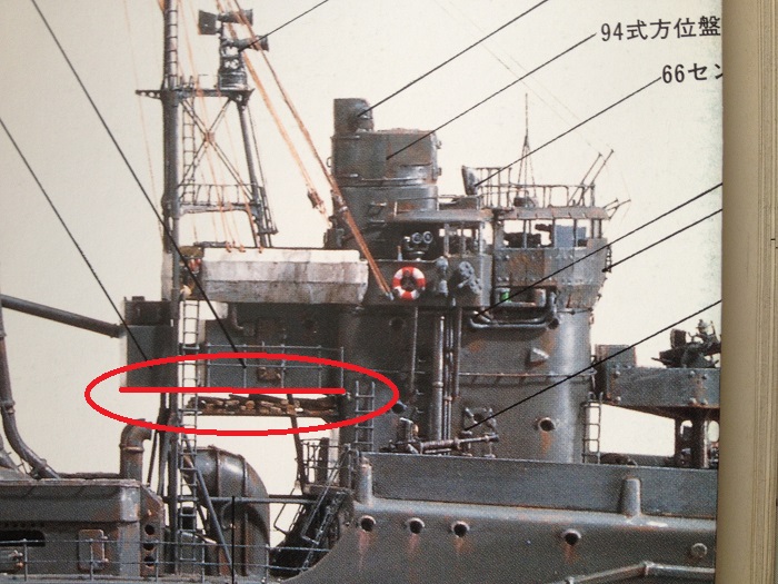

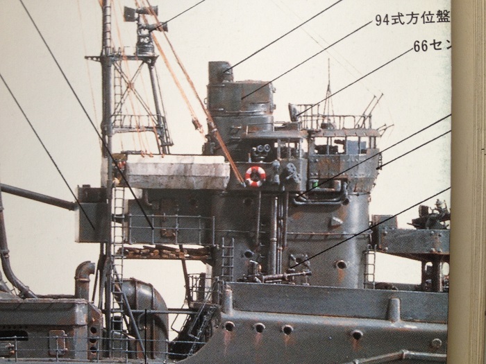

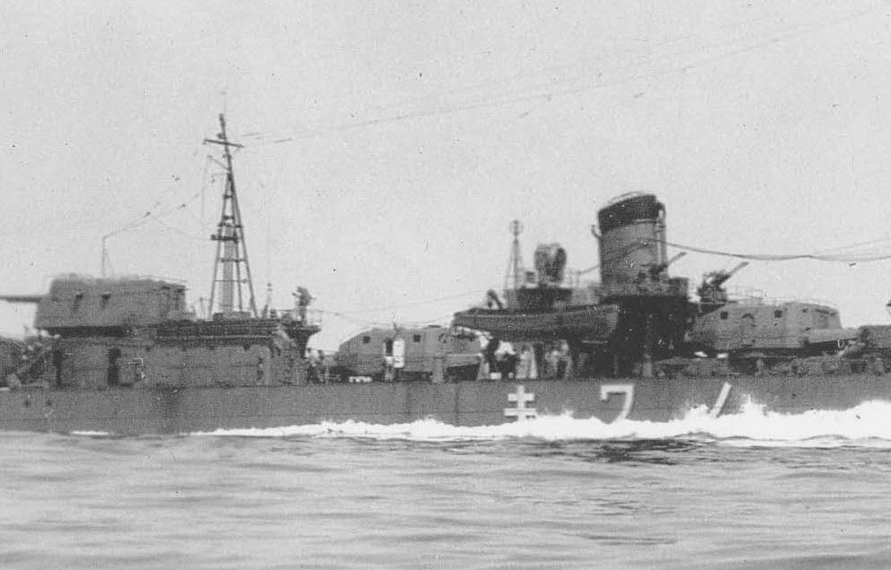

Hi Guys!! Question.. while looking at the Fujimi kit, prepping it to be worked on. I noticed that the bottom of the back side of the kogero's bridge were slightly different in that the kit bows downward and in the Gakken books its strait.. which is right?
PostPosted: Tue Jan 21, 2014 1:23 pm
Posts: 8837
Well, if you had to choose one..........
