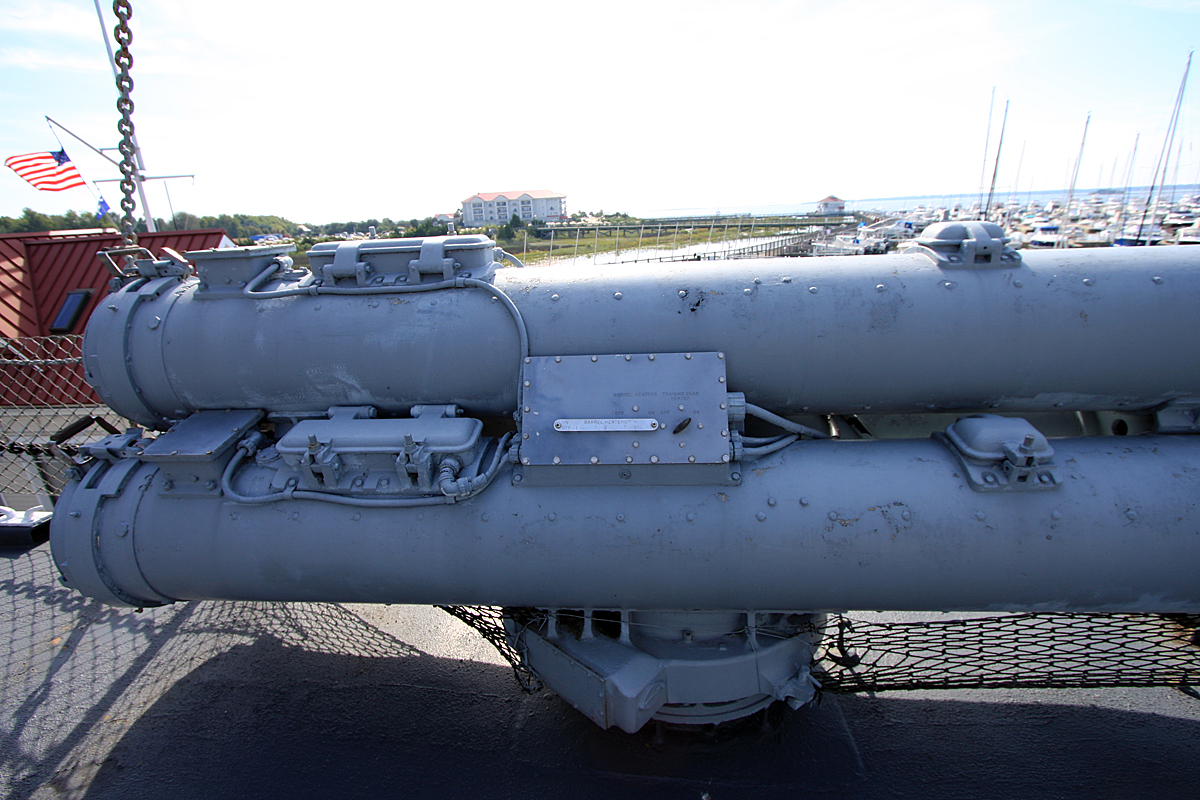

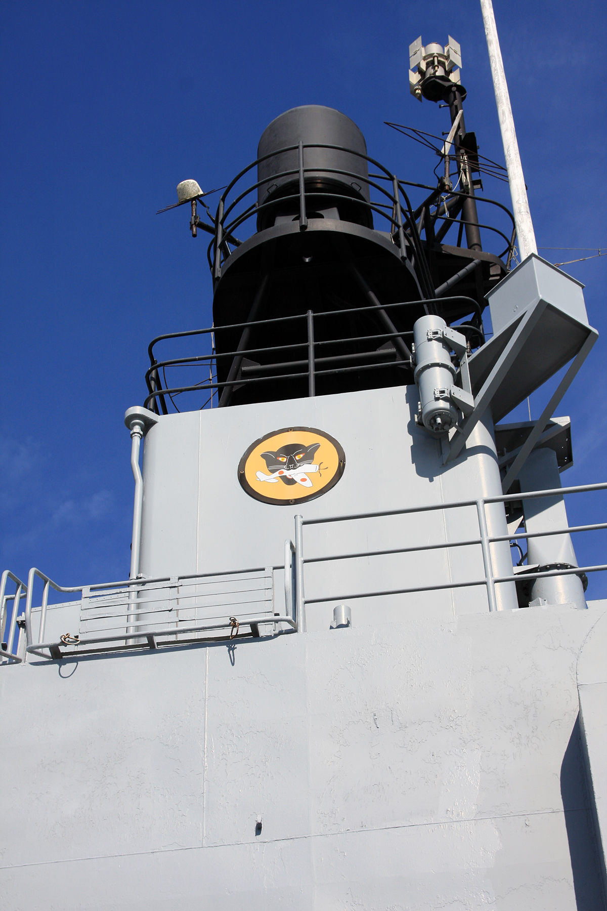

I have quite a few detail photos I shot of equipment and weapons on USS Laffey (museum ship in Charleston, S.C.). I'm happy to search through my collection for specific requests.

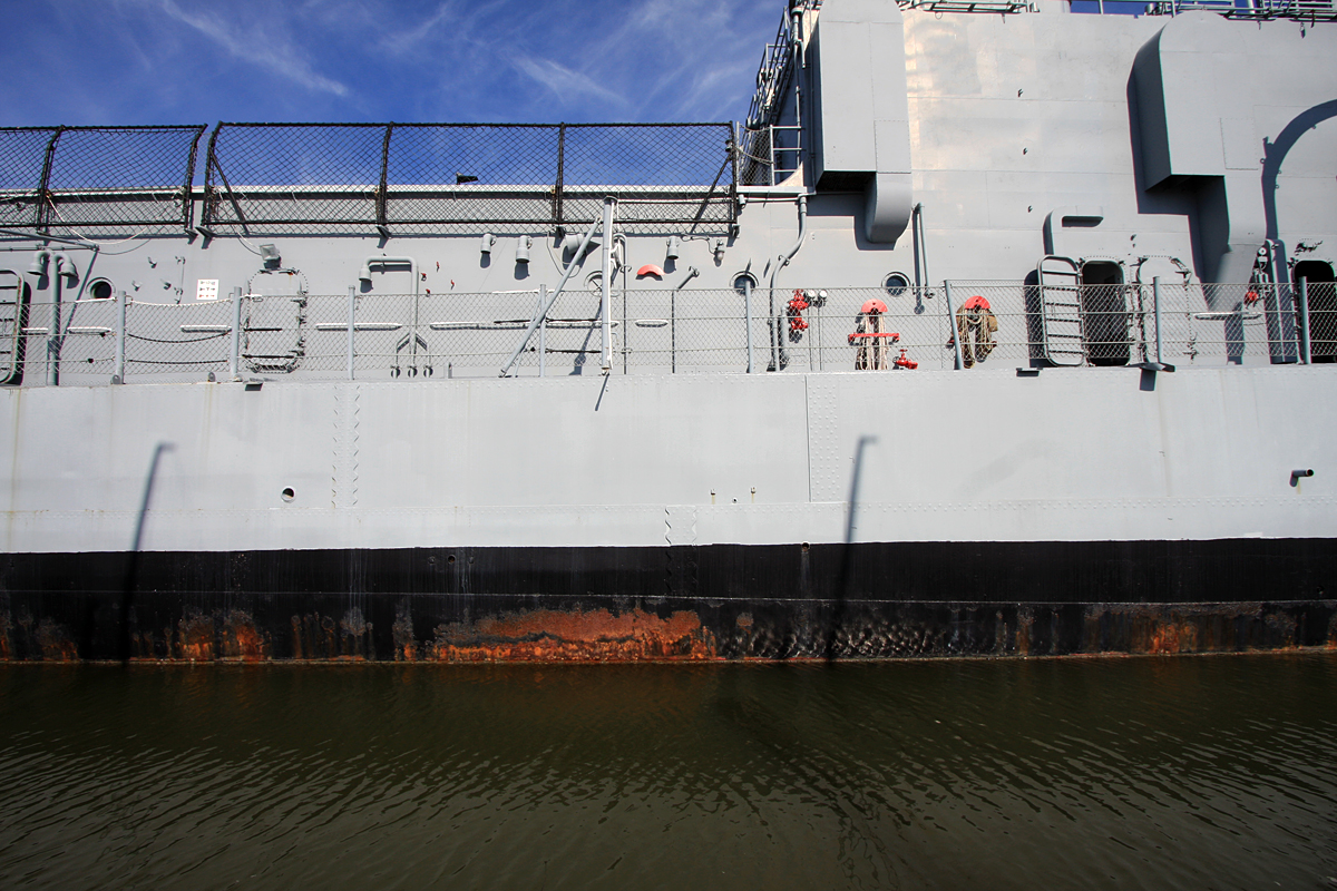

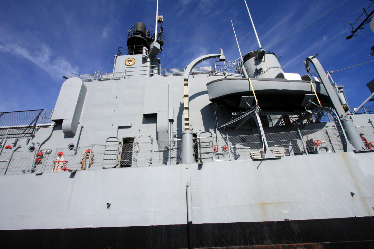

PostPosted: Tue Aug 27, 2013 9:57 am
Joined: Tue Jul 10, 2012 2:56 pm
Posts: 78

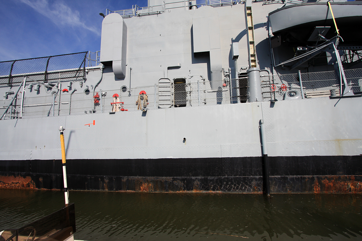

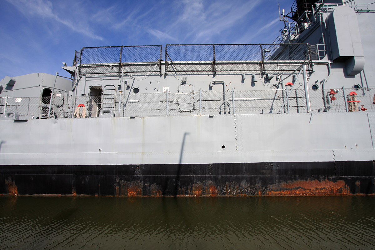

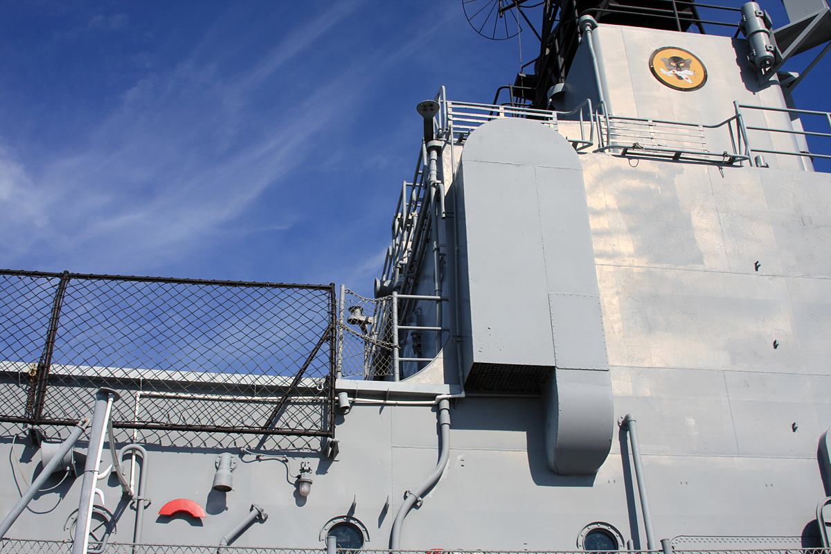

Hi Mike,
Unfortunately, the hangar area was off-limits when I was there, due to refurbishment work. I have a few external shots taken of that area from the dock, if they will help.
Rob

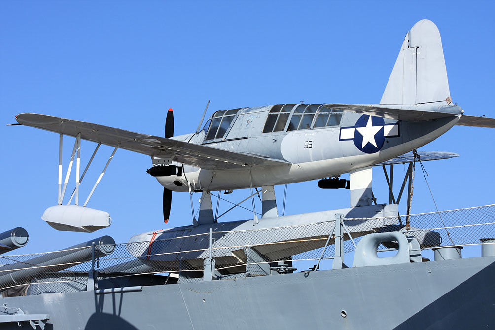

That is not to say that a museum ship isn't valuable, from a model builder's perspective, but one has to pick and choose the areas of interest. For example, there are only 9 OS2U Kingfishers left in the world, and one of them is sitting on the stern of the North Carolina. Of course, it's out-of-place, sitting on the deck, because the catapults are long-gone.
