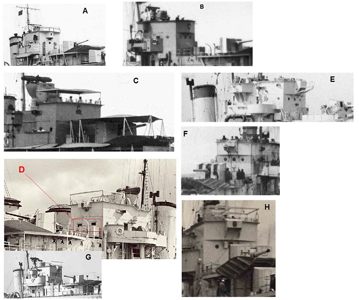

The C and D classes each had different bridge configurations than the E&Fs, as well as distinct from all others. This was especially true for the Cs, which featured separate director and bridge structures, with a gap between. The Ds also had a distinctive wheelhouse window arrangement. Other differences can be found in each class' "wing platforms" and deck extensions, support frames, and locations.
While it is best to research each of the earlier classes for details, I did put together a collage of the various groups' bridges, a few years ago. I have included it with this post. I hope it proves useful, but please bear in mind that my intent was to highlight the different features for the purpose of helping to identify "mystery ships" and/ or uncaptioned photographs---not modeling requirements.
Still, it should give you an idea how they differed from the E&Fs. Also noteworthy is that the "leaders" of some RN destroyer classes were noticeably different from their flotilla "regulars", so modeling those specific ships may require further and more significant modifications (fifth 4.7" gun mountings between the funnels, for example).
Dan

Thank you for your very informative post and the bridge collage. I guess there goes my plan to model HMCS Chaudière or any other Canadian River class destroyer that was drawn from the C or D classes.
The River class was the name the RCN gave to all the former RN destroyers from the A through H class destroyers transferred to its command and given new names while in Canadian service.
For example the HMS Express (H61) was renamed as HMCS Gatineau.
Sadly, after a distinguished wartime career with the RCN and her subsequent postwar decommissioning, HMCS Gatineau's hull ended up as a floating breakwater in Royston, British Columbia, where she remains today. If she had been preserved with her superstructure, she would have been the last survivor of the ill-fated Force Z with HMS Prince Wales and HMS Repulse from December 1941.
Dan

Upon looking at various online articles about the C and D class destroyers, while comparing them to the E and F class, it seems the former was not that different from the latter.
Both had the same length at 329 feet. In spite of the collage you posted, I would insist that the main difference I observed among both groups of classes, other than the differences in AA suite, was the C & D classes had two portholes on their bridge/wheelhouse, while the E and F classes had 3 portholes.
The bridges of the D, E and F are pretty much identical save for the differences in portholes. The C class is slightly different because of the small overhang above the portholes, but one can simply modify the corresponding part on the Tamiya E class kit to rectify that small difference.
Other than that, the bridge superstructures of all 4 classes were pretty much identical from what I can see.
This is after searching through pics of many class members in all 4 classes that had been transferred to the RCN.
Just thinking that I really can use Tamiya's E class kit not only to model the identical F class DDs, but C and D class destroyers as well.
To model the C class and D using the Tamiya's E class kit, one would have to replace part G23 from the kit's instructions. That part has the bridge wheelhouse front with the 3 portholes. If one can scratchbuild their own part which has 2 portholes, then you're home free to make any of the C and D class destroyers.
*On a sidenote, the G and H class destroyers' bridge/wheelhouse were identical to the preceding E and F class since they also had 3 portholes, but they were smaller at 323 feet. If you wanted to make any G and H class destroyer from the Tamiya E class kit, you'd have to shorten the hull somehow.
Dan

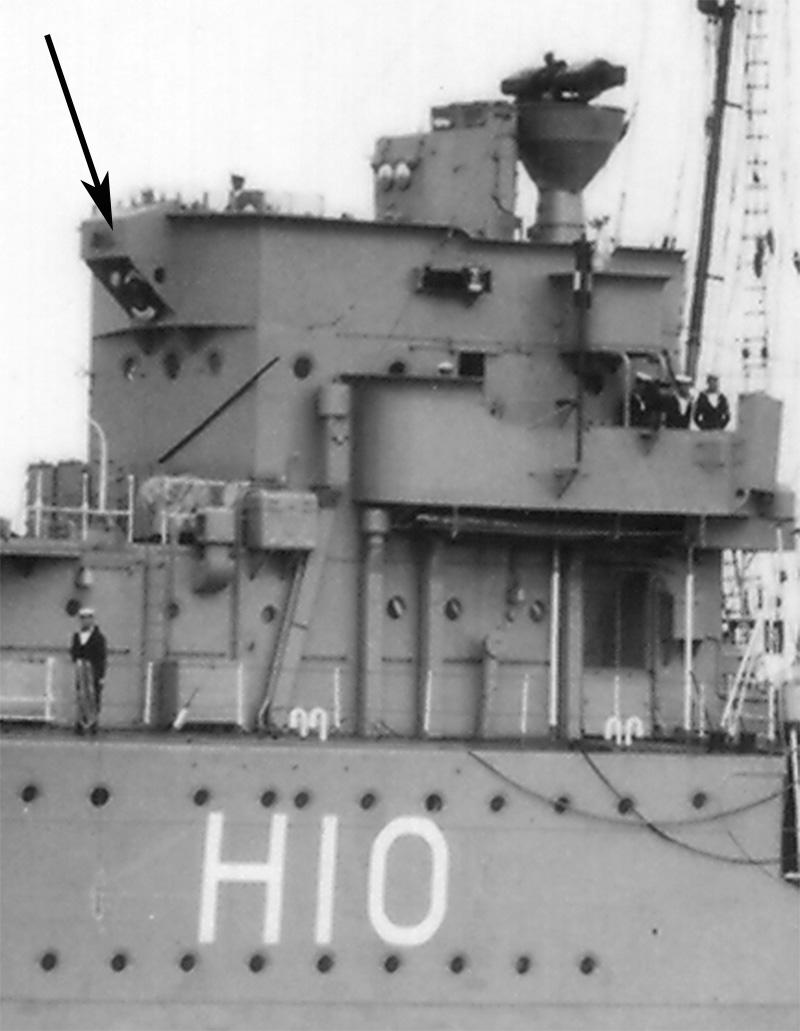

PostPosted: Tue Dec 13, 2022 1:26 am
Posts: 470
Gents,
I wonder if someone could tell me what is either under or inside this 'enclosure' (black arrow) in front of Encounter's open bridge?
TIA!
PostPosted: Tue Dec 13, 2022 4:04 am
Joined: Mon Jan 04, 2021 11:52 am
Posts: 184
Chart table?
81542
PostPosted: Wed Dec 14, 2022 10:11 am
Joined: Tue Jun 16, 2009 1:49 pm
Posts: 255
Looks like a Carley float in the enclosure underneath, with a rather heavy fitting. The box above will include the chart table, if that's what it is (seems likely).
