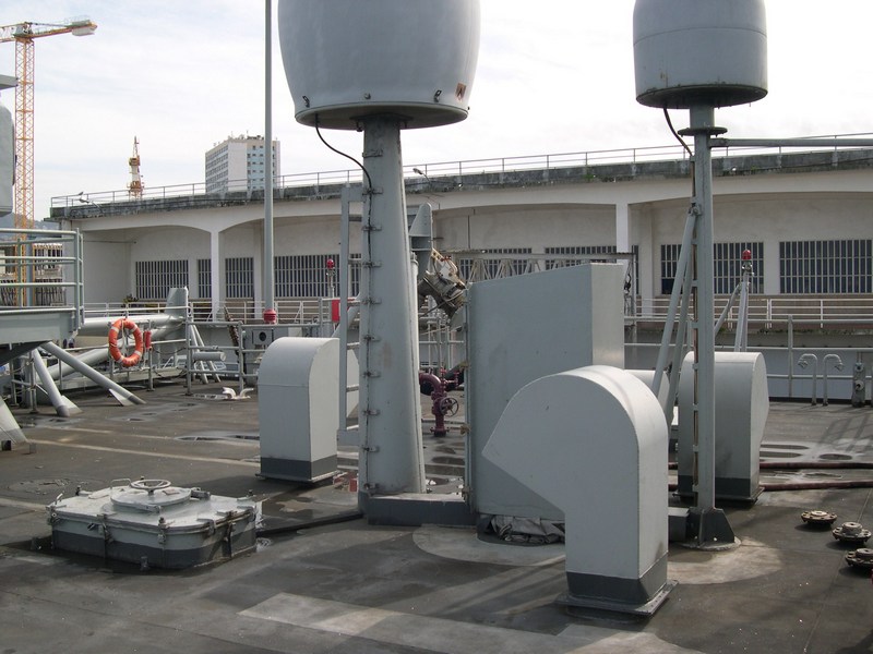

Hi there :

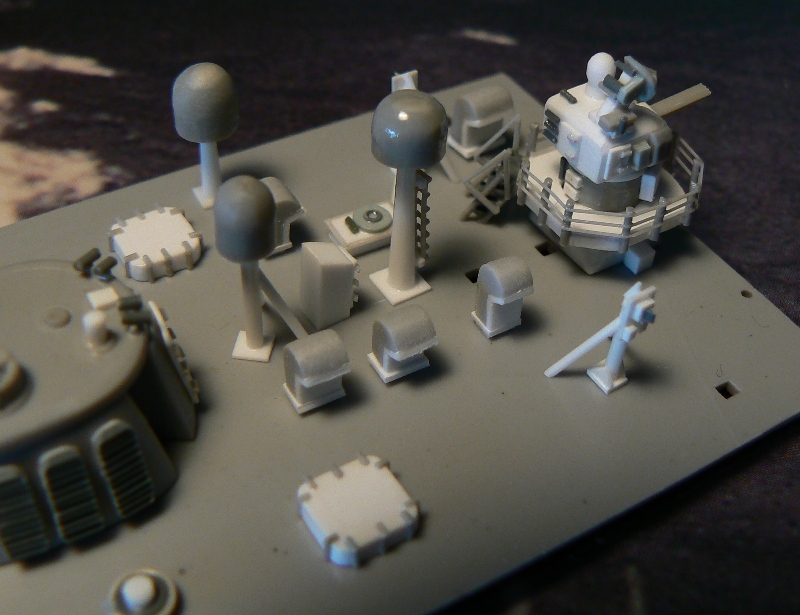

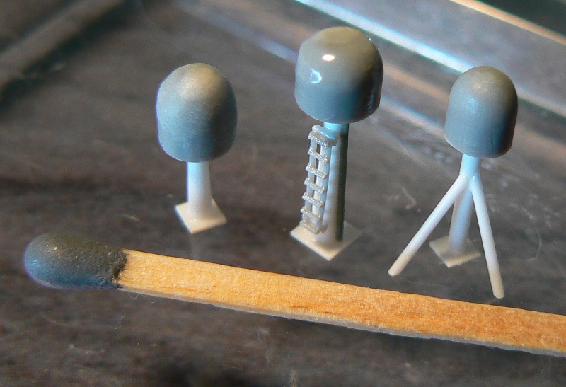

I was working this week on the aerials, vent trunks and some other equipment aft.
As for info, I had to cross some pics that more or less cover the whole area :
According to it, these are the solutions that I made.

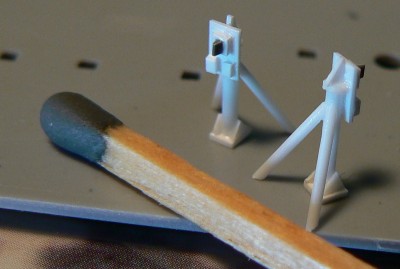

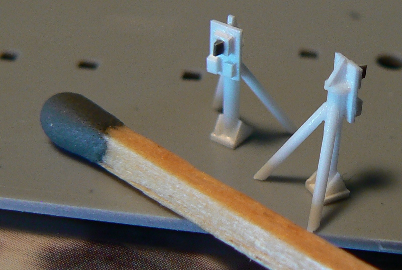

Aerials and sensors, made with a piece of sprue, carved with file, and smoothed with sandpaper -- and some patience :

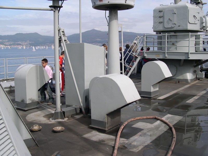

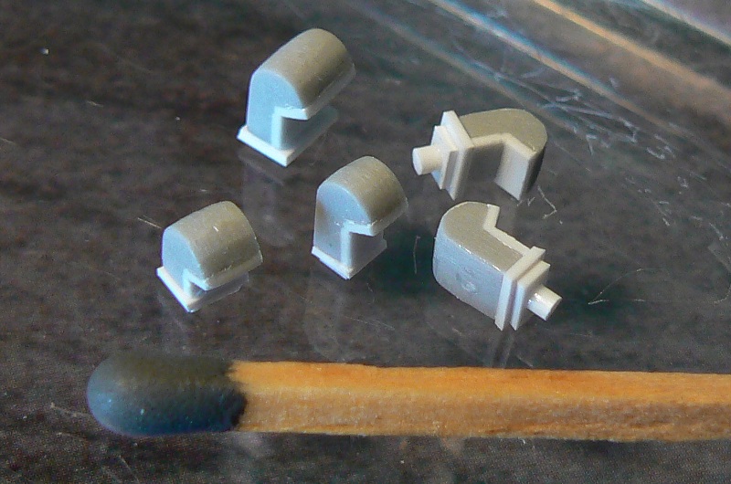

The ventilation trunks were correct in shape but too thin, so I had to thicken them using Evergreen strip, and adding the bases afterwards :
Refueling poles :
One of the aerials was a bit more complicated because of the conical base, and required special attention, but it came out at last, more or less :
So this is the present appearance of the aft-upper deck at the moment :

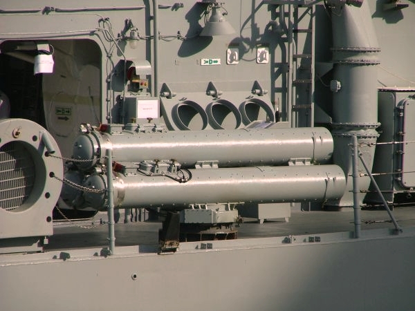

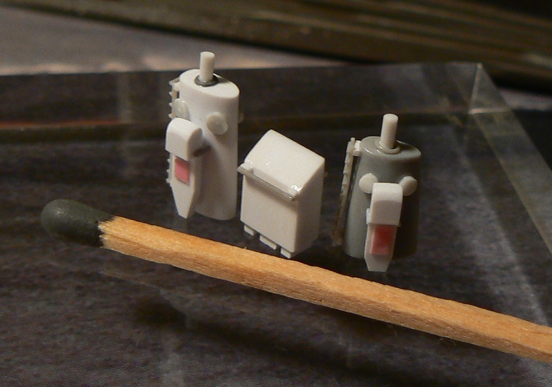

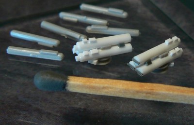

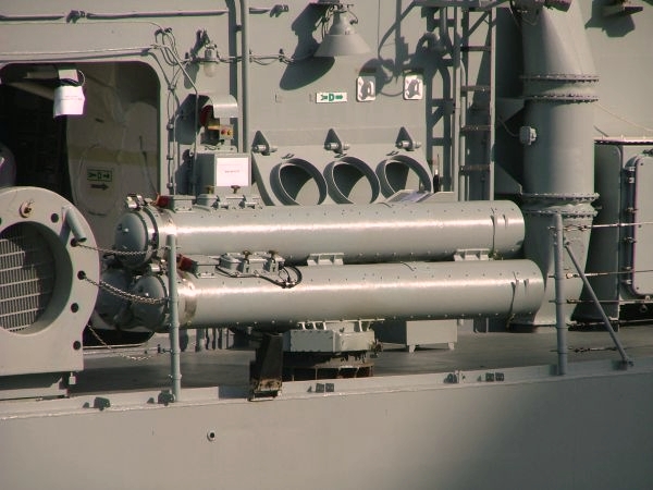

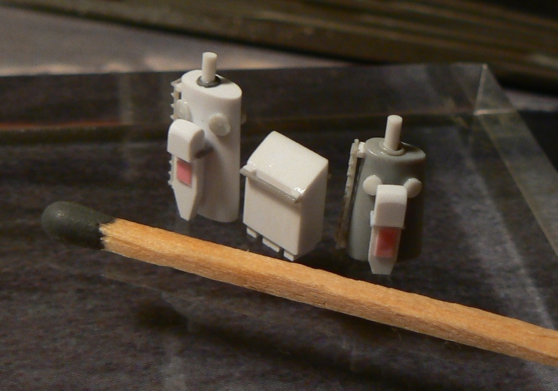

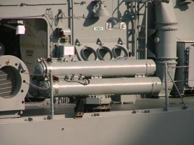

The last of today, the mk.32 TT, which are like this :
The tubes that were issued in the box were not too good, and after the sanding they would be far too thin, so I had to scratch-build them with Evergreen rod and stretched sprue. Very easy to build.

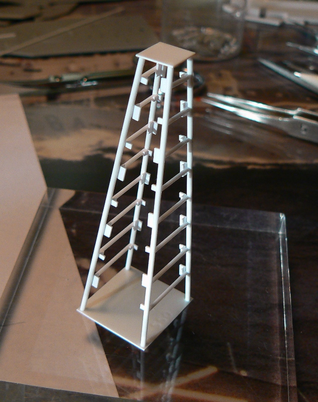

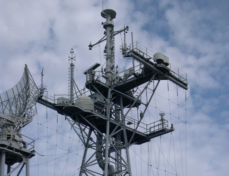

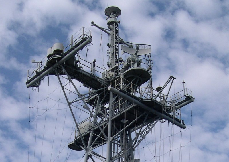

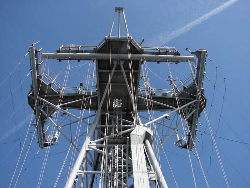

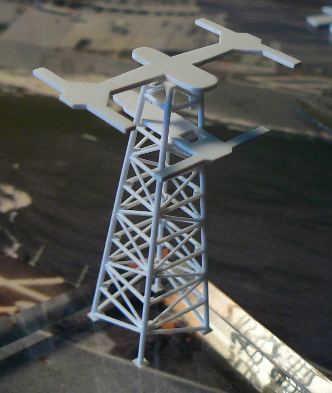

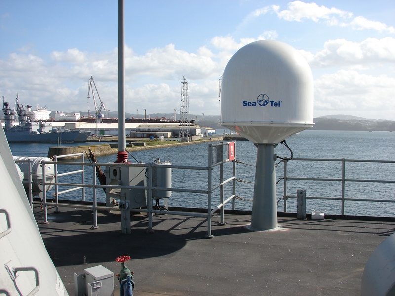

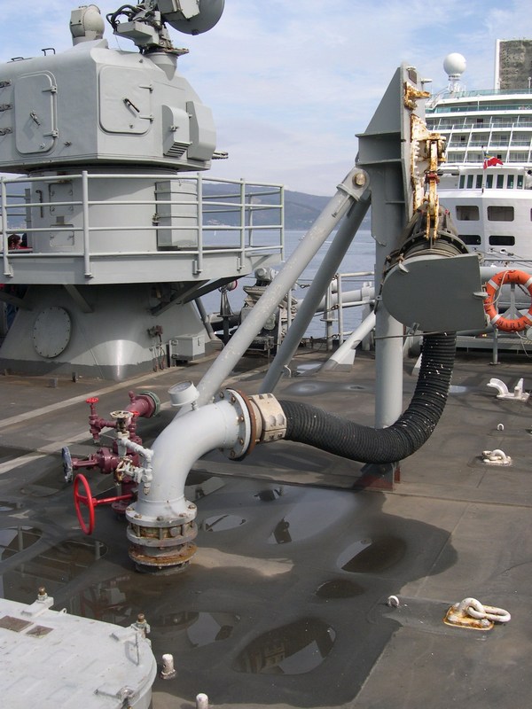

Hi Nuke and all,
No, nothing is stopped, actually I have been building the main mast, but with little time to post the progress.

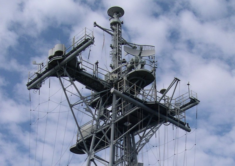

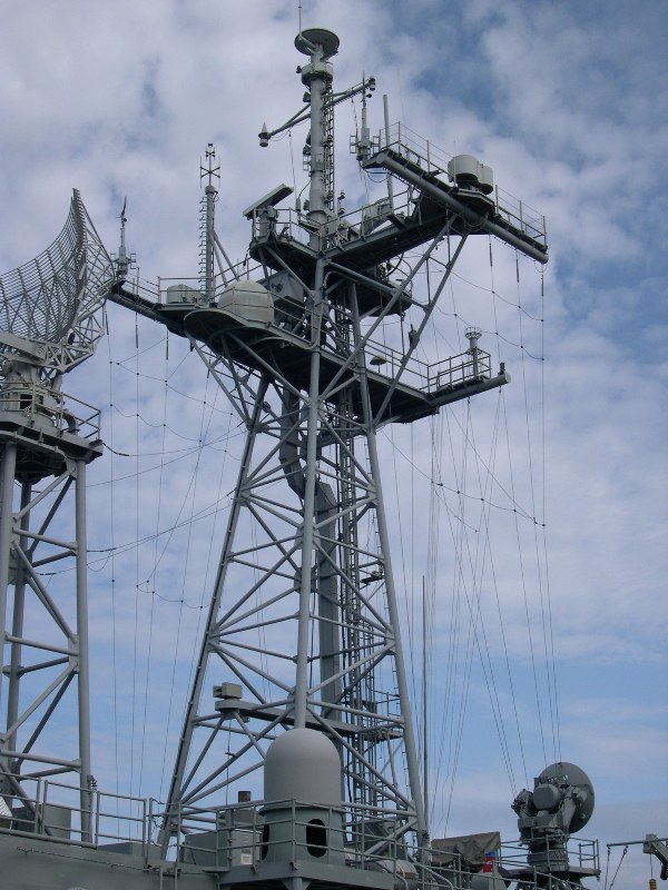

Two weeks ago, the frigate F86 Canarias, sister to my Santa Maria was visiting our port in Vigo, and I could visit her. As I was making my visit with a modeler´s eye, among other little details I could notice that the auxiliary stack is some how higher than the flag boxes besides, and not levelled with them as is the case of the Lee stack that was in the kit, and that I used as a base. So I decided to scratch-build another one, good from the beginning, and with the correct profile.
Afterwards I started the main mast, which is like this :

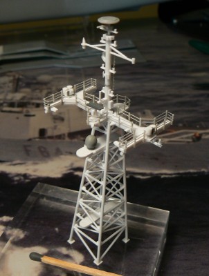

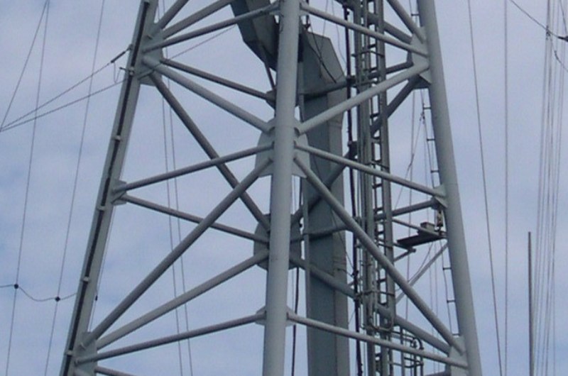

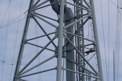

All masts that come OOB are far too short, and the main mast lacks a cross section as well, so they have to be scratch -built from zero.
The necessary measures were obtained from the profile pic that opens my part in the thread, knowing that the overall length is 138.10 m. Actually, I found out that Lee´s mast is more than 1 cm. short at 1/300.

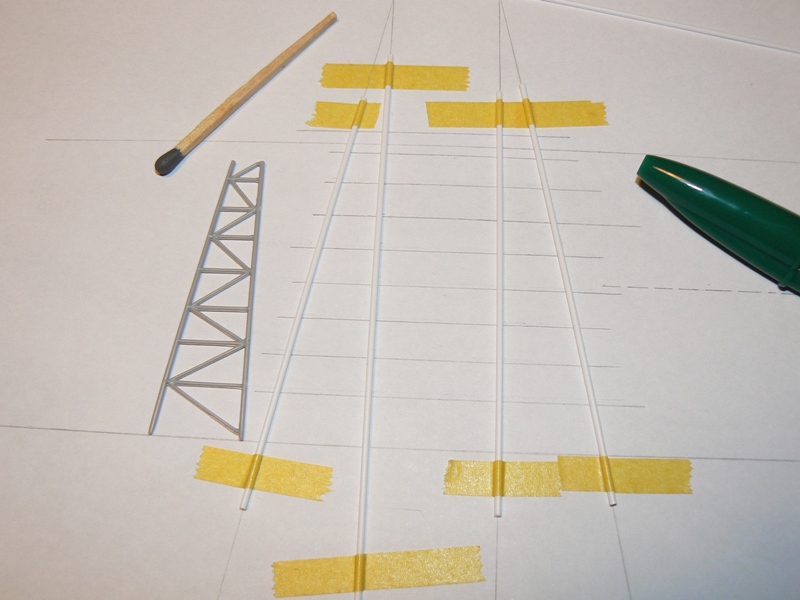

The next steps are easy : to draw the profile on a paper, with very thin lines, to place the vertical rods with tape, making sure that they are placed exactly on the lines.

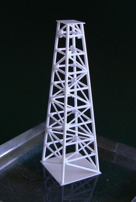

Then it is necessary to cut the horizontal bars, making sure they are exactly the length needed, so that the rod does not bend.
Now it is necessary to let it dry a whole day, so that the rods are firmly fixed.

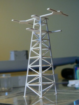

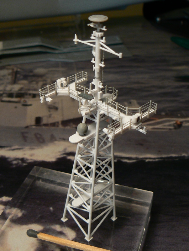

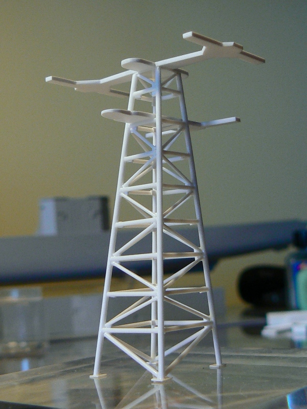

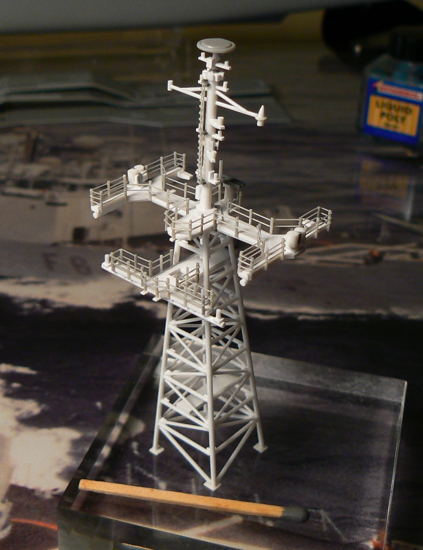

Once the sides are dry, I added the supports for the horizontal and oblique bars, and the base and top of the main structure. The base is only provisional, and will be removed later. Both base and top are made with pic-nic glass bottoms, the ones you can find in a Dollar City for $1.

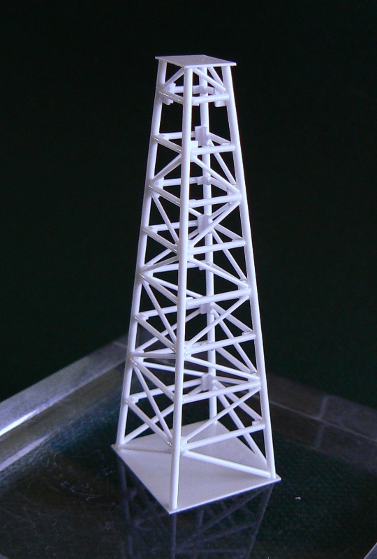

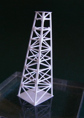

Once this is dry as well, we can add the rest of the bars. They are not the same caliber, as can be observed in a high res, pic.
I have made them with Evergreen rod, 1.2, 0.88 and 0.64 mm. I have inverted the position of the 0.88 and 0.64 so that the structure is a bit tougher, as it will be very manipulated when painting and adding details. As it can be seen in the pic, the horizontal bars do not go exactly from side to side, and it makes the work much easier.
I hope you like it, and very best regards,

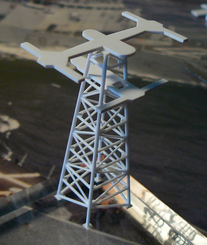

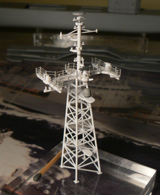

The next step are the platforms for the aerials and other equipment. They had to be done from scratch, as the pieces OOB were ad good as nothing. I think that the problem with this Lee model is that the hull and main structure are 1/300, and all details and equipment are 1/350 !!!! Not a very good kit, to put it politely... :dry:
The upper platform is made with 12 pieces. The cuts should be done very carefully, so that the structure remains flat. The lower platform ( 4 pieces ) is much easier, and the scuttle for teh scale was made with a file.
A dock view, as in the big pic of the mast in the other post :
I hope you like it, and very best regards to you all,
Willie.

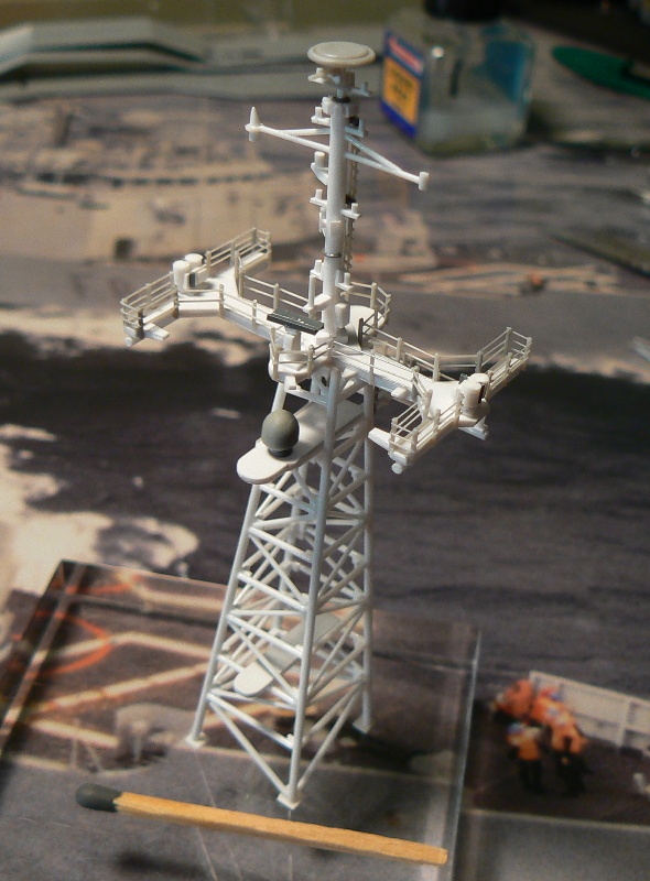

And here is what I have done at the moment :
The equipment is already 50% complete, but some tiny details will have to wait until the very end of the construction, so that they do not break in the process. The cable handrails were a headache, because they are made with stretched sprue, and are so thin that they break easily with the excess of glue that has to be applied.
