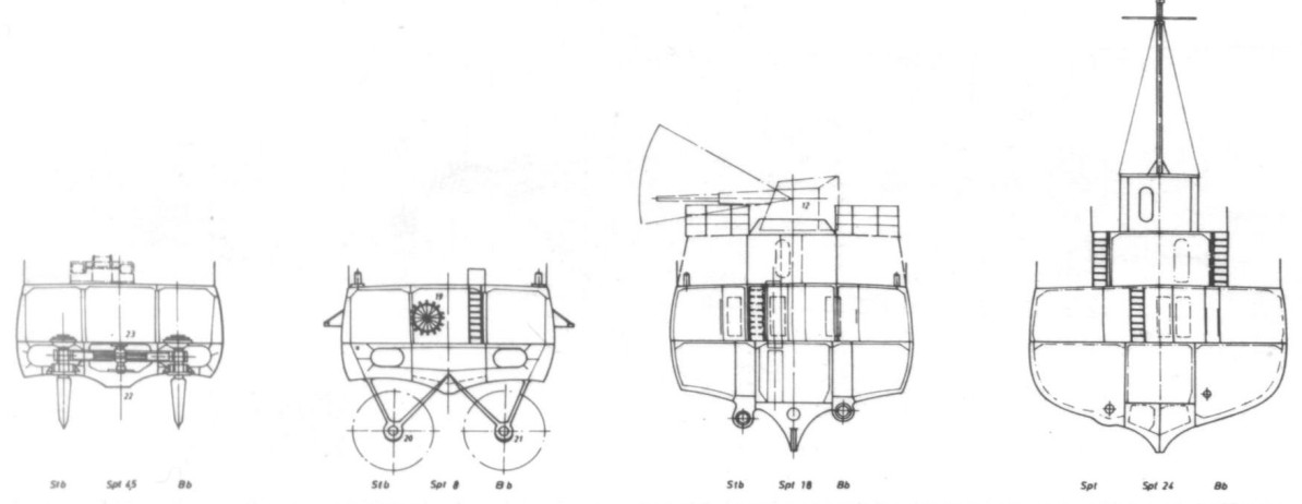

may be this plan of z36a can help
ciao peppe

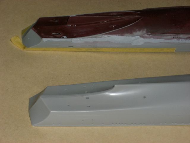

PostPosted: Mon Jul 04, 2011 6:15 am
Joined: Thu Jun 30, 2011 6:40 am
Posts: 16
Location: China
Hi Peppe
Thanks for your reply. I already thought everybody is doing waterline models now and nobody interested in the rest of the ships any more :smallsmile:
I have seen before the cross-sections you so friendly attached. I just think that the hull-form is not clearly defined by the these cross-sections alone and I never saw a complete set of lines of these destroyer.
To make it more clear I attach a photo. The red hull (the dragon) has very sharp "knuckle" where the bottom and sides transit into the rudder and propeller area (you can see the sanding lines). Compare this with the round shapes of the grey trumpeter hull. The dragon hull look more like riverboat, not like very fast and sophisticated destroyer..
I tend to think of a misinterpretation of the line drawings (maybe they had only the cross-sections!), something like what happened to Hasegawas "Nagato" a few years ago.
But before I start to reshape the hull I wanted to be sure and asked for further info or photos

Tracy, I think he means this post (there's a pic attached in the original - just a few posts above on this page):
Shanghaied wrote:
Hi Peppe
