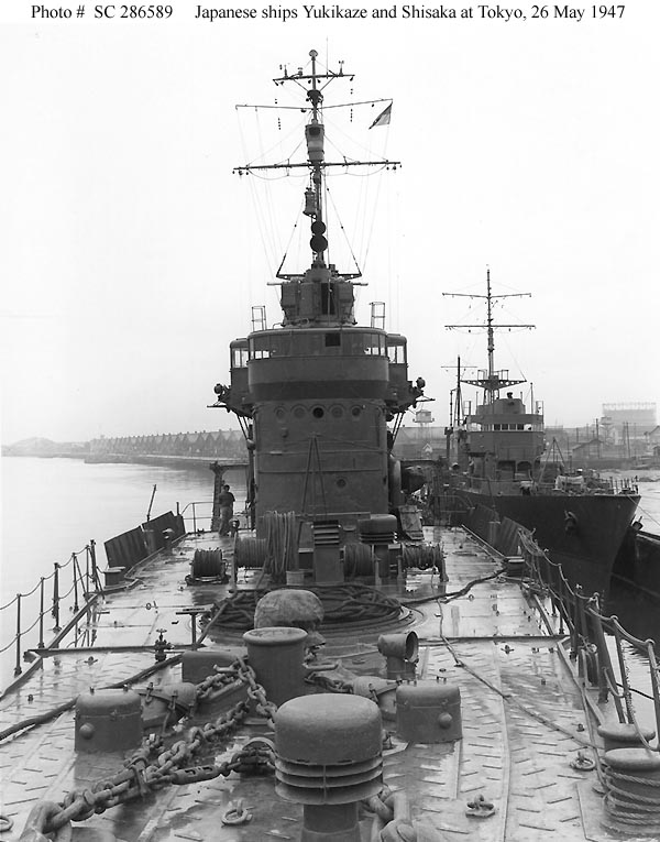

Ok, main deck linoleum remains on all IJN ships throughout the war, stripped only from interior spaces. See Yukikaze postwar photo below, either side of mount #1 siting. And, yes, the Fujimi kit has the tie-downs.
Same photo vs new Fujimi kit, which incorrectly has molded the turret deck bases. Not that you'll see it with the turret on top.
I have not built it but I have it, obviously. I agree that the detail molding is not always sharp. In fact, it's inconsistent. Compare the excellent aft deck house assembly vs the bridge assembly. It's as if from two different kits.

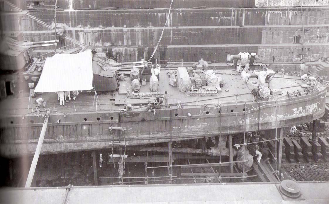

Attached is one of the previously mentioned photos of Shiranui in drydock after losing her entire bow to a torpedo. If you look to the right, down under the paravanes, you'll see the propeller guard. It's a very simple strut affair.
Note that the rear turrets do not carry stiffeners, only handrails along the sides

Thanks very much Dan! That is a great photo! I will try to replicate the propeller guard from wires.

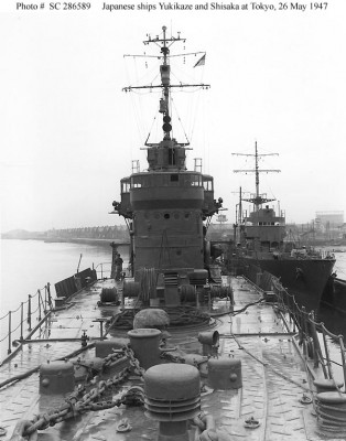

Assuming you are talking about the plates seen below on sister Isokaze's bridge in Oct.'44 (ignore the red arrow - points to passive radar detector), then know that the IJN attached metal plating for extra splinter protection to the bridge of most of its DDs. This practice dates from their time in China in the late 1930s, though it may not have been uniformly applied at the outset of WWII.
Clearly no need for it postwar - harder to maintain.

Yes that is what i was talking about Thank so much Dan K i had know idea that those were added in 44!!!
