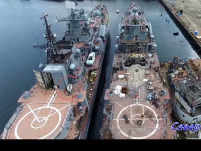

Dear all,
Attached you can find the pictures of 2 Sovremenny under demolition (screenshot from a video I found). I encircled in red an object that I do not understand what it can be. Can anyone help me? I haven’t found any other image of it, neither in operation nor under demolition. It seems something folded or maybe not. If anyone has any idea, they are welcommed.

The answer in another fora was that this could be one of the 600 kW diesel generators:
https://www.forum-marinearchiv.de/smf/index.php/topic,38904.0.html
Do you know which ships these are and when they were photographed?

There at this forum, they also identified the two ships: Bezuderzhnyy (Безудержный, 406) and Gremyashchiy (Гремящий, 404) in Severomorsk in 2018.
Probably the source for the photo:
https://www.youtube.com/watch?v=_SMIvHumrYY

Dear Maxim,
Really really thanks. I had seen the first video (from which i had taken the screen shot), but the second video is better, since it allows different points of view. The video captured my attention more than one year ago, but the modelling time is very little and therefore only now i came to try to replicate that strange object, that was identified as, possibly, a diesel 600 kw engine. Please thank the german people of the other forum for their kind, quick and proactive reply. Indeed the replica of that device is challenging, since any enlarged picture gives very temptative borders to its shape.
