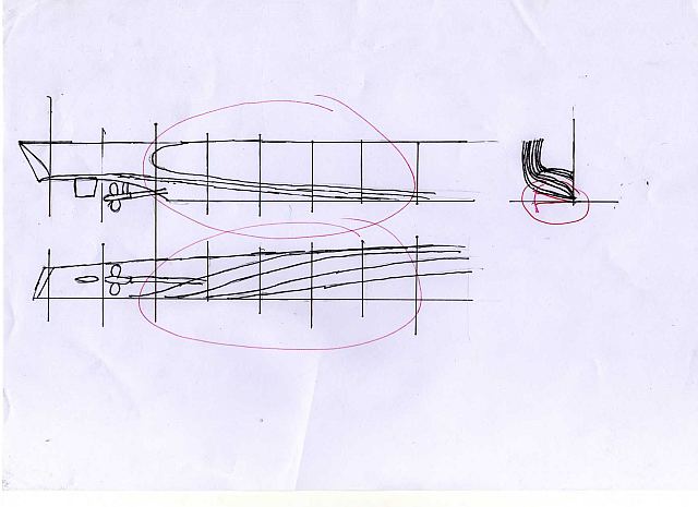

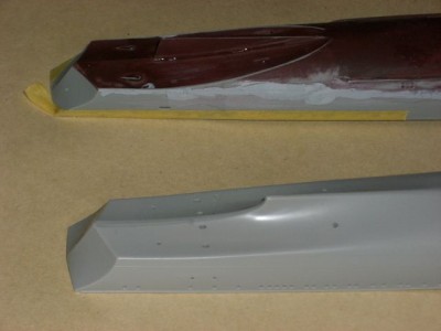

I have seen the line drawings in the meantime. The aft underwater hull of the Z-39 is wrong.
Should be like the photo below, much rounder and longer. The bilgekeels are about 40 mm to far aft and the transom is at least 2 mm too narrow. if you compare it with the Trumpeter hull (Z-25/Z-43) you will see immediately what i mean. This is how I realized it first (see the second photo)
I have the line drawings, but I cannot post them here for copyright reasons. The source is: Hadeler, "Kriegschiffbau" Vol 1 between P. 16 u 17, Zerstoerer 1936A.
For information, Hadeler was Hadeler was leading designer in the german navy before the war and one of the designers of "Graf Zeppelin and had access to original plans.
There are probably other sources for the line drawings, however, you cannot reconstruct the hullform only from a sideview and some cross-sections alone, as this could lead to misinterpretations like in this case

Posts: 352
Location: roma, italia
in the book z-vor vol 2, harald fock, you can find in the last two pages a good plan (two pages, 40 cm long) of z 34 with hull lines and two drawings (around 25 cm long) with hull lines of paul jacobi and z 28.

Do they more closely match the Trumpeter hull or the Dragon one?
the shortest drawings are close to the trumpeter model but the big plan is close to dragon, with the bilgekeel arriving until the propellers but the keel lines are more rounded, like trumpeter

My point thus being that it is too early to state definitively that either hull is wrong. We have conflicting sources, and while one would appear to be from a good source close to the originals, we have no way of truthfully vetting either short of photos and other documentation.

To clarify the matter I made a small sketch of the lines of the aft body of a 1936A type destroyer.
You can clearly see, that they have very fine lines in the aft part. Th only harp bend is for the overhang in the waterline, but there is no sharp bend forward of the propellers, which would obstruct the water flow. That the transom is wider than in the model is not really important, you only see it in comparison with another one. The considerable deadrise in the bottom is not existing in the model, too. The bilge keels cannot be seen in this drawing but in every side view there are much more forward (inevitable, as the aft part is too fine for them, they have to be at the widest part of the body)
Btw. "Z-5 Paul Jacobi" is an earlier 1934A type destroyer with a slightly different stern and underwater lines. She e.g.has only one rudder.
I think the offical drawings from the Kriegsmarine on which the sketch is based are reliable. If you look carefully at the crossection peppe has attached a few posts earlier you can see that int he left section is no sharp bend in the sides, which would be present if the model would be right.
