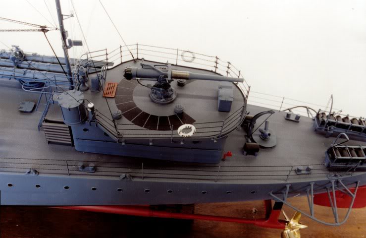

wr wrote:
Dear Willie,
What is that very large object at the aft end of the aft deckhouse?
Hi there,
Sorry but it is not clear to me what you are refering to.
If you mean the big boxes on the structure, they are ammo boxes for the AA gun.
If you mean the lattice boxes at the very aft peak, they are depth charge racks.
Could you please mark in the picture what you are talking about ?
Best regards,
Willie.

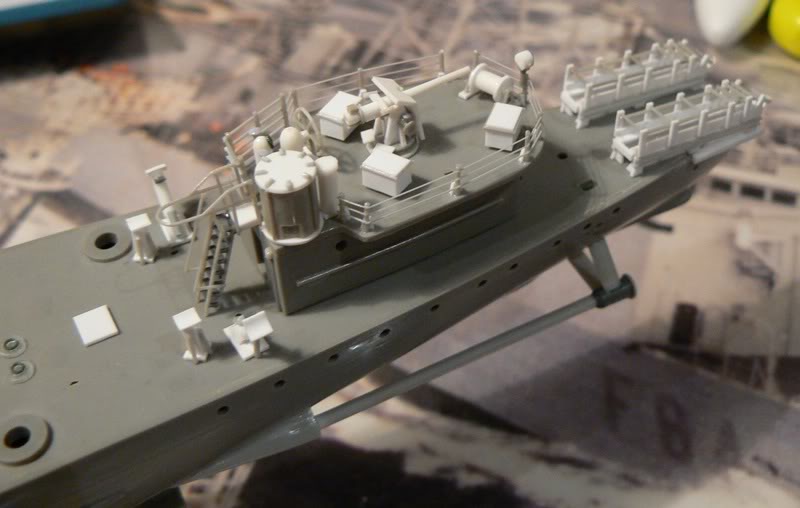

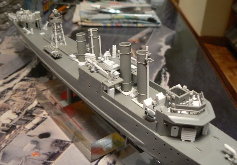

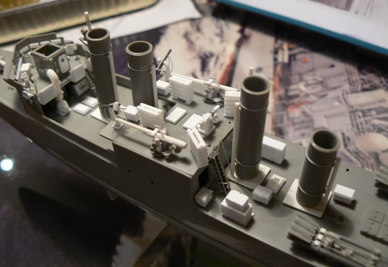

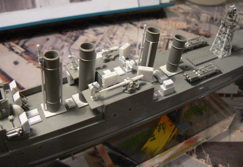

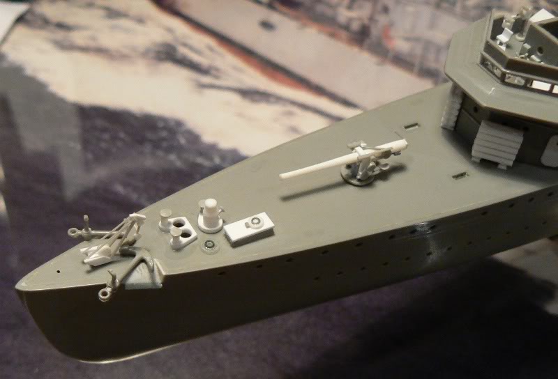

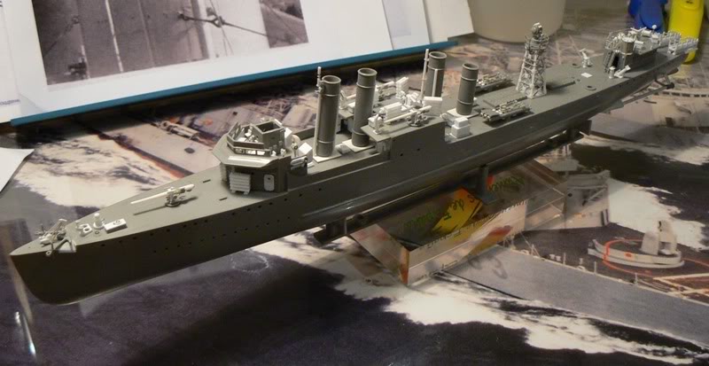

And here are a couple of views of everything that has been constructed up to this moment. All the big elements minus masts and flying bridge are already present.
I hope you like them. All critics are of course more than welcome.
Very best regards,
Willie.

My mistake, I meant to say the very large item at the FORE end of the aft deckhouse, port side. It looks somthing like a reel, or drum.
 Post subject:
PostPosted: Sun Jan 07, 2007 6:42 pm
Posts: 4046
Superb!
Have fun, Monkey around.™
 Post subject:
PostPosted: Sun Jan 07, 2007 7:09 pm
Posts: 681
Location: Vigo, Spain
Aha, clear enough now : It is a compass house.
Best regards,
Willie.

Dear Willie,
It cannot be a compass house can it.
May I suggest that it is the crews shelter for the 12pdr gun. A framework made of steel pipe covered with canvas. The framework would be square or rectangular in plan view shape.
The aft steering position with the compass and binnacle you have already fitted a few feet away on the starboard side.
If you REMOVE the structure and replace as above and leave the aft end compleatly open, that should be good.
If however you feel that you are correct, then please come back to me with the references that you have.
Willie wrote:
Best regards,
Willie.
 Post subject:
PostPosted: Mon Jan 08, 2007 8:53 am
Posts: 681
wr wrote:
Dear Willie,
Well, I have never been onboard a flushdecker in action :eyebrows: , so I took the info from AOTS HMS Campbeltown, and according to it, it is a compass house.
The pipe/canvas framework was actually on the other side, and I have done it with thicker stretched sprue. Maybe it is not so apparent in the pics.
The compass house could be where I placed it :
Or just fore the fantail structure :
HMS Campbeltown had it on the fantail structure.I have also noticed that -- surprisingly enough -- they can be of different sizes as well !!!
Actually they were there where I have placed them, not in the centerline as you suggest. This tip can be observed in any plan of these ships.
I hope it was of some help. BTW, are you building the same ship ?
Best regards
Willie.

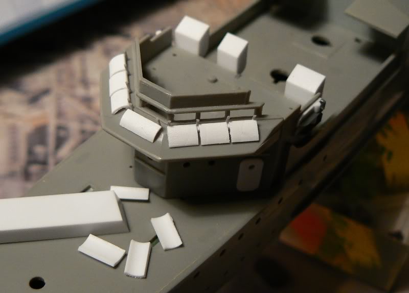

The windbreakers for the bridge windows had a very easy solution : they were made with thin chips of Evergreen bar, cut to the right size and glued together to thin strips of styrene.
Best regards,
Willie.
