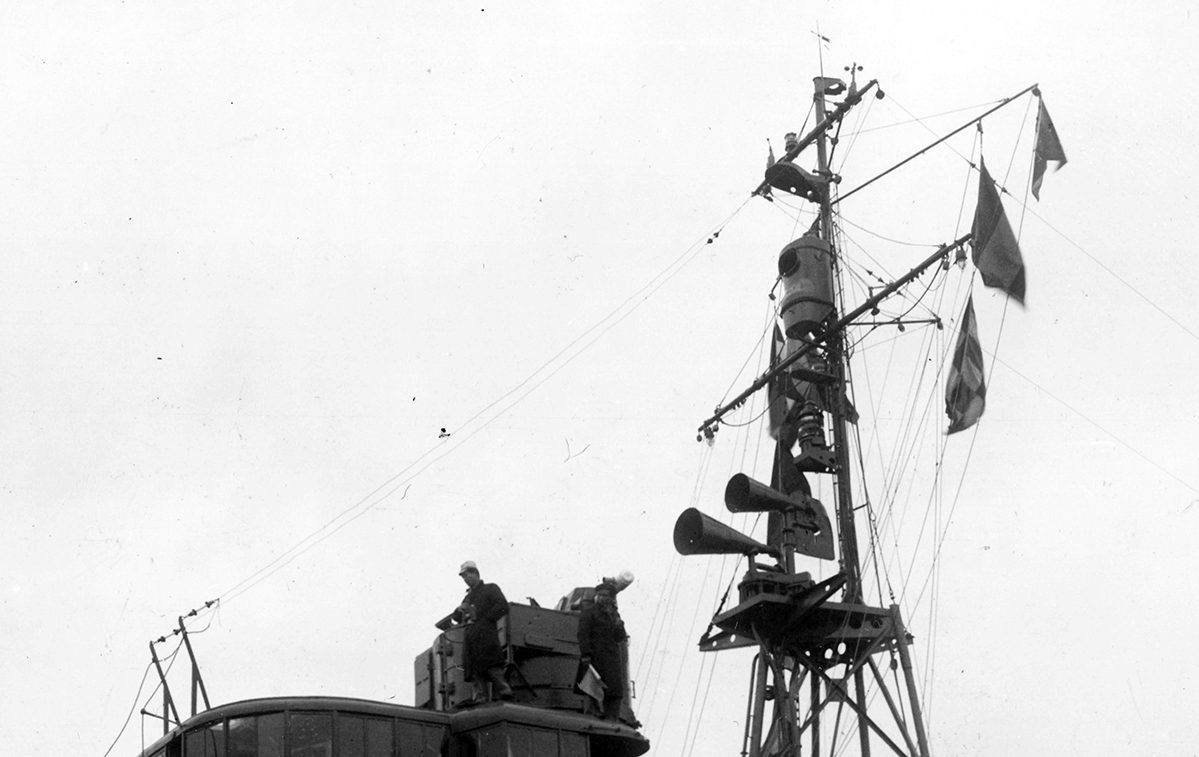

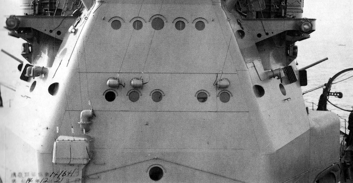

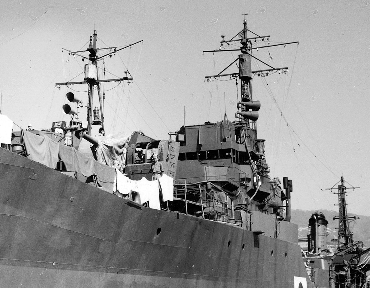

I may have been a little premature on this. I didn't look through the Navtech papers, but I did review the clearest photos I could find on various ships. I know some ball type insulators were used on various ships, but these all seem to have what I assume are white ceramic inserts. Please enlarge. Opinions welcome.

Interesting. I am seeing a white "fuse" type (don't know what else to call them) and the more familiar dark ball type. Several Japanese ship detail books such as the Grand Prix volumes show ball types in series of two or three, but I don't remember ever seeing the "fuse" type before. I initially mistook them for lights but the pics you posted of the two DDs disprove that. Thanks again for all the help, now have to sort out the locations.

I think it must be remembered that the insulator will get covered with soot and will show as dark. Most of the ships I've worked on in communications have had the white cigar shape with metal inserts, the other thing is the antenna all should have safety loops as well ( a step too far on 1/700. On 1/700 1 use a small drop of PVA and painted flat black brown sort of a light rusty colour.
