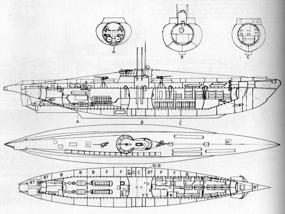

PostPosted: Sat Mar 17, 2012 12:45 pm
Posts: 352
Location: roma, italia
same images and data from various books, groener die deutchen kriegschiffe, roessiter u-boote, d. miller u-boats, bagnasco sommergibili della seconda guerra mondiale
ciao peppe

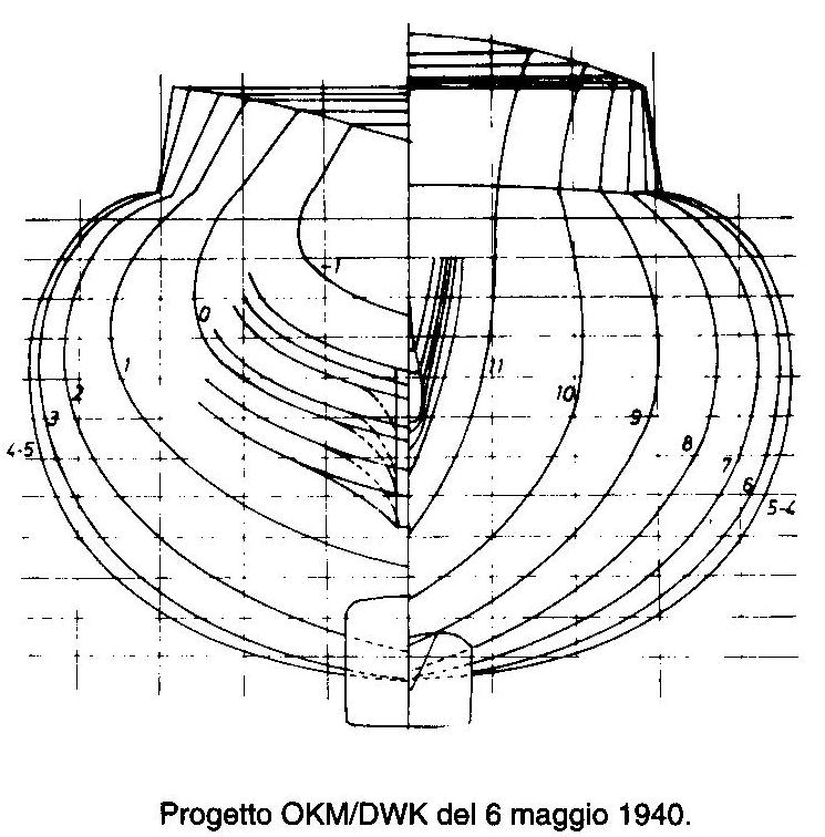

PostPosted: Sun Mar 18, 2012 5:37 am
Posts: 1813
Hi Peppe,
Thanks! Every piece of info helps, in this case in particular the ship's frames diagram 'Progetto'. Super!
It seems that the info about the lenght has come a long way, Groener generally was pretty accurate. However, I had spotted one or two errors in that authoritative work (on other ships that is), so I remain suspicious about that given length.
Hope if anyone else might add some insight. Olaf, maybe?
Roger Whittaker +9/13/2023

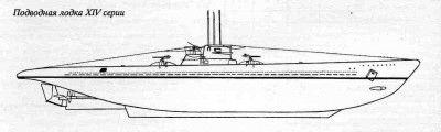

PostPosted: Sun Mar 18, 2012 12:07 pm
Posts: 352
one more information from jurgen rower u-boote
one from breyer and some from russian sources
ciao peppe

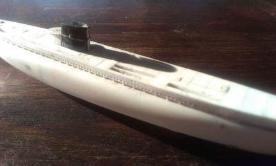

PostPosted: Wed Oct 21, 2020 4:17 am
Posts: 1813
And now I can even show the first casting! To me it looks pretty good...
When I can tell more about availabilty and price I'll let you know.
