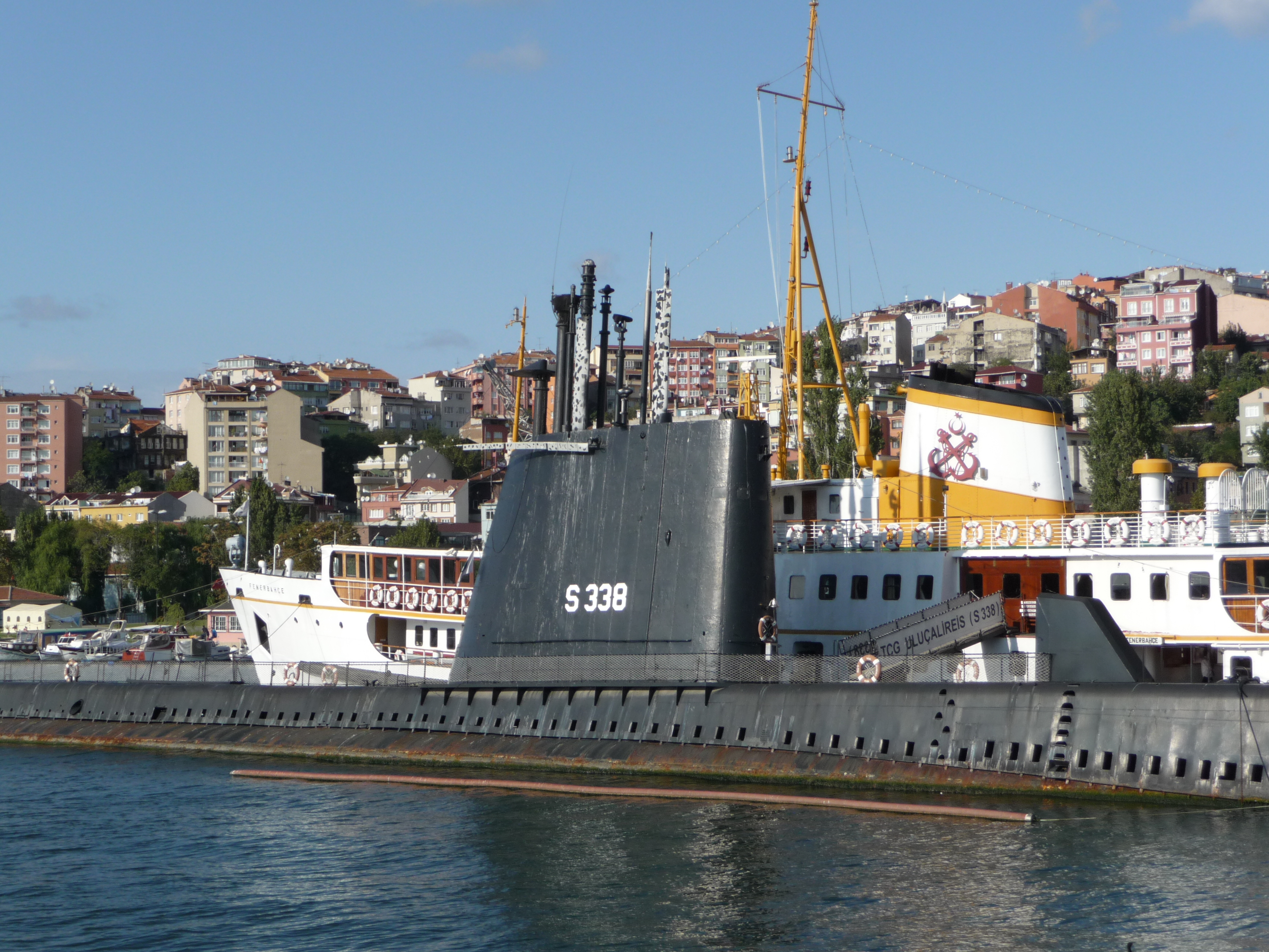

PostPosted: Sun Dec 28, 2014 3:46 pm
Online
Posts: 12331
Would photos of Turkish museum Tangs help? Waterline-up only, of course. Or if you have an image of what to look for/where they're located, I can check through what I have.
PostPosted: Sun Dec 28, 2014 4:06 pm

PostPosted: Sun Dec 28, 2014 4:56 pm
Online
Posts: 12331
Doesn't look like it - just a bunch of cables and ropes.
PostPosted: Sun Dec 28, 2014 5:41 pm
Posts: 268
Location: United States
Thanks for those photos! Yeah I don't see anything either. I don't mean to be overly pedantic, but the last photo is a GUPPY, not a Tang. We sure gave a lot of diesel boats to the Turks.
Under Construction:
1/350 Typhoon
1/350 Skate
1/350 USS Nautilus
1/350 Tang
1/350 November
1/350 Hotel II
1/350 Alfa
1/350 George Washington
1/72 Type VIIC
PostPosted: Sun Dec 28, 2014 6:23 pm
Online
Posts: 12331
You're right, it's a Tench class - always get them mixed up.
