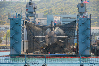

Here's some shots of USS Greenville in drydock. If you look carefully (they are not at the best angle for photography), you can see the anhedrals in all three photos:
In this shot, the anhedral is just visible below the sternplane, about where the red & black hull demarcations meet:
http://www.cpf.navy.mil/subsite/ehimemaru/images/0102greeneville26-med.jpg
This shot taken inside the drydock also has the anhedral visible at the rear, just below the sternplane. It is clear that the mounting is more horizontal than at a 45 degree angle:
http://www.cpf.navy.mil/subsite/ehimema ... 27-med.jpg
In this final drydock shot, a portion of the anhedral is just visible below the sternplane:
http://www.cpf.navy.mil/subsite/ehimema ... 25-med.jpg

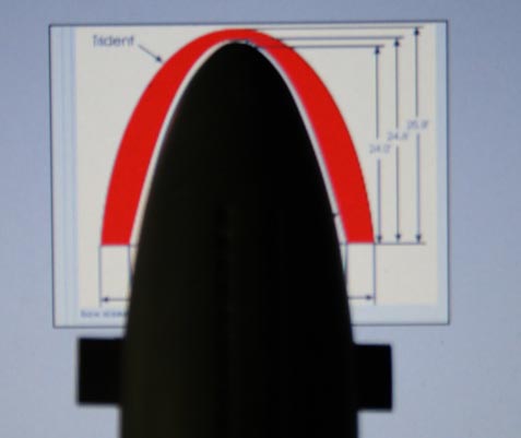

OK, let's post some figures and see what everyone comes up with. Tom; a question; the "Bow cap template" means that this is the dimensions of the non-metallic nose cone, yes? I wanted to clarify that in case the following assumptions are wrong.
I took a screen shot of the graphic and resized it a bit until it was close (slightly larger) to the same size as the Riich kit, which I have (don't have the Hobby Boss yet). Eyeballing it shows it's pretty close... perhaps a touch narrow forward, but perhaps only by a scale foot or two on each side for about 10-15 scale feet. End of the cone on the drawing matches the kit. However, that's all visual inspection, with perspective error and no guarantee that I actually scaled it correctly.
Converting the imperial measurements to metric, I get 7498.08mm for the length and 8107.68mm for the width, which scales down to 21.42308571 and 23.1648 mm respectively. Annoyingly, my calipers have disappeared. At the aft edge, the engraved line for the cone APPEARS to be about 23.5mm wide versus the 23.16 it should be... I think I can forgive this. However, the engraved line appears to be about 1.5mm further aft than it should measure. Can't quite rectify how the extreme aft beam appears correct but the length doesn't... probably just improper visual line-up on my part.
I'd call it close at this point. I'll keep an eye out for my calipers or buy another set this weekend.

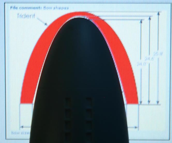

Here's the picture I shot last night... the red is a flood fill between the Ohio and the 688 class profiles to make it easier to see the 688 profile:
Note that this is slightly over-scale just to compare.

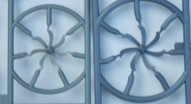

It looks like the ring also allowed them to completely re-profile the blades as well; more paddle and less scimitar.
File comment: Hobby Boss blades on the Left, Riich on the right.
HobbyBoss to the left and Riich to the right. I don't think either looks right; in fact, the old Dragon prop looks better to me.
Here's the HobbyBoss bow for comparison to my earlier Riich look:
File comment: HobbyBoss Bow
I had a harder time making this one "fit." It looks like it's a little too flat at the nose and doesn't flare out enough aft. Really, both look good to me. It's a tube with a rounded bow... not that difficult, and the lines look right to my eye, which admittedly has not spent years looking at the things in drydock... so I'm uncalibrated. :big_grin:
However, using Tom's drawing and my conversions, we can take a wee bit of a look at shapes and other details. The sonar dome aft diameter is 26'6" and "Cold War Submarines: The Design and Construction of U.S. and Soviet Submarines" By Norman Polmar lists the hull diameter as 33'.
That translates to just over 23mm (23.1648mm to be precise) wide at the aft end of the sonar dome and 28.73mm in 1/350th scale.
I get 28.58mm beam and 23.64mm at the end of the sonar dome on the Hobby Boss kit. Seems close enough, but the sonar dome should be about 21.5mm long, and I measured mine at 19.86, which is ~22.6 inches, or just under two feet two short.
Anyone feel like re-scribing a ring on a compound curve for less than two scale feet? :crazy:
On to the Riich model. 28.74mm on the beam and 23.45 at the end of the sonar dome, which was 22.30mm long, or just under a scale foot too short.
Either way, we can't use the kit sonar domes to really accurately measure shape, and we're only off by a scale foot or two here and there anyway. So now let's compare the bow details a bit:
