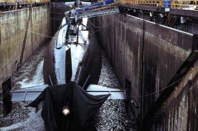

Back in 2007, an aerial photo of an SSBN (SSBN 731) propeller ended up all over the internet, courtesy of Microsoft Virtual Earth. The propeller should have been covered in drydock, as mentioned by rx79gez8gundam above (interesting forum name, BTW. Any relation to Mr. Mxyzptlk of Superman comics?). Anyhow, it is not a real closeup, but you can get some idea at this link:
http://lewis.armscontrolwonk.com/archiv ... ret-screws
Hi guys,
I picked up this thread from the previous page, I did some measuring and calculations based on the satellite image. I come to the conclusion that the prop (screw) on the Ohio class is 22.5 feet in diameter, and this is a very likely value as it is exactly 1.5 times that of most SSN subs of the era, which seem to be 15 ft in diameter.
This dismisses the DML/Dragon/Italeri/Testors prop as way too small, probably based on a semi-official drawing I also found on the web, showing exactly the queer prop that can be found in the kit. Also the shape of the blades is hopeless, see this peek view on the tips of a real Trident SSBN prop:
I'm currently working with the firm Raboesch in NL whether they can make a credible brass example in 1:350 scale (19.6mm diameter), as they already have done it in larger RC scales. They are quite interested in my idea, let's see what comes out!

Large slow revolution speed propellor to avoid cavitation would make sense. Multiple thin blades with large curvature to breakup noise from the propellor cutting through hull flow as well.

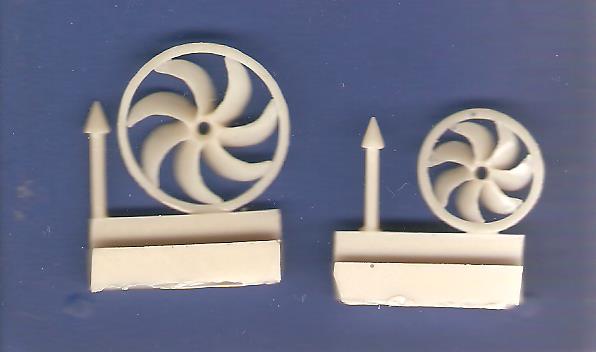

Hi guys,
as it seems no-one is making a good 1:350 prop for the Los Angeles and Ohio classes I took the initiative: these resin props are based on the publicly available info on the internet. Diameter for the 688 screw (prop) is 15 ft, for the Ohio SSBN is 22.5 ft. The shafts are kept separate as you see, and can easily be inserted. The ring around the props are there to help in the casting and can easily be removed, but if someone wants a ringed 688i screw the ring might be reduced in width by filing and sanding.
I'm also making an earlier seven bladed variant with less skewback, which was used on every boat from the Skipjack and George Washington classes onwards, I think even on early 688 boats. I might even do a five petal-bladed version for the early Skipjack and George Washington, although these were never used operationally.
The screws are available from Naval Models in the Netherlands http://www.navalmodels.com, or send an email to info@navalmodels.com.

hello ! do you still produce those propellers ? I need a Ohio class one.
can you give me the direct link to this item ? I cannot find it on your proposed website.

Hi mister You :big_grin:
The props are still available from Naval Models, however their website is not up-to-date: they're working on it, I know.
You better send an email to the shop manager Michiel Woort, info@navalmodels.com or his private email, wijkergouw104@gmail.com. Give him my regards, I'm sure he has all the sub props in stock!

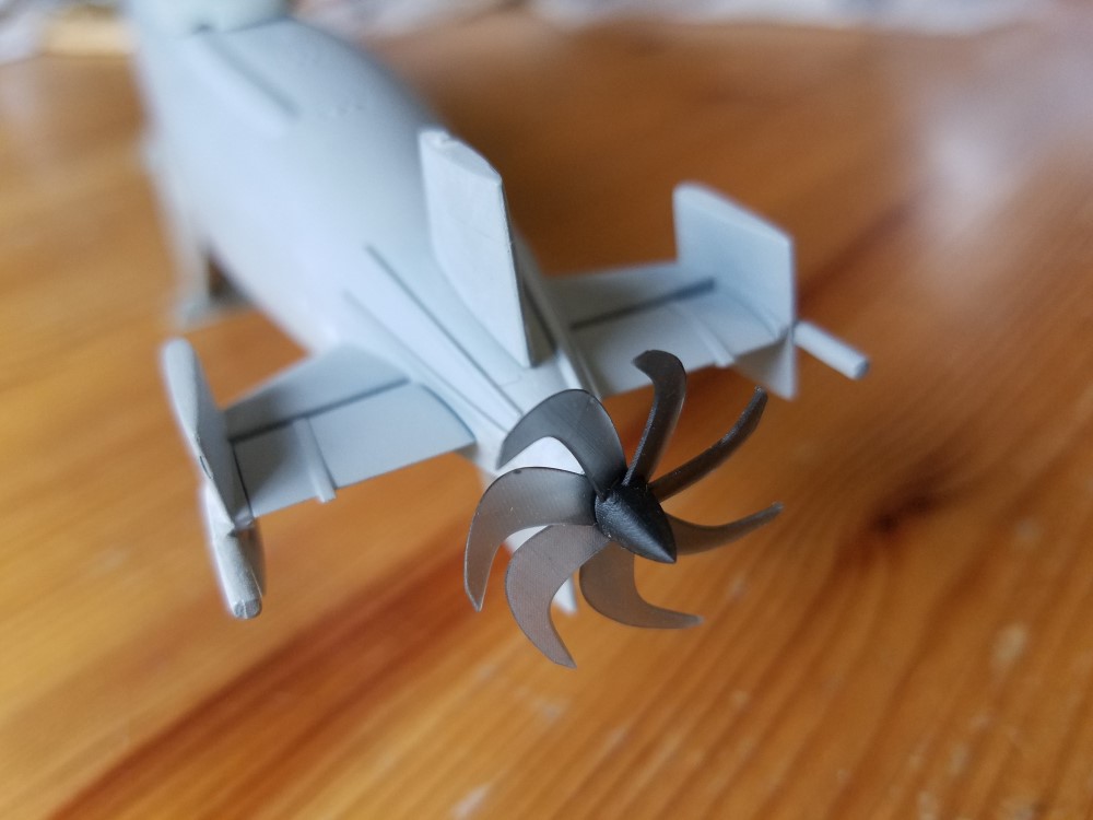

I'm offering my Ohio screws for sale on eBay:
https://www.ebay.com/sch/mulsannemike/m ... pg=&_from=
If they show up sold, I will relist them. Or feel free to contact me directly.

Hi Woodstock,
Your screw look nice, and it is certainly much better than the kit screw. However, it seems to lack the blade twist. And I find it awfully expensive! wish you lot of sales of course. :thumbs_up_1:
A cheaper alternative (with blade twist) is still this prop: https://www.navalmodels.com/product/propeller-ohio-class/
So at least there is a choice now! :big_grin:

If you want to incorporate some pitch into your propellers, you can use the following formulae:
p = 2πR*tan(α)
α = arctan[p/(2πR)]
where p is the pitch, R is the radial coordinate (0 at the axis of the propeller, and equal to the radius of the propeller at the tips of the blades), and α is the pitch angle (α=0 is perpendicular to the axis of the propeller, α=90 is parallel to the axis of the propeller).
Unless you have a good pitch curve (that plots p as a function of R), I would assume that the pitch is constant. Real propellers are typically "relieved" at the tips (the pitch is decreased) to reduce cavitation, but I doubt you'd be able to notice in 1/350 scale. If you don't have any data at all on pitch, I would start by assuming that α=45 at the hub and calculate the pitch from there.
Also, most modern skewed propellers have a rake of around 5 degrees or so. The older skewed propellers on the Permit, Sturgeon, and 41 For Freedom SSBNs appear to have much less rake.
