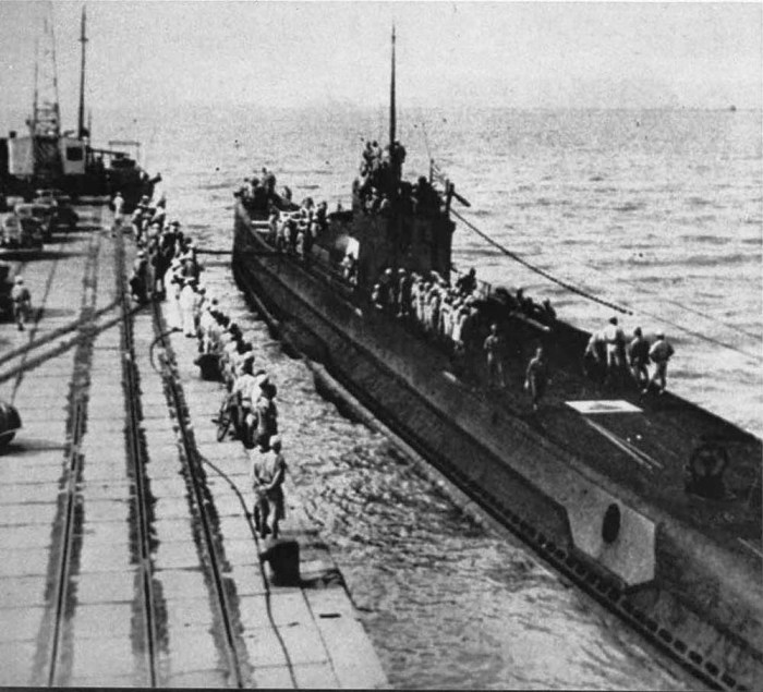

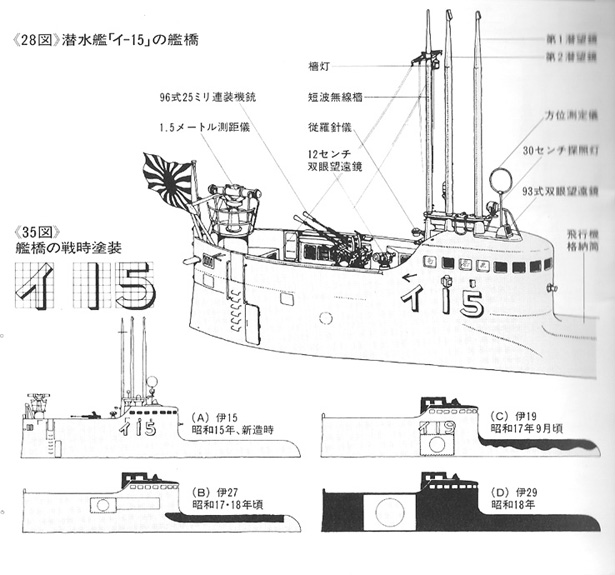

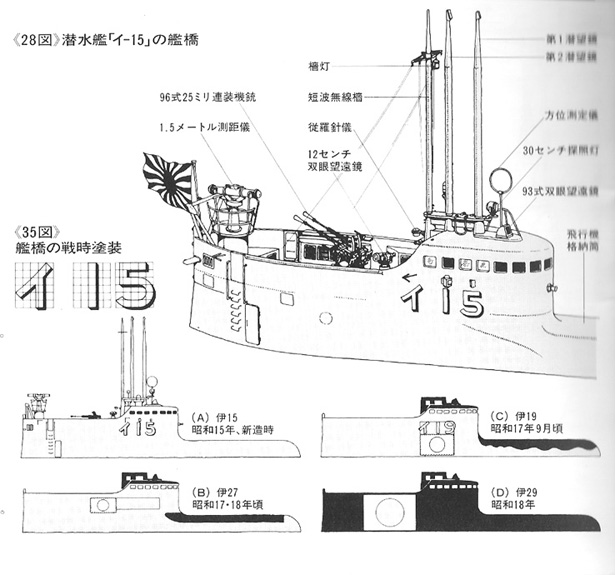

I-19 in July 1942 and color schemes for B1 types, including I-19 from the tamiya Random Details book
Type%20B1-I-15%20class%20conning%20tower%20and%20schemes%2C%20Tamiya%20Random%20Detail%20v1%2C%20p8 small.jpg
Type%20B1-I-15%20class%20conning%20tower%20and%20schemes%2C%20Tamiya%20Random%20Detail%20v1%2C%20p8 small.jpg [ 107.3 KiB | Viewed 5537 times ]

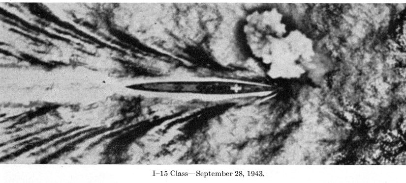

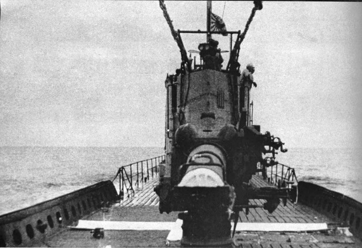

Hi Phealan.
There are very, very, very little photos of IJN subs showing the ID stripes. I would say, it is very probable that I-19 had them. There are paintings of I-19 sporting them, but these are based on assumptions.
What you must be aware of is that the number and exact placement of the stripes was rather individual. I have seen pics where the stripes on the rear deck were crossed instead of parallel. Furthermore, on some boats the stripes were painted, on others they consisted of white fabric attached on both sides of the deck. There are also "mixed" solutions, e.g. painted on the forward deck, and fabric on the rear deck. The advantage is: you do what you like and nobody will be able to say it's wrong.
I have a small number of example pics on my harddisk, but I'm in the office now, will post them tonight.
HTH, and cheers,
Peter

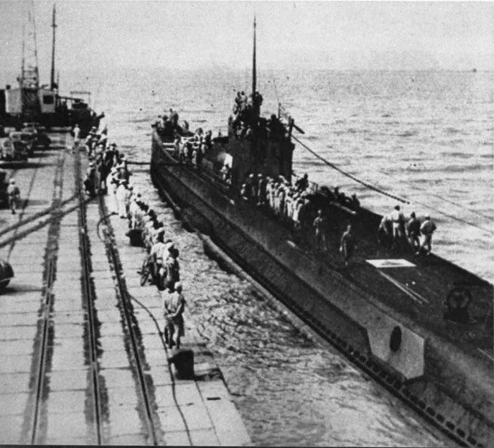

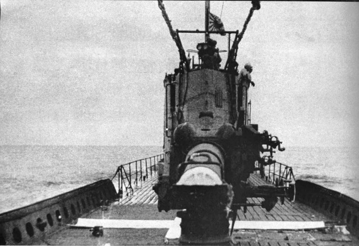

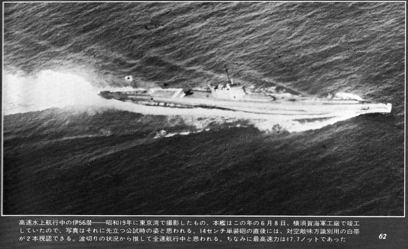

Here you go with a couple of examples (all of them B type):
Unidentified B1 type, pic taken by US Airforce on 28.09.1943
I-37 (B1 type), foredeck
I-37 (B1 type), sortieing from Penang

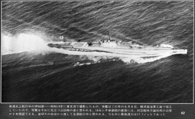

I-56 (B3 type), from Maru Special 110, p. 62
HTH,
Peter

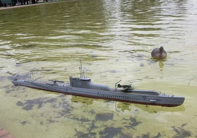

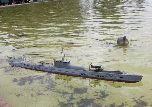

For those of us still pining for a large scale IJN sub kit, I was told by a trusted source who attended last week's iHobby Expo that Lindberg is currently re-working their tooling with plans to re-issue the I-53 in addition to the I-20 kit that has been held after the earlier debacle with that sci-fi Godzilla sub. As the old saying goes, I guess time will tell.
To see what can be made out of a sow's ear, there is an excellent build thread over at the SD-Forum.
http://forum.sub-driver.com/showthread. ... 25-in-1-72
PostPosted: Wed Oct 26, 2011 10:41 am
Posts: 8835
Look at the size of that prehistoric duck, it's coming in for the attack! Must be one of Godzilla's allies. Hard-a-starboard and dive, dive, dive!

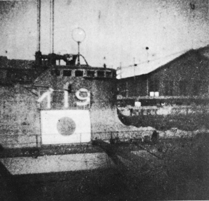

On this excellent thread, the magazine with I-19 submarine cover art painting has been referenced but not posted, so I attach it here. I am currenty building the 1/200 Nichimo I-19 and want to confirm something I have read. The upper hull gray should be the "IJN Yokosuka Grey", right?
Also, it would be great to see some photos of finished I-19s.
Thanks
Phillip1
PostPosted: Fri Nov 25, 2011 3:36 pm
Joined: Fri Aug 07, 2009 4:57 am
Posts: 320
Phillip1a wrote:
Fellow Modelers,
Hi Phillip
Not sure about the Yokosuka Grey... I-19 was built at the Mitsubishi Naval Yard, but her home base then was Yokosuka, where she was also overhauled in drydock in March/April 1942.
Anyway, I think that after a couple of months of action, you would simply see a heavily weathered dark grey.

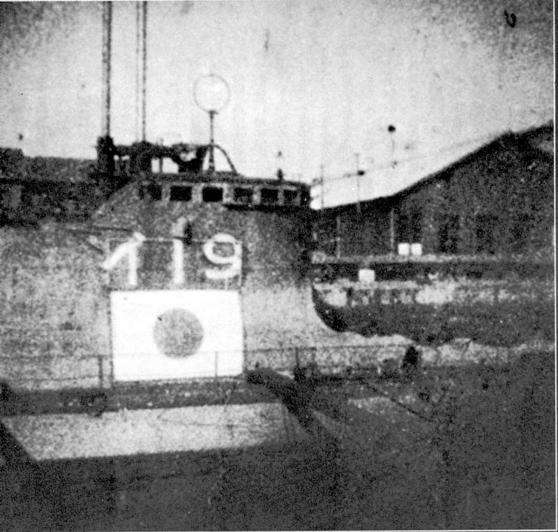

This pic shows her at Yokosuka in July 1942, some two months before she sank the Wasp:
Note the black upper side of the conning tower and the black hangar roof with wavy edge.
The black probably extended over the frontal hangar door, unlike the cover art of the magazine.
Peter
