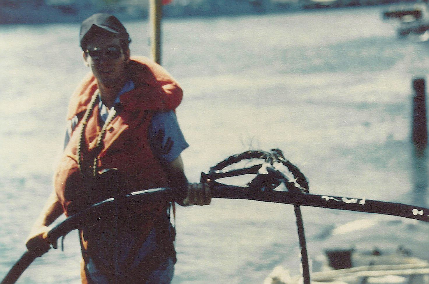

The STASS (Submarine Towed Array Sonar System) installed aboard the 598 class contained a hinged stub cable storage compartment located on the starboard stern plane stabilizer that contained enough cable to reach topside with a couple of figure 8 turns thrown in for good measure. A day before we would leave for patrol, divers would remove the cable and lay it into the tow point before passing a line topside for us to haul the rest of it on deck. When we got outside Guam's Apra harbor, a Mike boat (a repurposed WWI landing craft) with the array on a reel would come alongside and we would pass the stub cable over to them. They connected it to the array and reduced speed to trail the array behind us away from the screw, far enough away to prevent fouling.
When we left Pearl Harbor for the final time to transit to the West coast for eventual de-activation (Oct '79) we prepared to pull the stub cable topside. The diver left too much slack in the cable and when we spun the shaft (the shaft seals are tightened import and loosened when underway, so the shaft has to rotate occasionally to maintain the seal) the Fickle Finger of Fate intervened. Anyway, the second pic of me displaying the result is priceless. Our CO was always a screamer, known for his epic meltdowns, and this initiated yet another. For us, it was just one less piece of equipment to monitor as we headed to San Diego. He blamed us for the diver's mistake and made our lives (extra) hellish for the entire transit.
The array was from the BQR-15, which in later boats was equipped with an onboard storage and handling system. For the 598's, the channel amplifier was the BQR-25, and the display processor was the BQR-23. I think there were something like 20 beamformed, waterfall narrowband channels to monitor and only four could be displayed on the screen at once. The Sonar Supervisor (sitting in the back of the shack) would rotate a dial and the channels would cycle on and off the screen the screen. During operation, it was sensitive enough to pick up the turbine signatures of high-flying commercial aircraft for short periods of time. The CO hated to be underway without it.
San Diego-based, Spectral Dynamics built the BQR-23, based on their proven BQR-20, 20A, and 22 series spectrum analyzers. They all stood about five feet high and were divided into function-specific rack-mounted, slide-out units. None were light. Unit 4 was the monitor - an 18" monochrome green screen CRT. We had one fail on a Seawolf mission with no spares. The BQR-22 was a dual-channel spectrum analyzer that we relied on to analyze our primary sonar acoustic data. One of the spooks heard about our problems and brought us a dual-channel spectrum analyzer that fit in the cavity unit 4 occupied. Not only was it small, it had more capability! They got the money for fancy equipment and we didn't.

Ouch.
