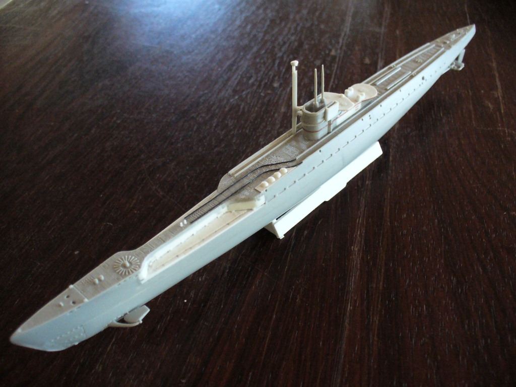

Hi guys,
One of my recent projects: converting a 1:350 Hobby Boss Type IXB into a late war IXC/40, with Schnorkel and Schnelltauchback.

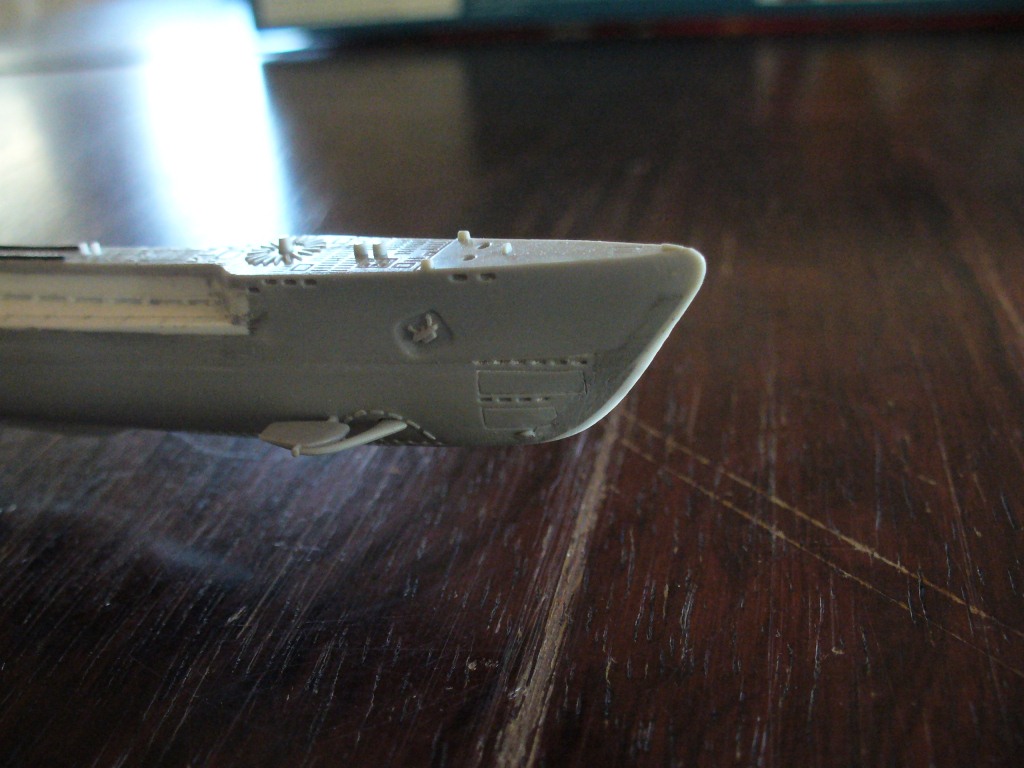

First I corrected what I consider the greatest error of the kit: the stem is too raked, almost like that of a Type VII, so it should run much more vertical. This is very easy to correct.

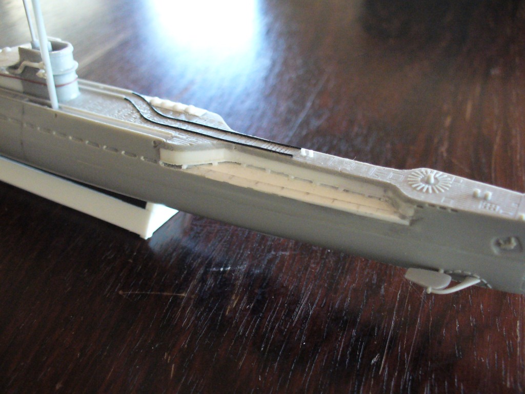

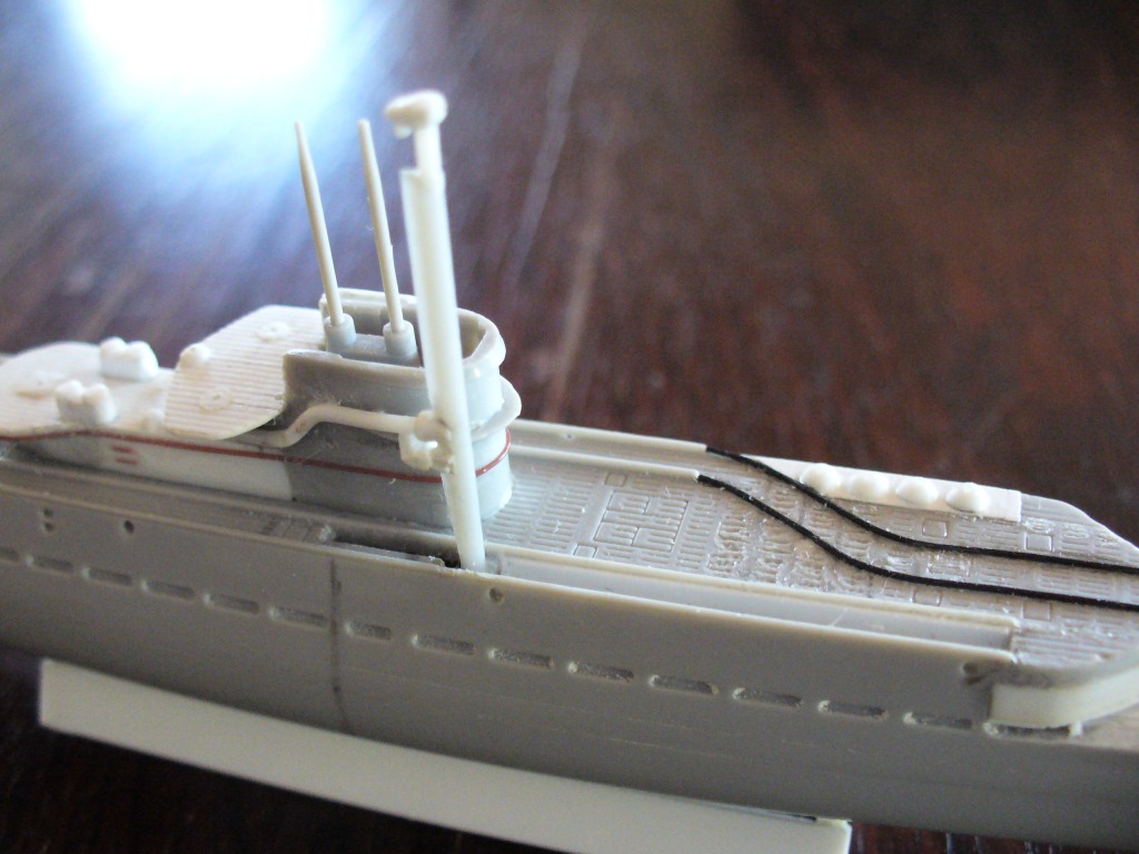

Then I built the Schnelltauchback, rearranging the deck features, including the tracks that are used for moving torpedoes around. Also I made a well for the Schnorkel mast.

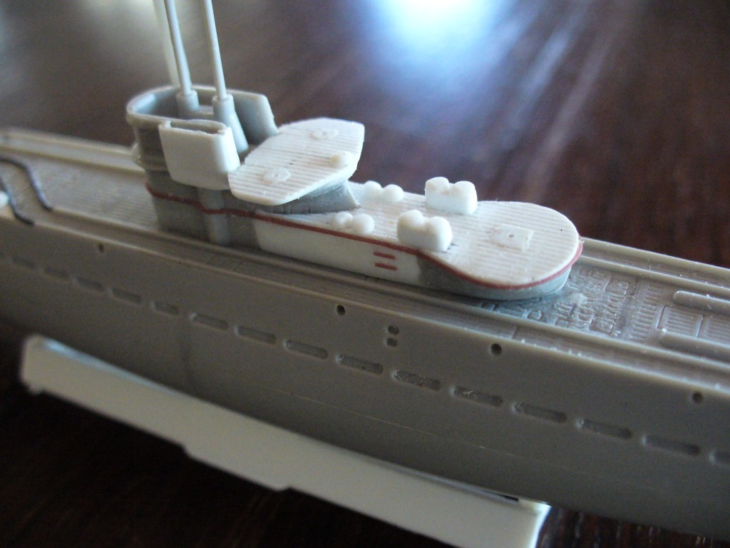

Further I modified the bridge/conning tower.

So this looks quite different now, some small details and railing to be added and then on to painting. I thought you would like to see it in this state, without paint, then it is much clearer what I have done.

Drooling.......that is beautiful
