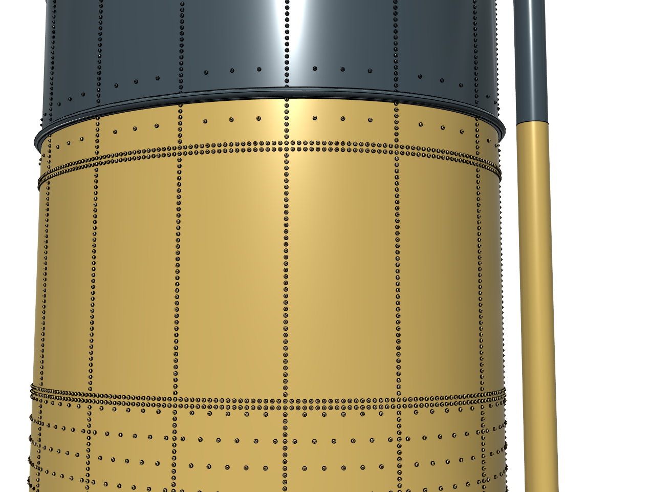

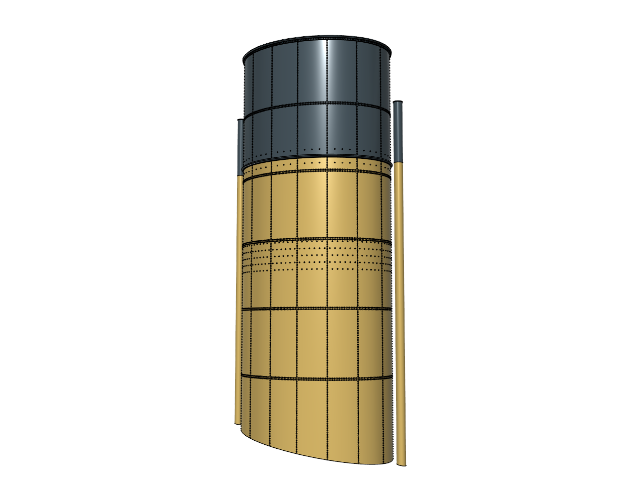

Posts: 4046
Seeking photos or authoritative drawings of the tops of funnels # 1, 2 or 3, view downwards from above, into the funnel interior, showing interior structure and funnel top grills. Have photos of funnel 4.
Any help is hugely appreciated.
This is for a project to be offered in 1/350 and 1/400 scales. Here is one of four parts of that project, the design for funnel # 2 at 50% complete.
Model Monkey 1-350 Titanic Funnel 2 at 50 percent a.png [ 192.18 KiB | Viewed 3858 times ]
Model Monkey 1-350 Titanic Funnel 2 at 50 percent b.png [ 310.82 KiB | Viewed 3858 times ]
Model Monkey 1-350 Titanic Funnel 2 at 50 percent c.png [ 419.1 KiB | Viewed 3858 times ]
Model Monkey 1-350 Titanic Funnel 2 at 50 percent d.png [ 273.2 KiB | Viewed 3858 times ]
Have fun, Monkey around.™
