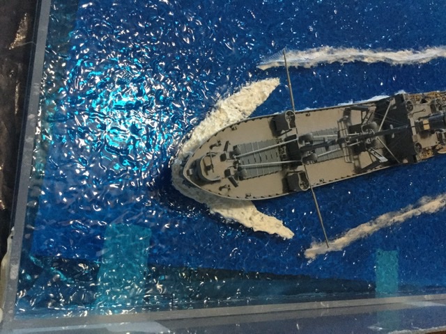

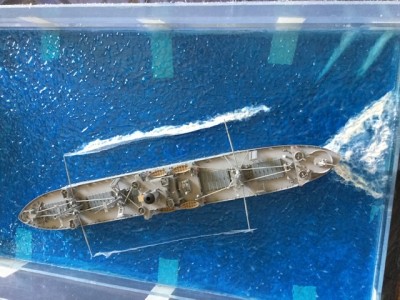

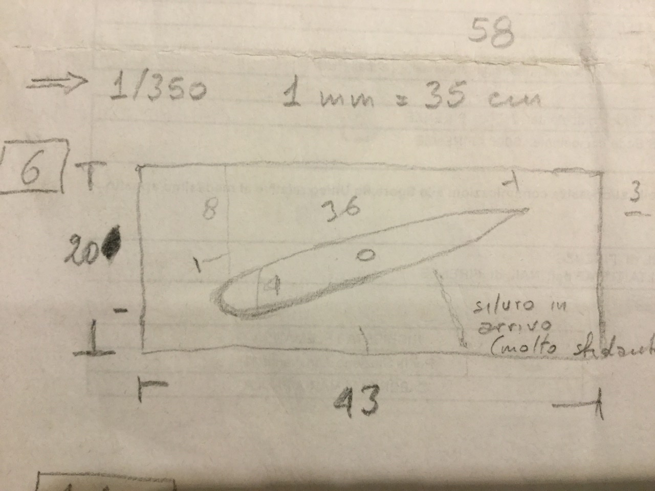

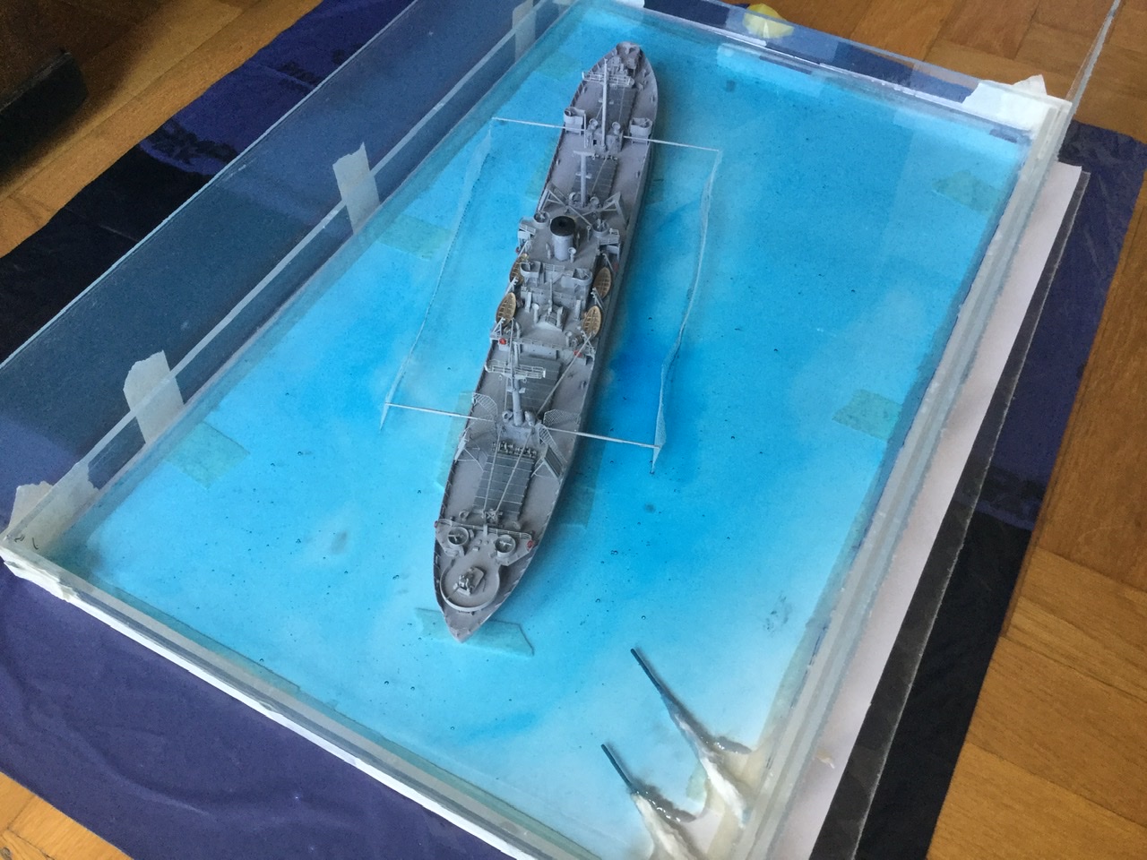

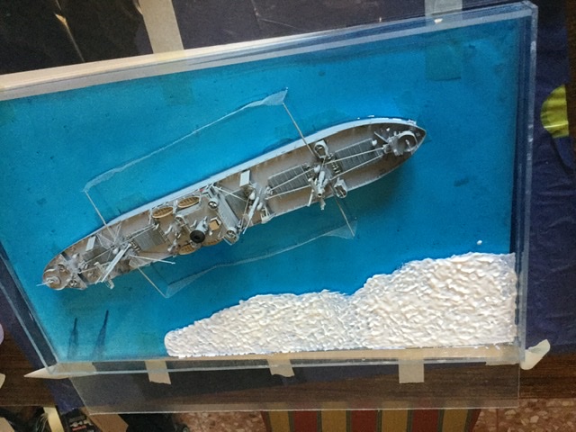

Last week started the very final stage... the setup of the diorama. That kind of activity that can give the final touch but that can also spoil and ruin everything. Below the present status, after the first three layers of 2components resin. At least another 2 are needed in order to get a final 8 mm of sea surface. Then ripples will be added. One layer per day. Still many chances to spoil it all, but the final picture is appearing. The starting sketch, handwritten, dates 2013 and when i wrote on it “torpedo arriving, very challenging” i yet had no idea of how to do that.
File comment: Wave trials, under process
File comment: The first idea of the diorama, 2013

I agree with Reigels. As much as possible all booms had to be secured during navigation. If the payload allowed it, the lowered position was chosen. Else the raised position. There are some pictures of exception but i think they could be related also to training on the job, done while navigating in domestic waters. I find unlikely that during convoy activities in high seas someone could hazard to take risks like that, expecially since the time between an air or submarine alarm and the attack was short and for sure time could not be lost in securing booms. Where the booms secured at the same fixing points? Really i do not know.
Below, i started doing the ripples.

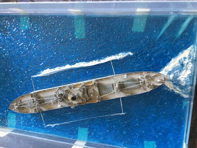

Things proceed quite slowly. Ripples are in place, but need improvements (white tops here and there). The rear area is getting ready and the right torpedo net area too. In b/w the overall impression starts to be nice, isn’t it?
File comment: Present status in b/w
File comment: Top view in progress

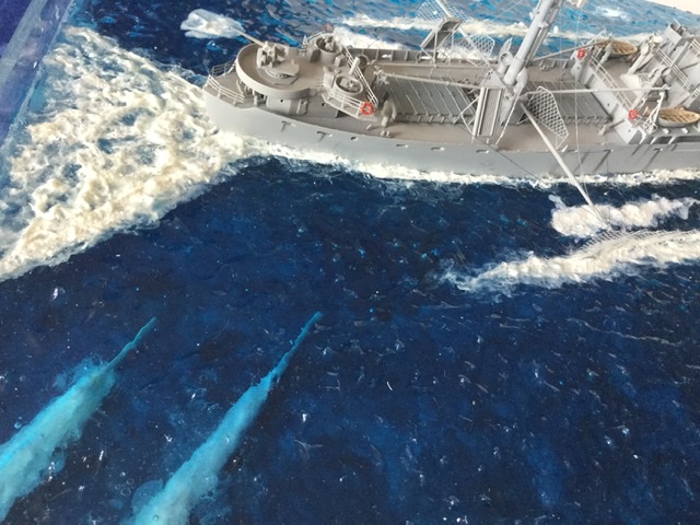

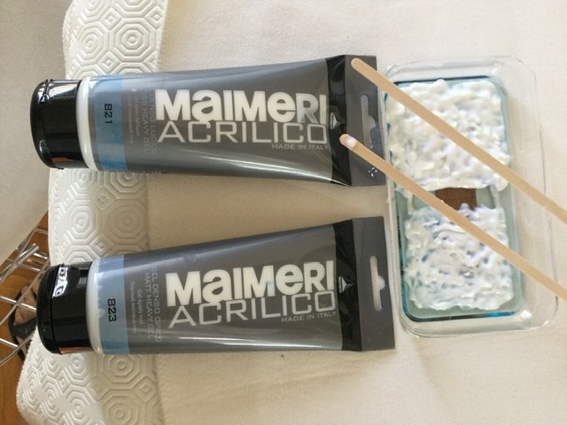

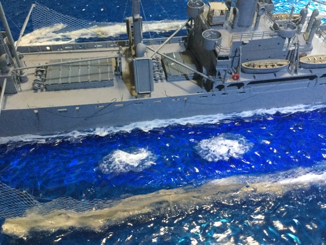

As a matter of fact, after some trial, i proved that the white ripples along the side can be done preparing some medium gel plus cotton plus transparent gel and then putting it in place and modulating it with two toothpics. Since they should be very small and light there should be no need to add white colour, while i added for the massive front waves (being the ship under attack, it was trying to move full speed). In the picture below both the sides and the front waves have steel to dry. Tomorrow we’ll see how they appear

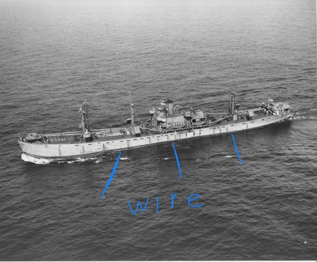

After adding the wires that hold the safety nets’ booms, i added the ripples and today i added the wire that i think was laid for safety reasons.
File comment: The safety ropes
File comment: The safety ropes in place

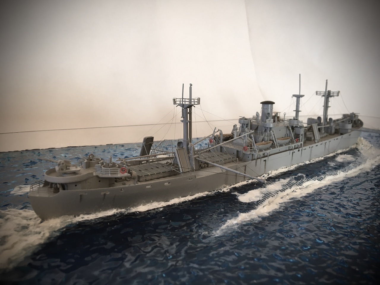

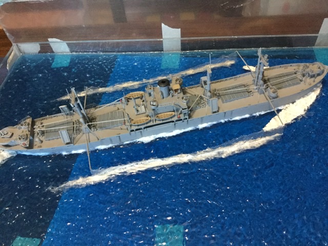

I think it is time to close the Martin Van Buren Project. With the last wires hanging from the mast tops to the booms hanging the nets i think the project is over. It has been a long and interesting job that led me to discover a whole world. Hundreds of hours spent searching the net, many hundreds in building the kit, setting up the diorama and making the case (base, sides and roof, in transparent plastic), exchanging experiences with some of you. Thanks to everyone. I now must take some more pictures and send for the gallery. And maybe write down some lines about what I did and what i learnt. The kit was not difficult, but i think i added a lot (scratchbuilt) to the original kit of Trumpeteer. And I am quite satisfied of the final result. It is also the first model of a Liberty ship with torpedo net deployed made or at least published. The dramatic of the torpedoes incoming was another challenge on its own. Won-hui Lee is a master in torpedoing and his tips were of hispiration. And now i can finally clean the desk and look at my finished diorama. Long life to Liberties !

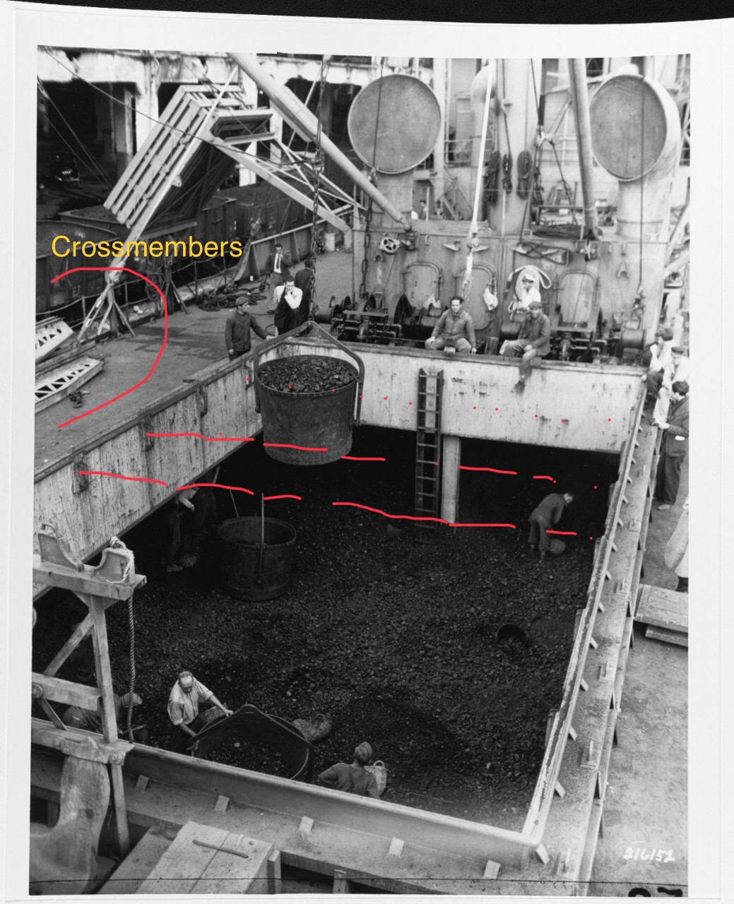

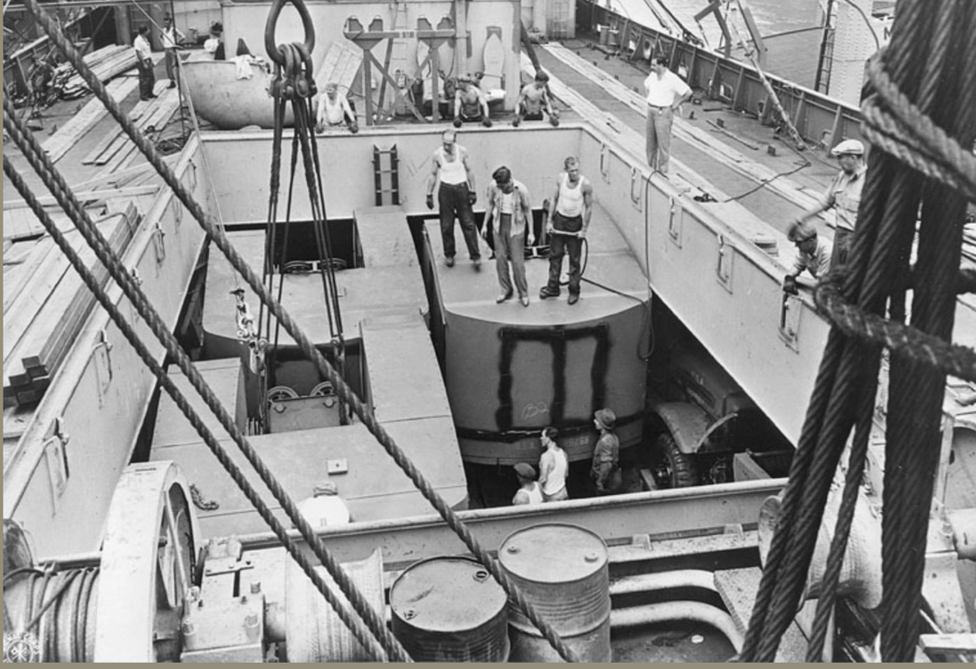

I am making a model of a Libertyship with nr 2 hatch in open condition.
My question is: the hatchcovers of the tween- and topdeck were they made of steel or wood?

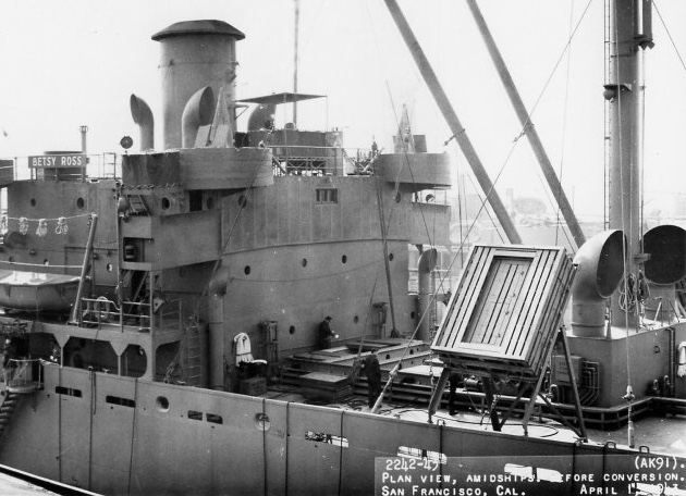

If I well understand the question, I would say that there were some steel crossmembers (should be 6) and then wood tables were placed above them. Canvas was placed at the end. At least according to the pictures I found in my archive, shown below.
File comment: Crossmembers removed
File comment: Another view
File comment: Crossmembers in place and some tables in place
