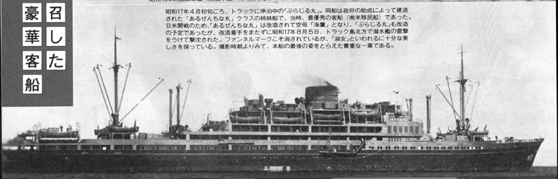

Woohoo, finished my Brasil Maru at last! viewtopic.php?f=74&t=73052&p=438627#p438627
Timmy C,
Great build of yours in the gallery!
Btw, while I realize your Brasil Maru is the pre-war liner version, did you ever consider converting/kitbashing into the naval transport version?
The Fujimi 40089 kit naval transport version doesn't seem that different from the pre-war liner version you did a review on, though the large davits/cranes on the bow and stern seem different.
And NO, the Fujimi 40089 naval transport version is not on 1999.co.jp, so I cannot compare the differences between the two kits from scans of their instruction booklets.
And I'm not confusing the liner with the hell ship Brazil Maru either.
I'm asking about a conversion since I recently got a Fujimi Brasil Maru 1939 kit as a gift.

Brazil Maru did not receive any changes of note until visiting the Yokosuka yard during the latter half of April, 1942. Even then, it was probably limited to only some armament.
Oh! Bother....
Any idea of what kind of weapons?
I am suspecting some 13,, or 25mm AAA guns (likely twins, if either).
But might it also have added from 3" to 5.5" guns?
MB

The TROM overview for the class says 2 x 12cm & 2 x 13mm: http://www.combinedfleet.com/Argentina_c.htm
Motoyuki Iwashige's model of Argentina Maru with probable placements: http://ww6.enjoy.ne.jp/~iwashige/argentinamarumod.jpg
Thanks Dan. By the way, the 2 x12 cm guns could probably be gotten from one of the Skywave WW2 Japanese ship equipment sets, but I'm not sure about the 2x 13mm guns.
