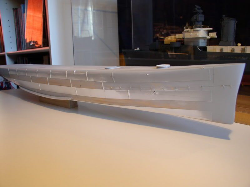

I was informed that I hadn't given an update on the Cook Inlet project by a friend of mine, so here you go.
This picture is a little dated since there has been more progress beyond this, but you get the idea.
I have finished blocking in the fire control platform above the bridge. Additionally, I have added butt strakes to the sides and have drilled and modeled a number of the overboard discharge ports. Having acquired ship yard drawings of the class I have made a few other modifications to the decks and structures to get them more accurate.

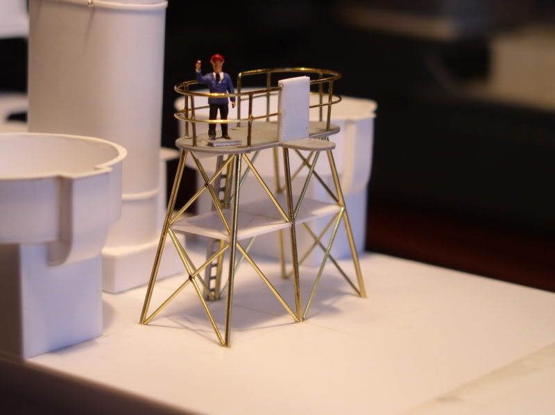

The other big addition was the basic framing up of the fire control tower amidship.
The main structure is .030" dia brass wire with .020" dia bracing. The entire assembly is just over 1" in height. I'll go back and add some wiring and the directors at a later date.

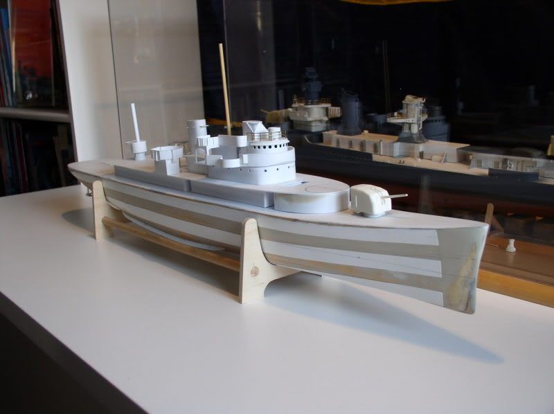

This picture is actually closer to where the hull currently stands.
Well, there you go; the current status of the USS Cook Inlet. Hopefully I'll be able to give more updates in a timely fashion, but since I'm rapidly moving into the fine detail segment of the project big gains are not that obvious.

Bruce,
Thank you so, very much for posting this progress pictures!!
That hull is just super impressive! But it needs seachest intake grates, though, don't you think? :heh: :cool_2:
I want to remind any, and all, on-lookers that this is 1/144 scale.
Just beautiful! I could sit and look at it all day. And I think I will. :wave_1:
