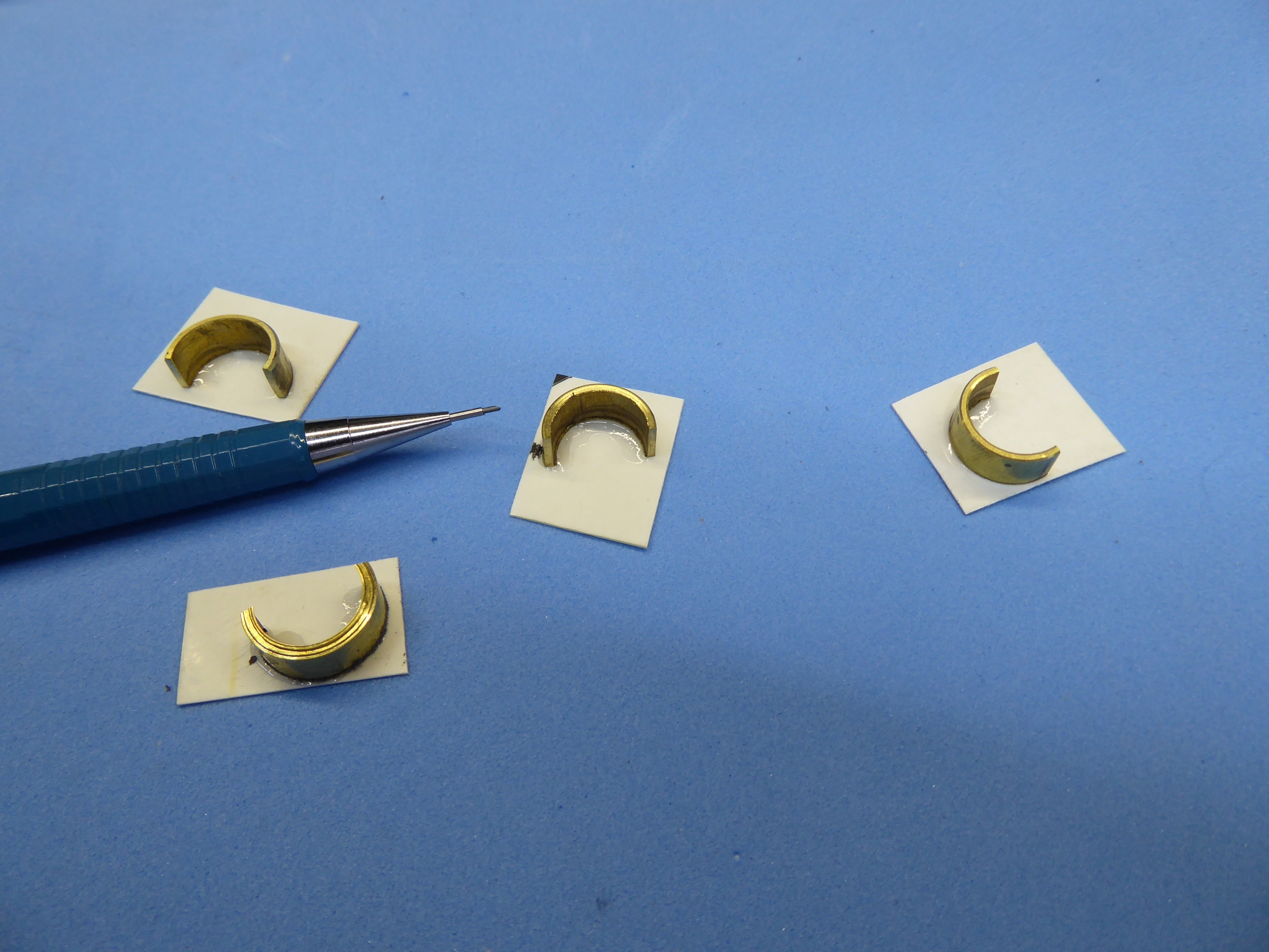

I found myself to be dissatisfied with my earlier paddle boxes--the surface of the media was not as smooth/ homogeneous as I would have wished ...
so I made some new ones ( x 4 in case of damage / error ) cut from of 14 mm thickwall brass tubing
which the outer faces made of Styrene ,
The styrene was subsequently pared and sanded to shape -this also gave the correct final paddle Box width

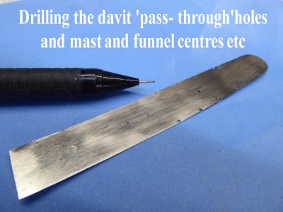

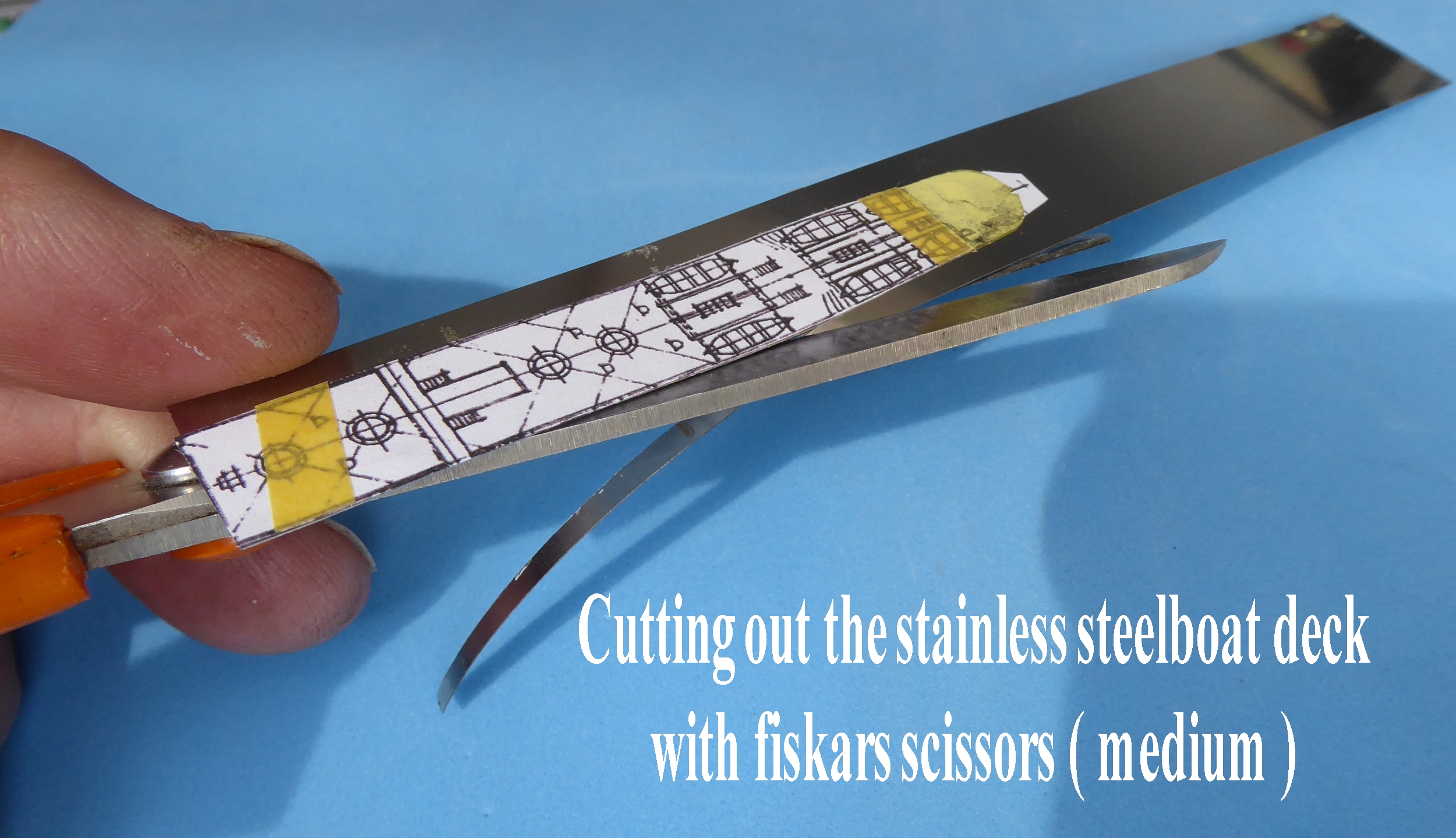

here are some images of the boat deck on the real ship,
note the deck is ' thin ' and the upper strake has an inset below

All styrene decking was too thick--brass is too soft -- and expands too much in heat/ contracts in cold
Stainless steel is better and more stable in terms of thermo dynamics
I cut my decking from a very wide ( 20 mm !) piece of stainless steel PE fret surround
This was cut with a new pair of Fiskars scissors
-looks unsubtle .... :big_grin: but very effective and as they are exceedingly sharp--almost distortion free :thumbs_up_1:
This deck was drilled in my mini pillar drill- with very small holes- to take the davits shafts
