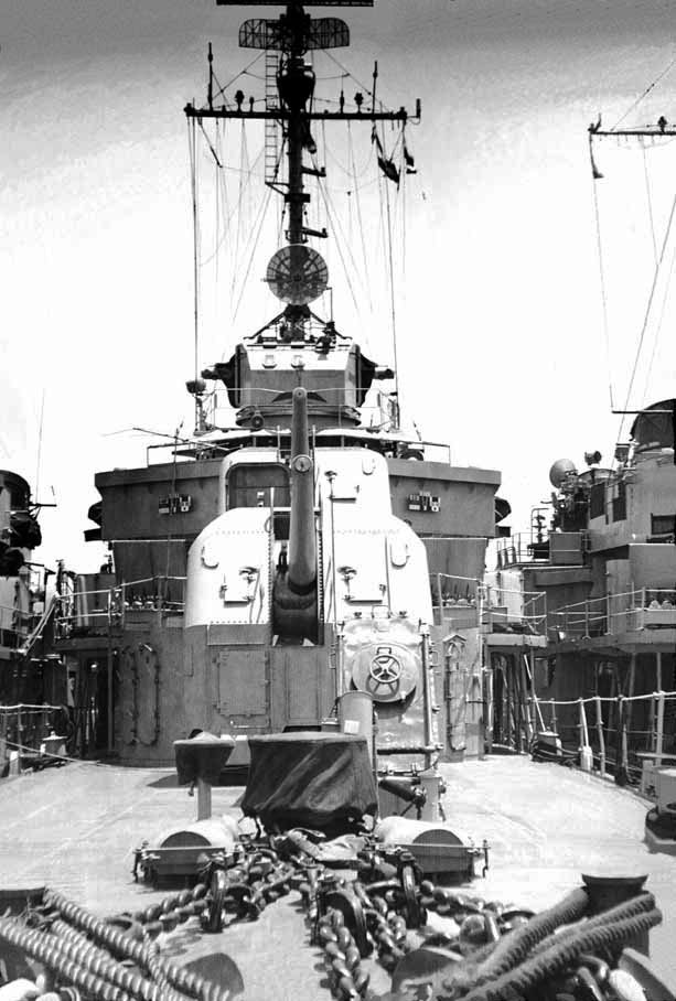

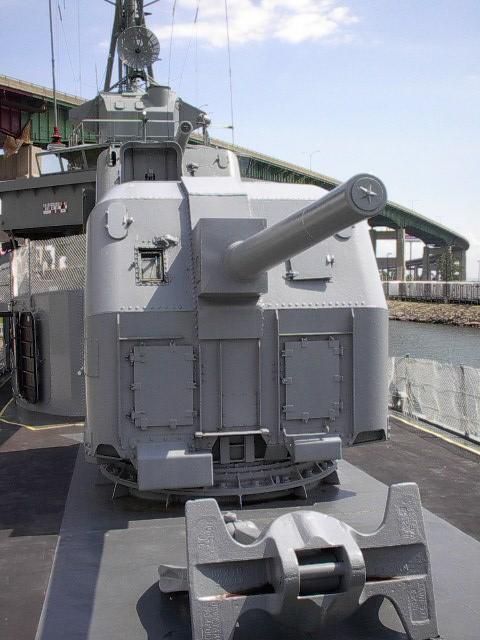

I do like your 5"38 mount, but you might double check the height of the mount captains blast hood, possibly a bit tall?

Regarding blast hood height, it does look tall but I was careful to build the hood height consistent with plans from Floating Drydock and photographs of USS Kidd from Squadron's USS Kidd on Deck. See also the blast hood height in the photo below of Mount 51 on USS Laws, DD-558, and the photo of Mount 51 on another Seattle-Tacoma-built Fletcher, USS Rooks DD-804. They are quite tall.

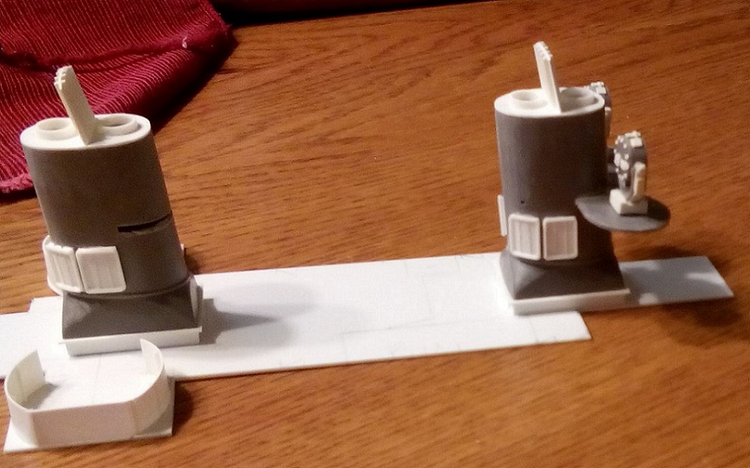

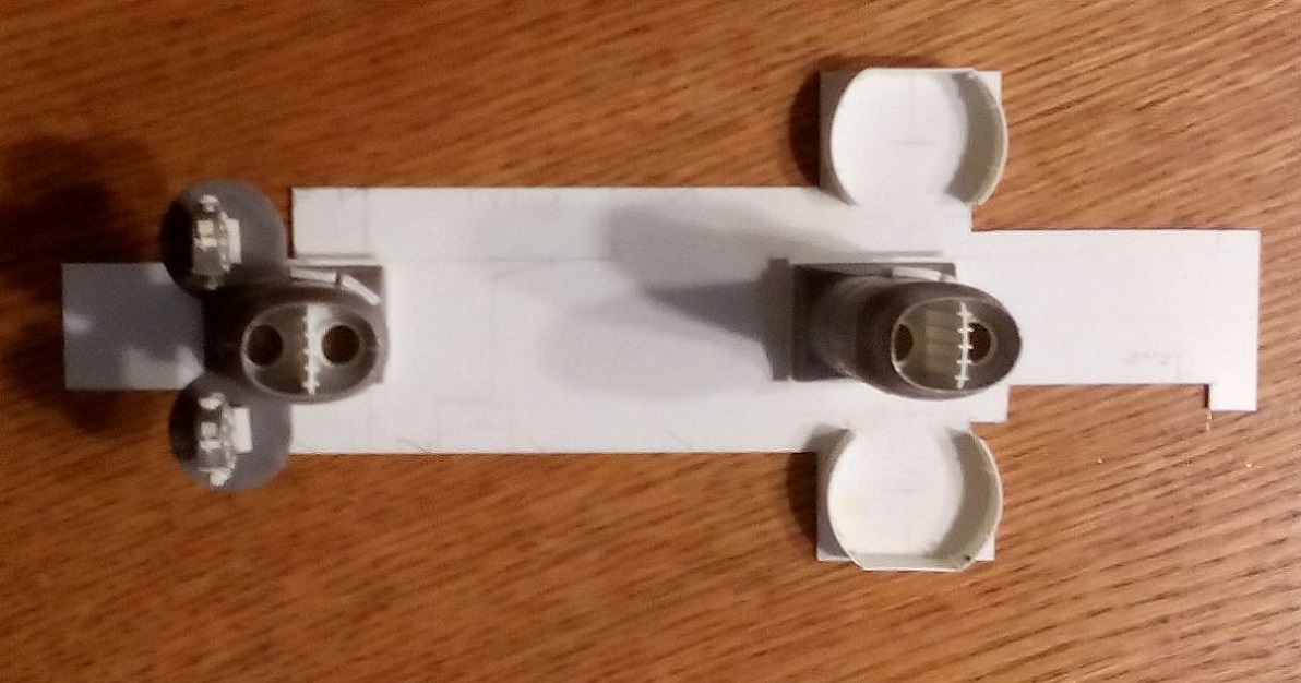

Here is a view of the smokepipe exhaust screens within the funnel caps, and the louvered intake vents.
As you know, funnels are actually quite complex structures internally. They aren't just a tube. Each Fletcher funnel encloses two smokepipes for exhaust gasses from two boilers each, and four intake pipes, two on each side of the smoke pipes, drawing fresh air in through intake louvers visible near the base of the funnel exterior.
Without access to plans of the actual exhaust screens, I chose to follow the pattern modeled by Fine Art Models on their Fletcher models.
I modified the Lindberg kit's funnels as their overall shape matched plans well. The funnel caps, louvered intake vents, and other details did not.

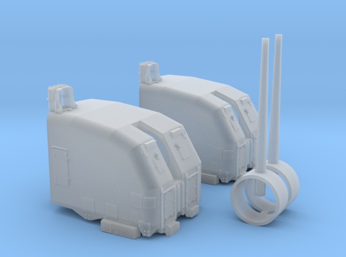

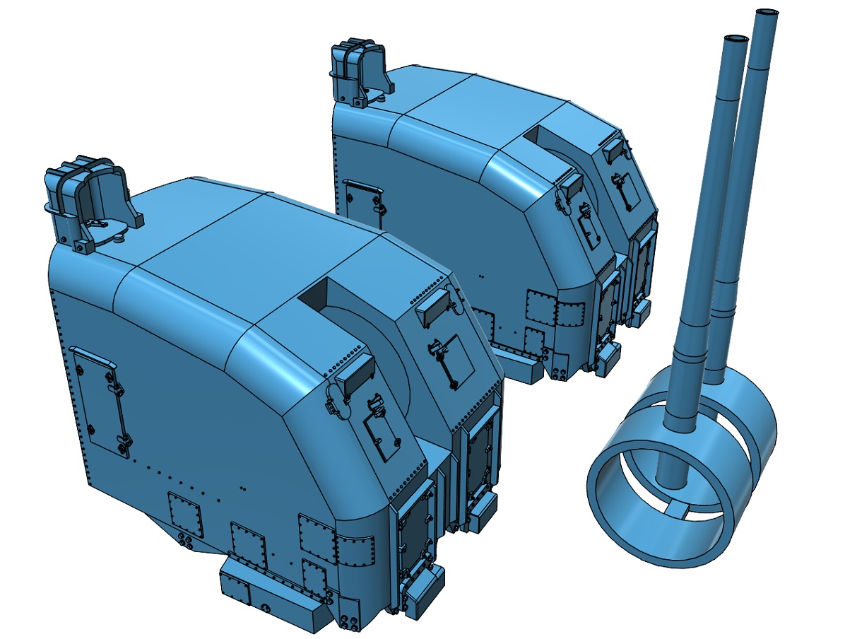

I have decided not to cast the 5-inch/38 Mk.30 mounts. Instead, I designed them in CAD for 3D printing so that they will be available to any of you who would like them for your models.
The "double knuckle" (heavyweight) mounts are available to you:
Early: http://shpws.me/OwBT
Late: http://shpws.me/Ow7A
I'll have the "single knuckle" (lightweight) design done shortly.
The double knuckle mounts (Mounts 51 and 55) are also available in 1/192, 1/96, 1/72 and 1/48 scales and can be easily re-sized to any other scale as long as it will fit in the 3D printer.
Here are two renderings of the double knuckle mounts:
