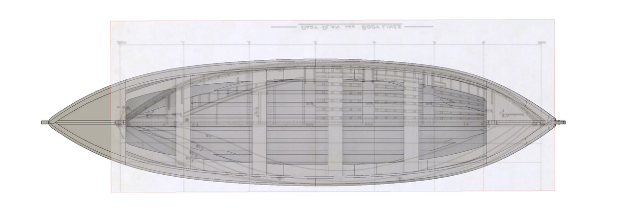

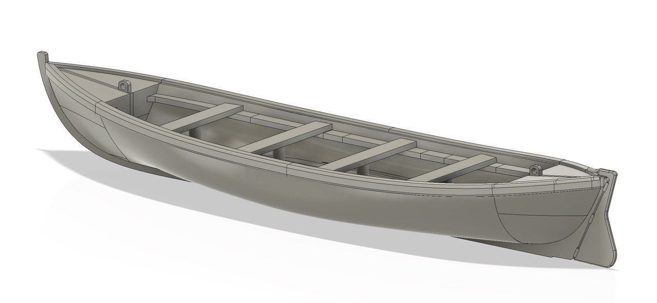

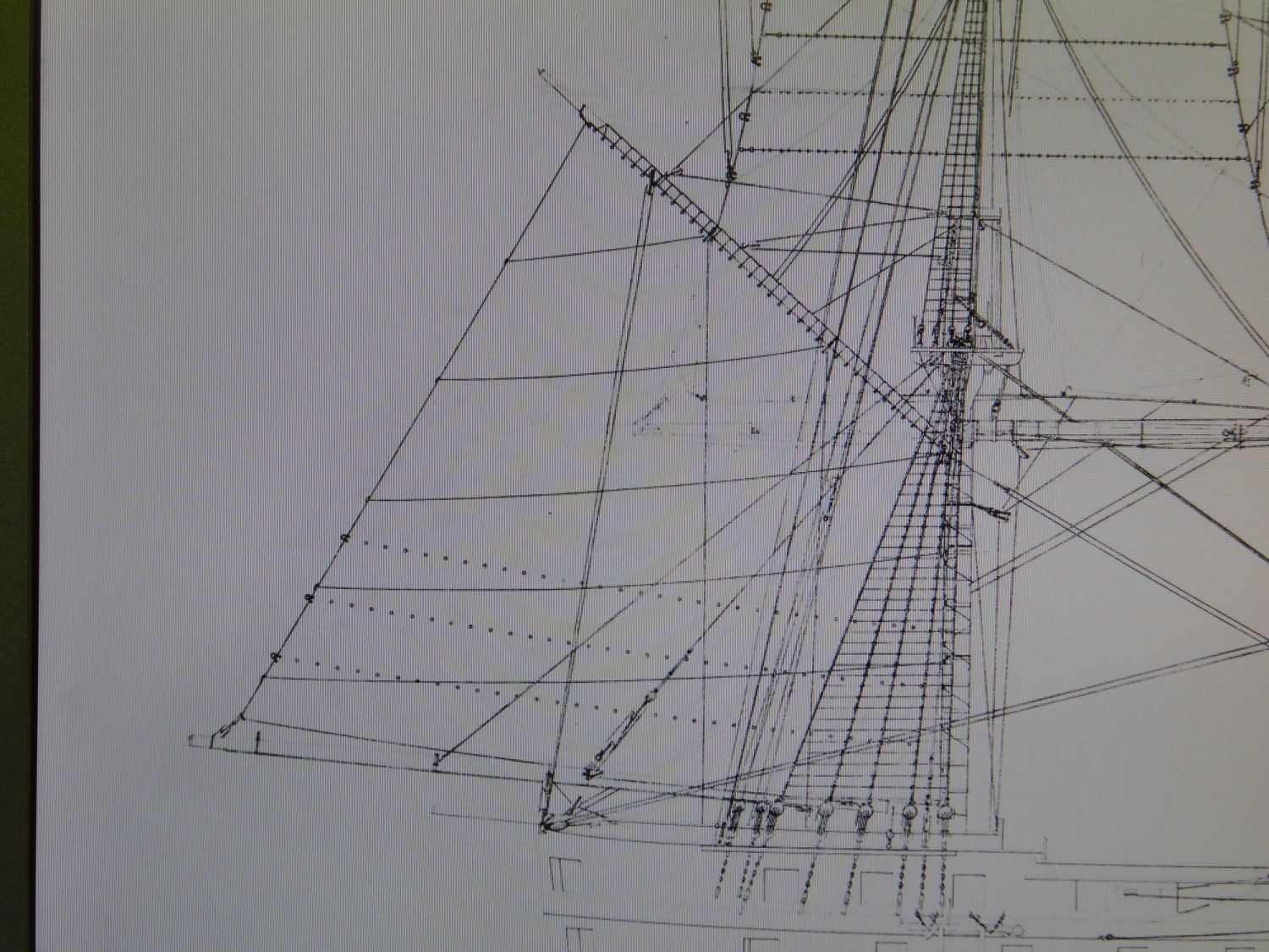

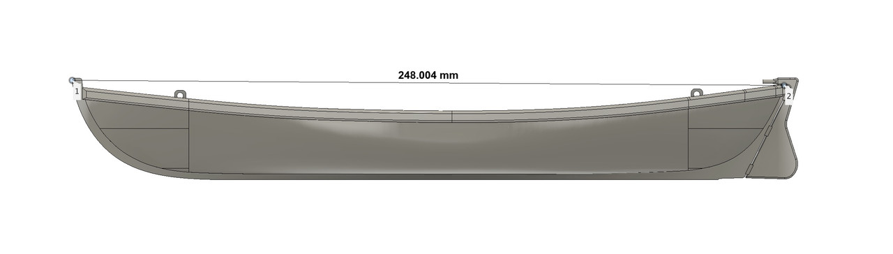

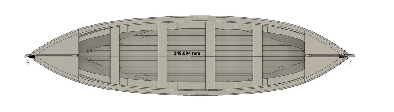

Hi Iceman
Thansk you--the Boatplans were helpful ( I have laid a selection of ( sailing masts ) Spars in the various boats
I tried to read the plans dimensions ( English/US plan ) for the whaler
but could not make out the length overall dimension
It looks --in my view... :cool_2: - beamy for a French whaler of the era--
according to images , paintings and the musee de marine model of that era

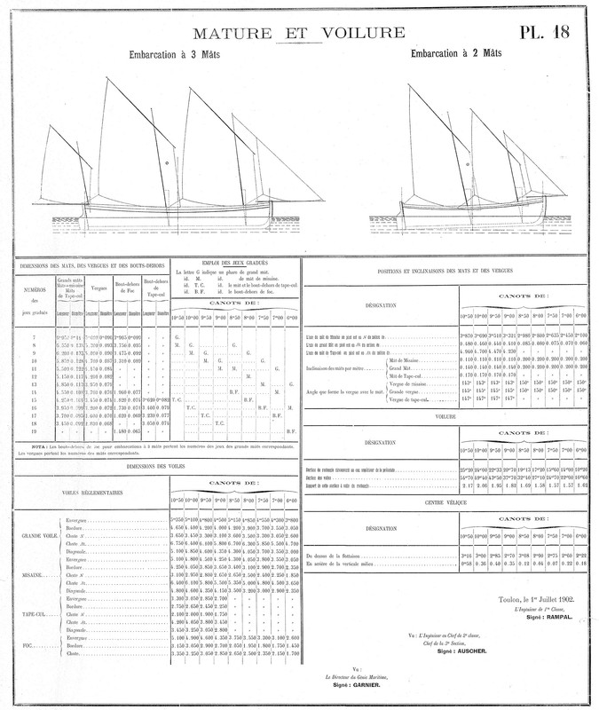

I had indeed changed the length/width ratio of the whaleboat, finding it too wide for a French model. I don't have a better definition of the whaleboat plan.
Some images at 1/200 scale:
I forgot to post this plan which might help you...
Clic 2 time to enlarge:

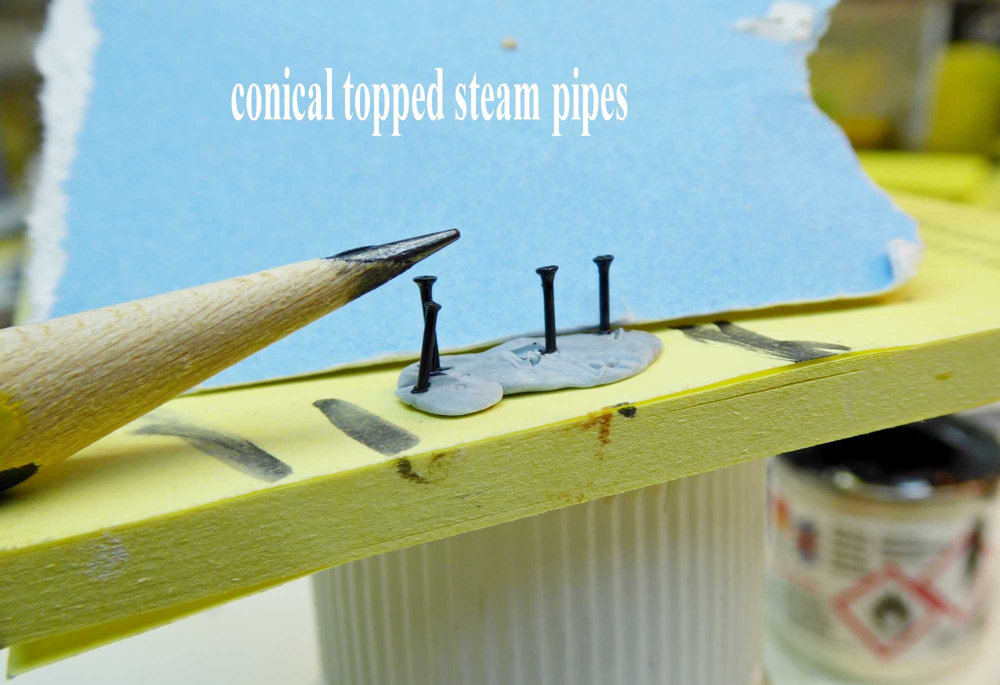

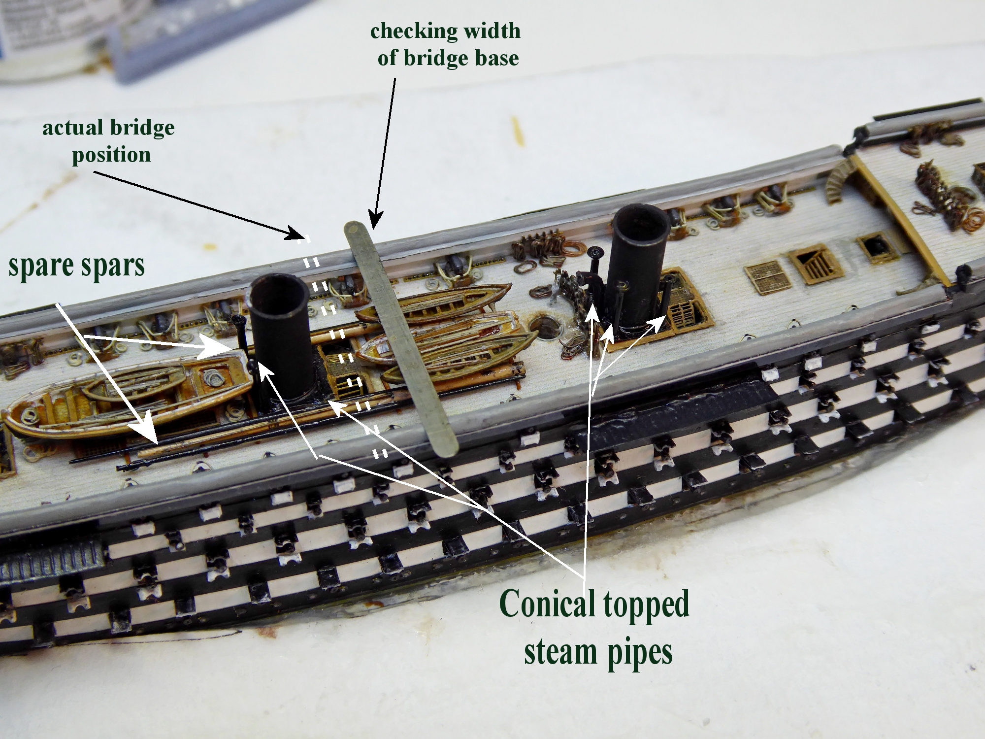

It was time to fit the remainder of the steam pipes to the fwd ( 3) and aft funnel (4)
these had a conical to shape I made them by pacing two small rings of copper wire ( one larger than the other)
and then in-filing the ' steps' with thinned white glue

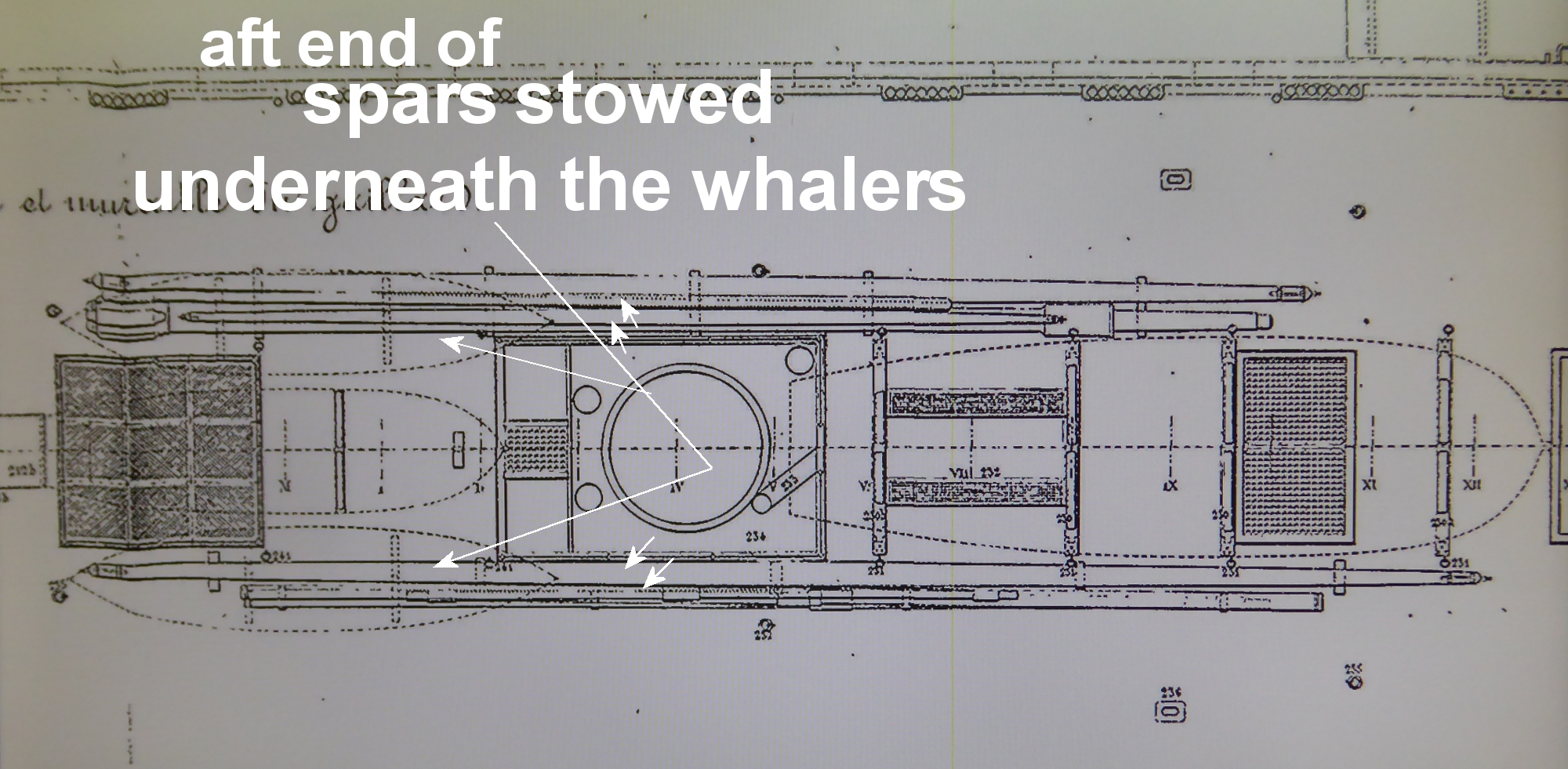

these ships carried a variety of spare spars ( shown in the plans )

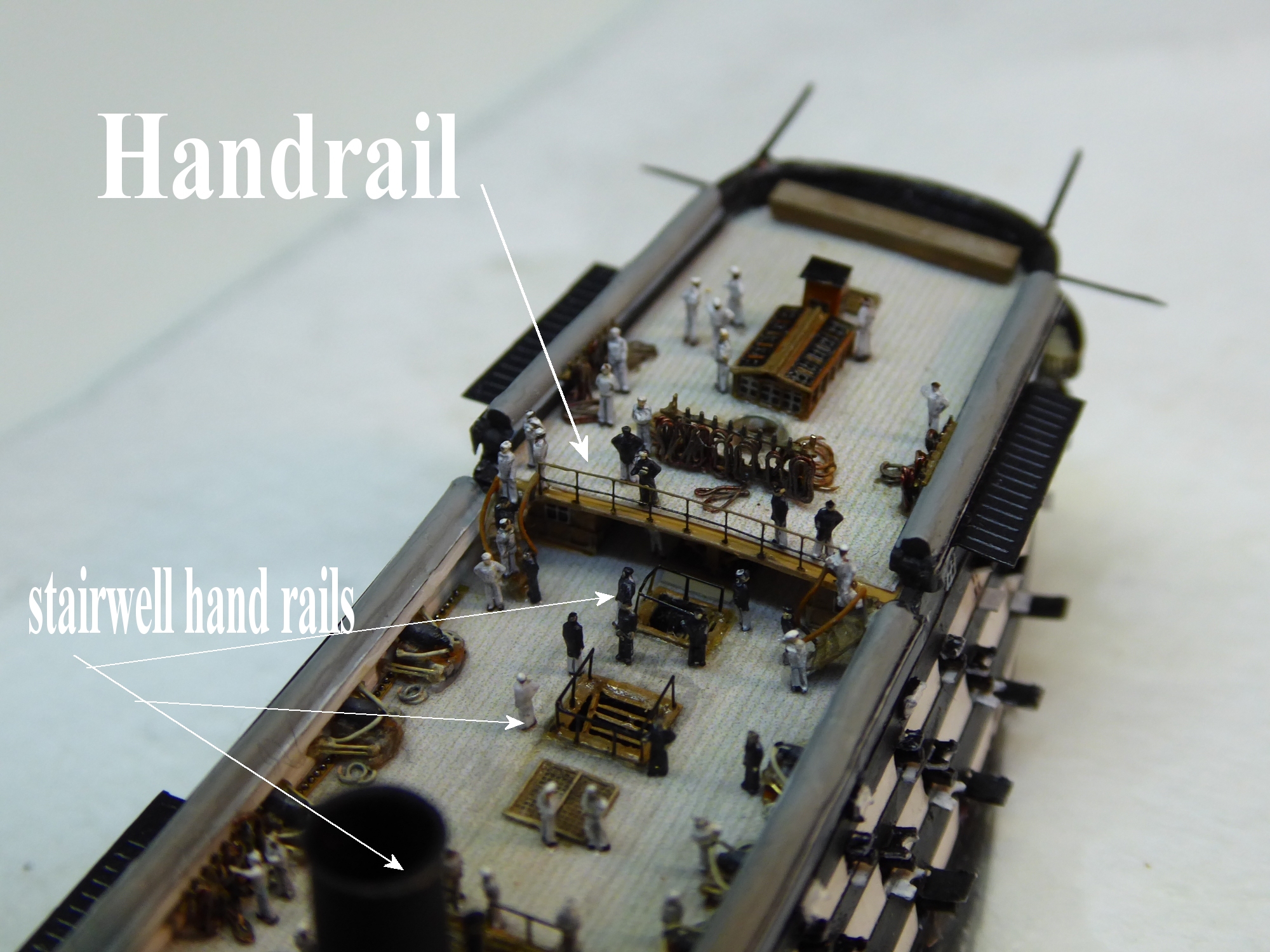

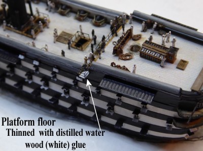

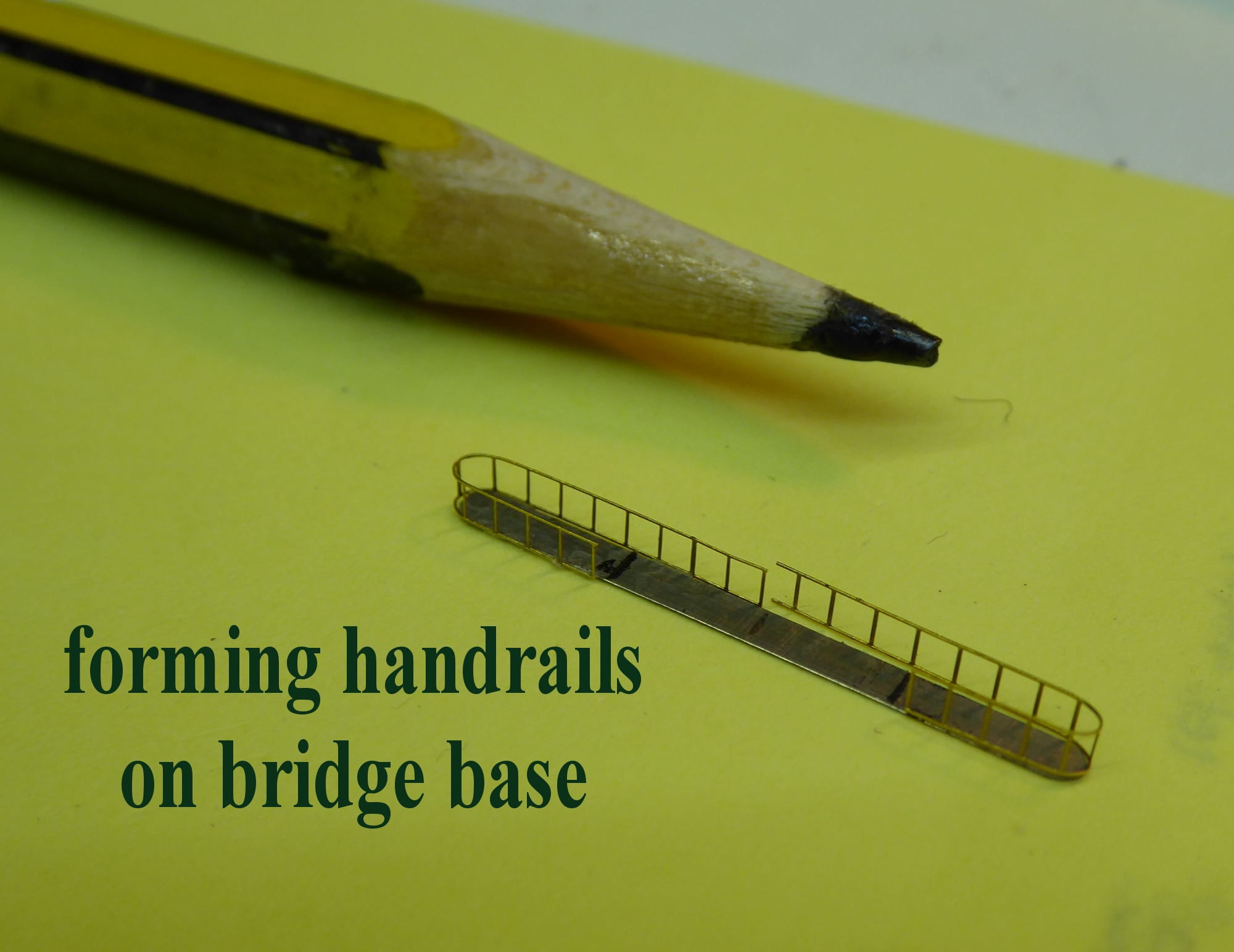

My bridge base deck was thin PE fret material suitably shaped

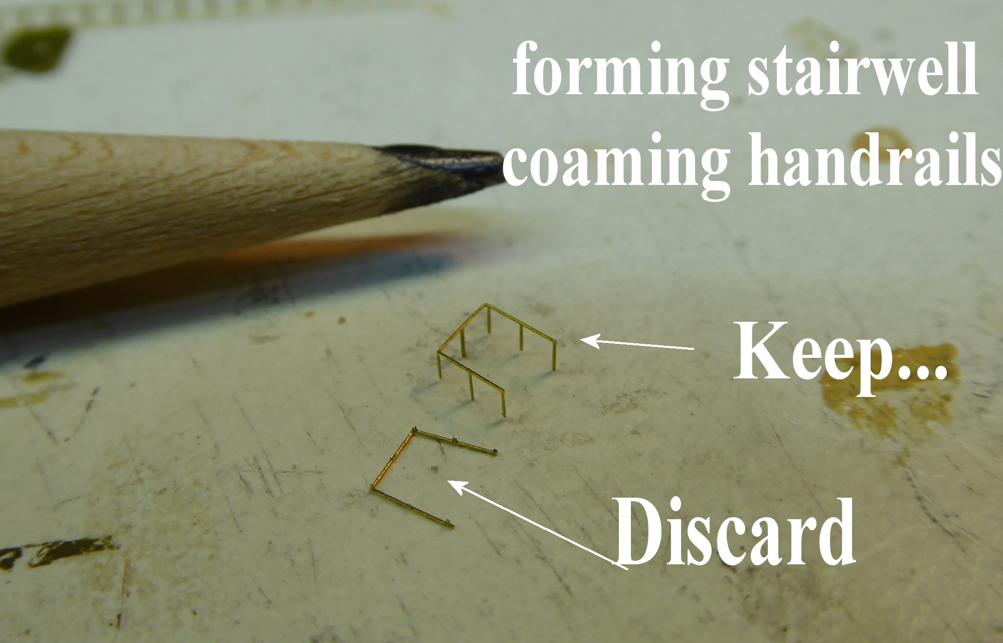

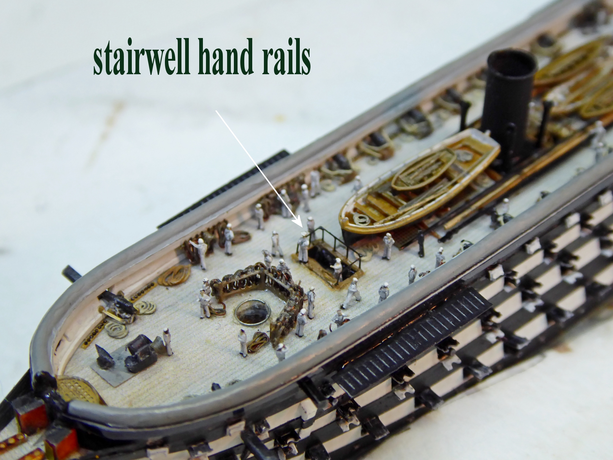

All the stairwells had a railing around them-- these had not bottom rail of course....
and installed they look like this

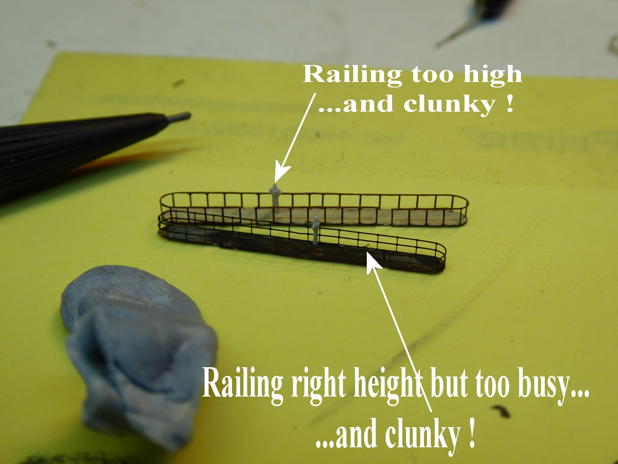

the bridge platform had railing installed
But I was not happy with it and have so far made 3 bridges-none of which I am happy with....!!! :Mad_6:
- have now found some GMM Gold plus superfine single bar rail
which will be in the next update !"

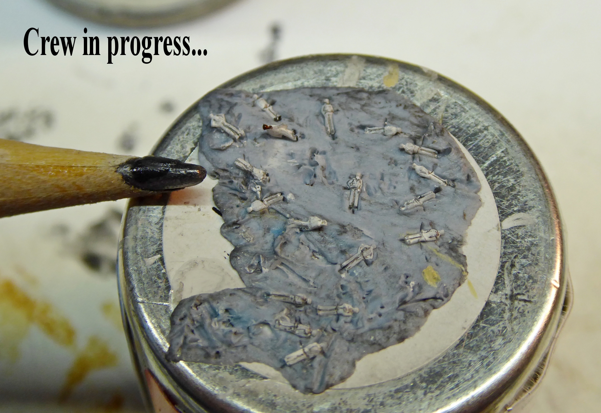

whilst I was littered with 400 odd figures
Black cat Models 3 D prints
these sailor fellows from Black Cat-( unlike some manufacturers somewhat overweight and ' round ' )
more closely resembled the fit and almost gaunt sailors in some old images (less obesity back then..)

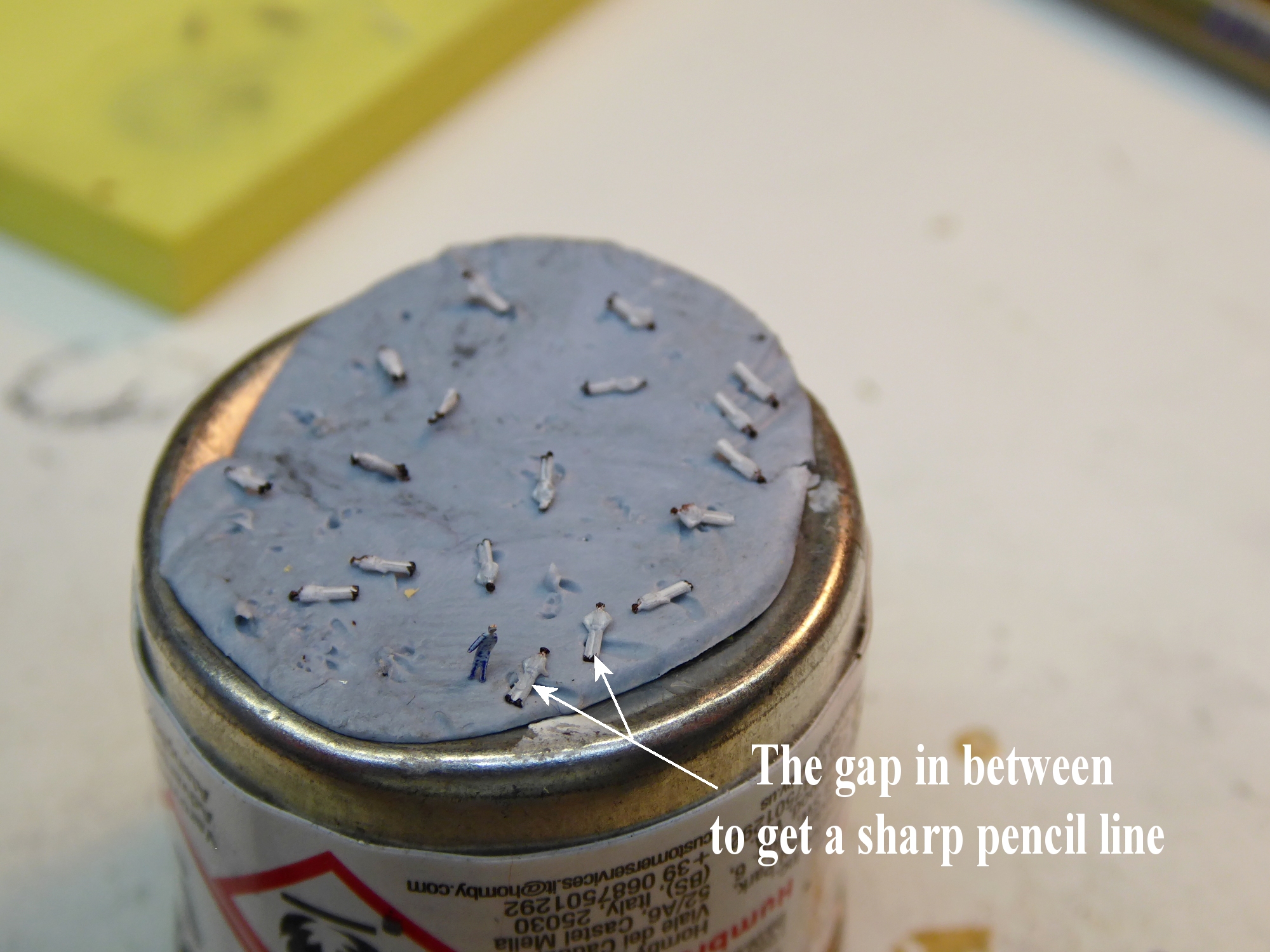

Painting sailor in white is harder than dark uniforms

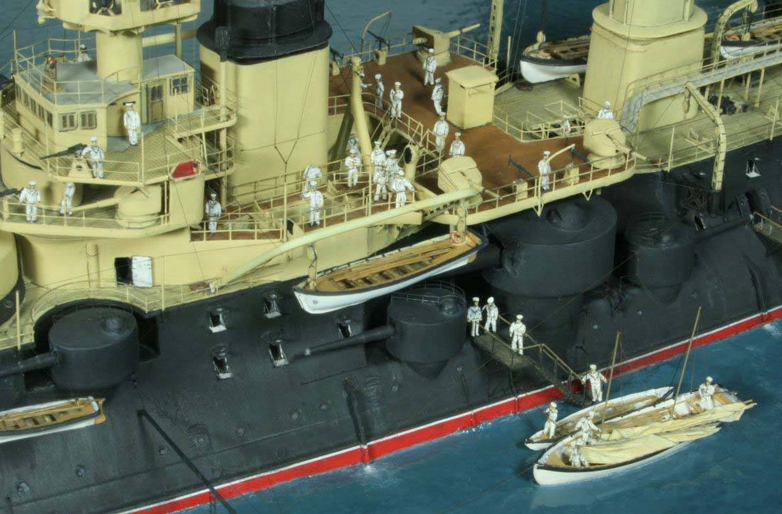

I based mine on my 1/350 sailors on my Bouvet--
using Pencil lines and graphite dust ( 4000 (!) grit sandpaper)
to give a sense of folds and demarcation from shadows
In 1/350 scale my matelots were quite sharp;

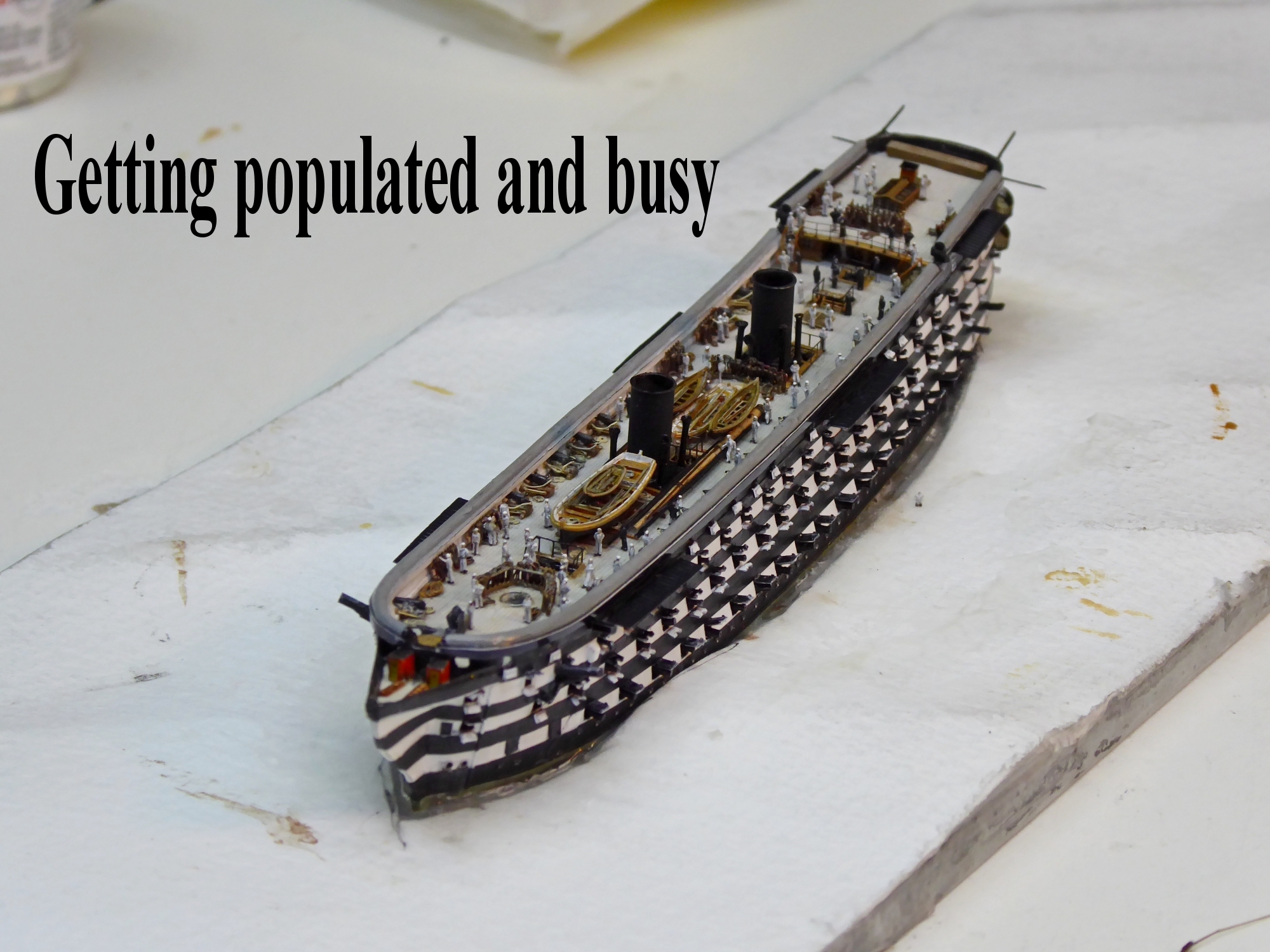

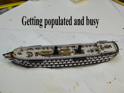

in half the size , unable to draw in things exactly--I merely wanted to suggest and impression that it was..!
overall and individually the little guys look pretty fine, being rather busy on deck tending the myriad of rope lines
that soon will be installed to the belaying pin rails midships and outboard on the coamings.

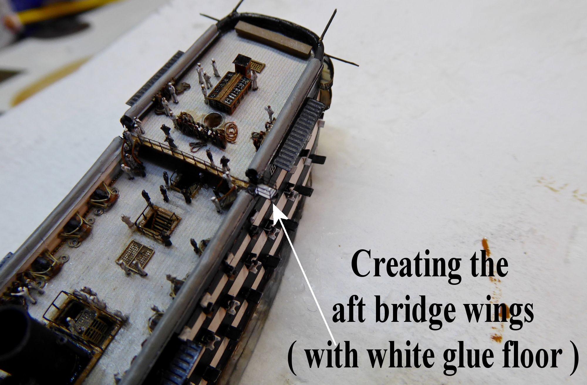

I also made the aft Bridge winglets, by making the rails FIRST and installed them.... and then spanning the bottom of the ( now painted ) railing with white glue--
this givers perfect colour demarcation as white -when dry glue is transparent--
after I had painted the UNDERSIDE of the platform dark beige wood ! :big_grin: :thumbs_up_1:

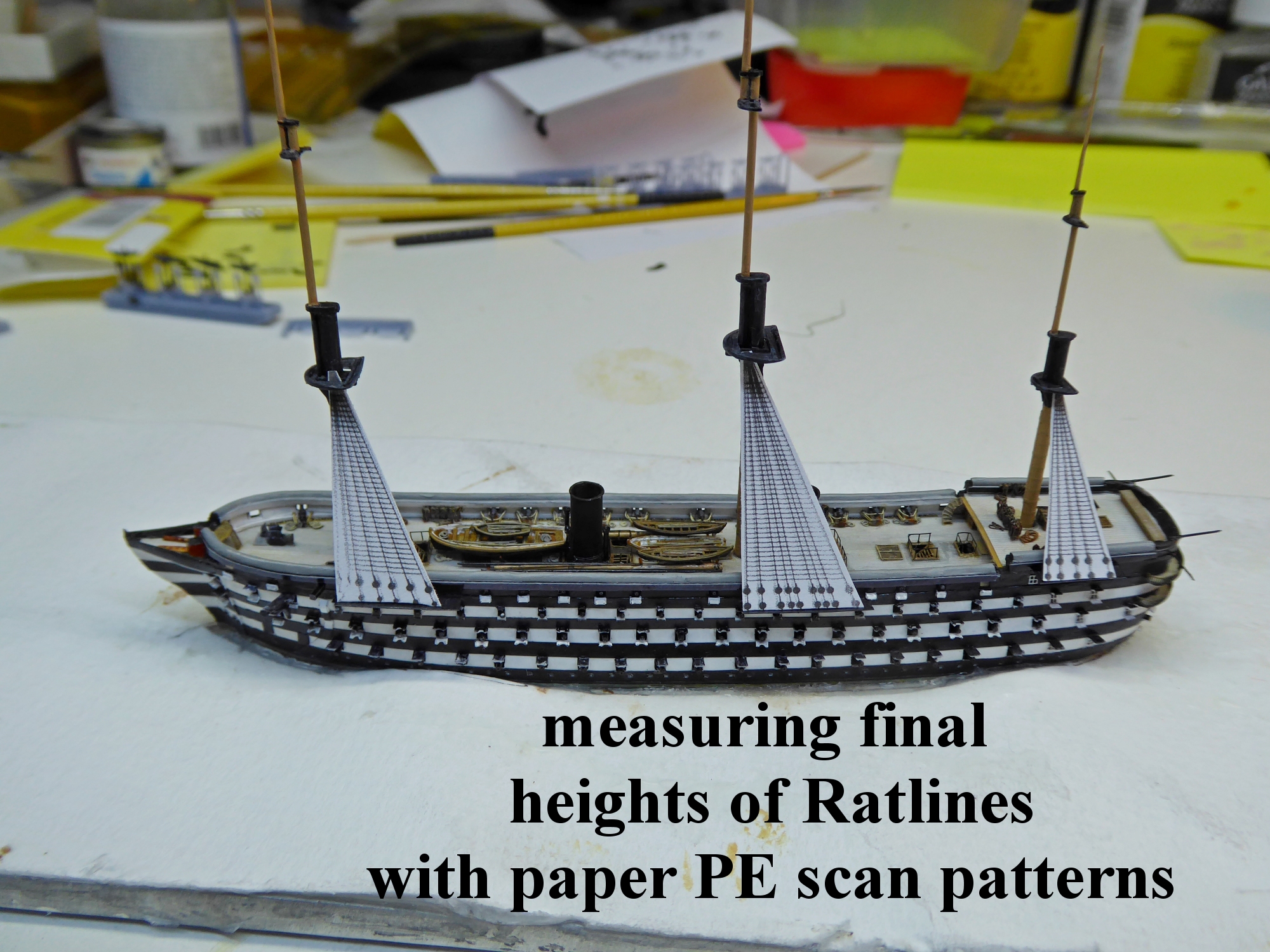

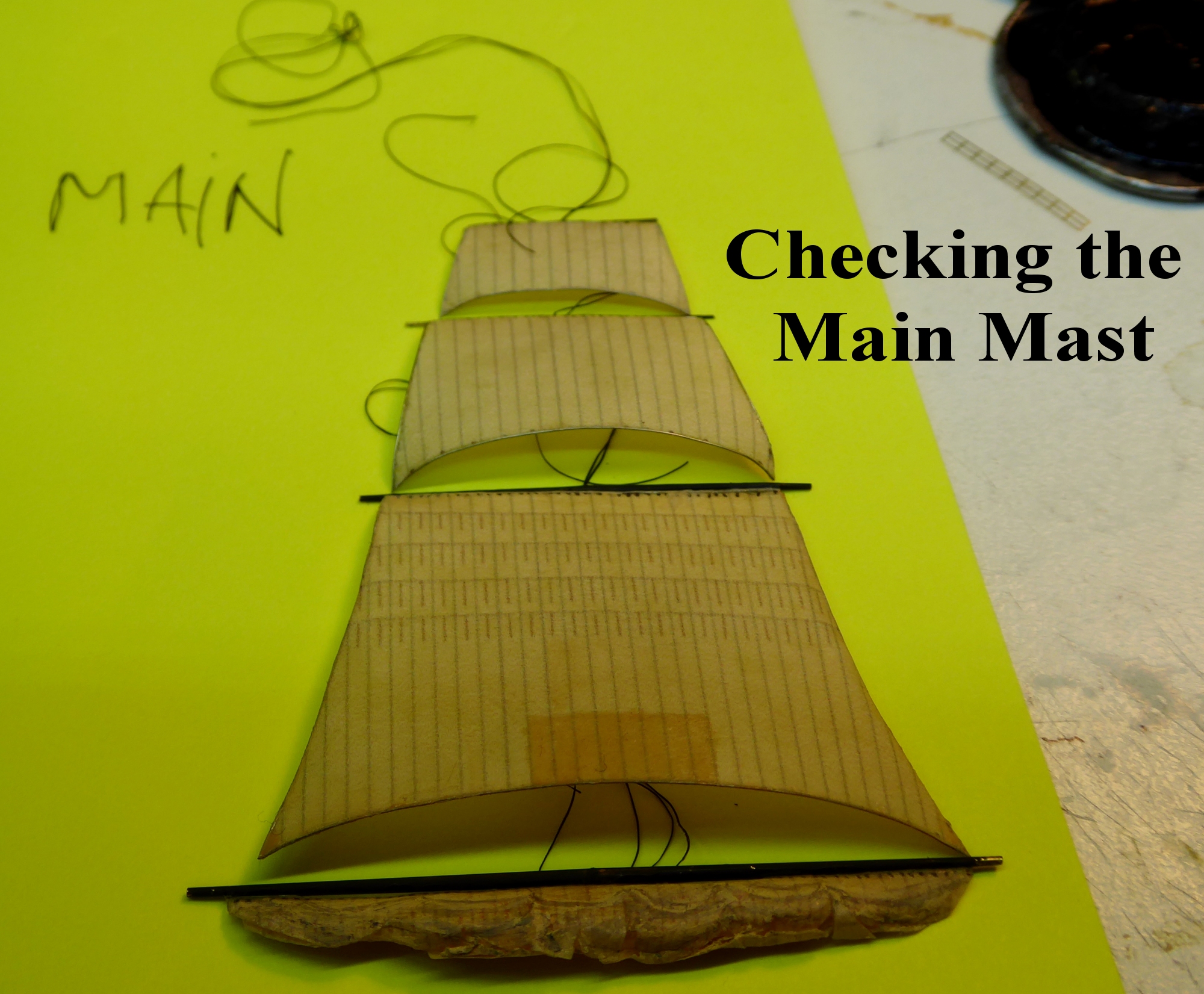

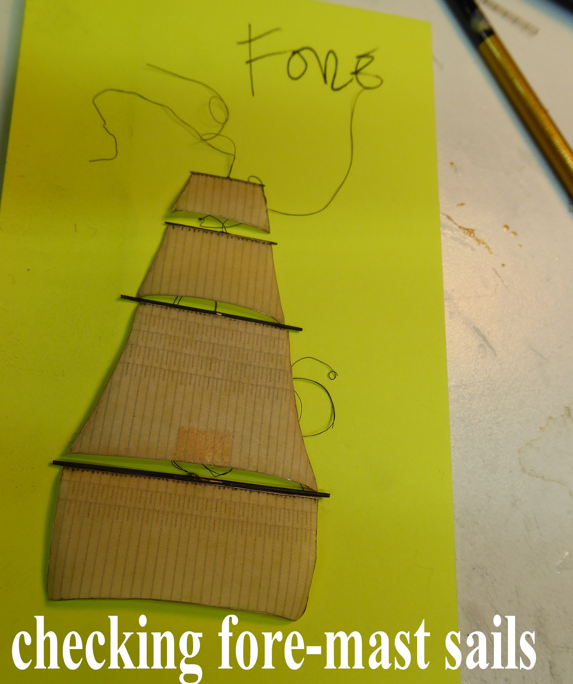

I was also getting ready to get masts installed--much fiddling around to ensure the ratlines would fit
( the ratlines are the right size )--so the 'floating' mast heights were adjusted in 0.5mm steps
I scanned the PE--and over-layed the PE on the printed scan--so I could use the paper templates to chekck everything.

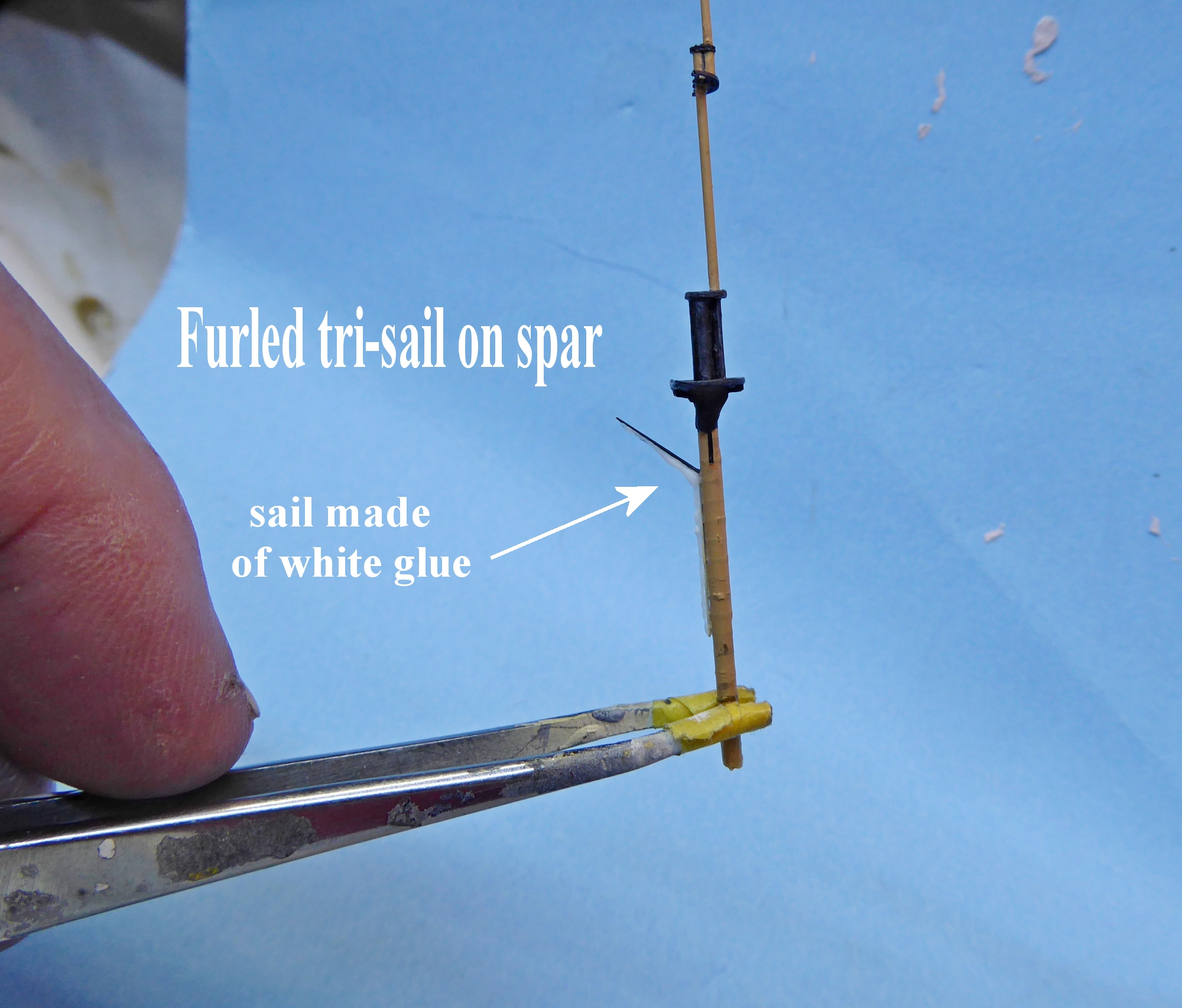

I made the furled tri-sails ( used only in very heavy weather) on the main and foremast
can be see here
and here

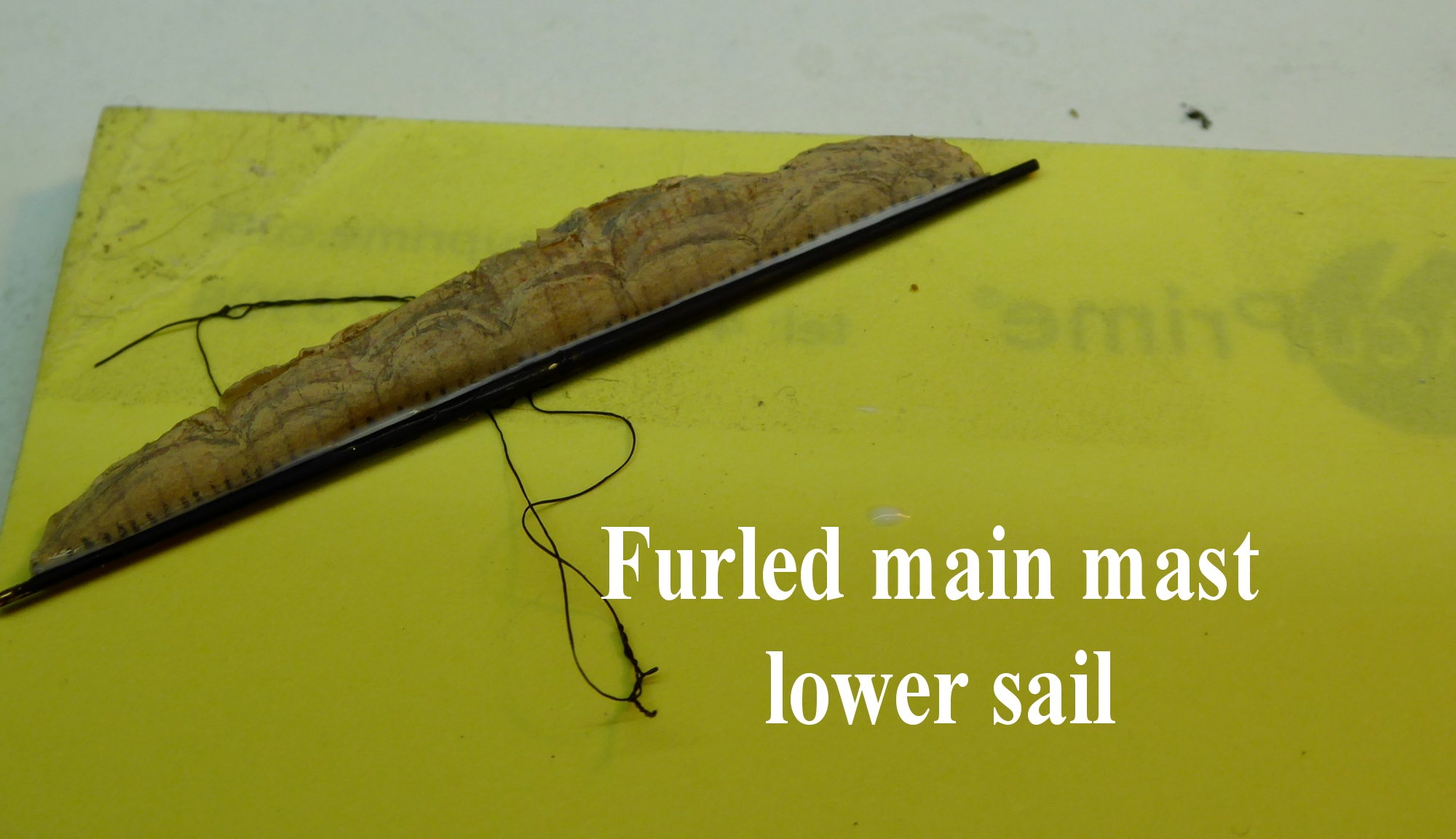

like this, using white glue applied with a brush
To ensure glue/ colour demarcation to the mast
I glued on first a small wire--making an easy sharp line :smallsmile:

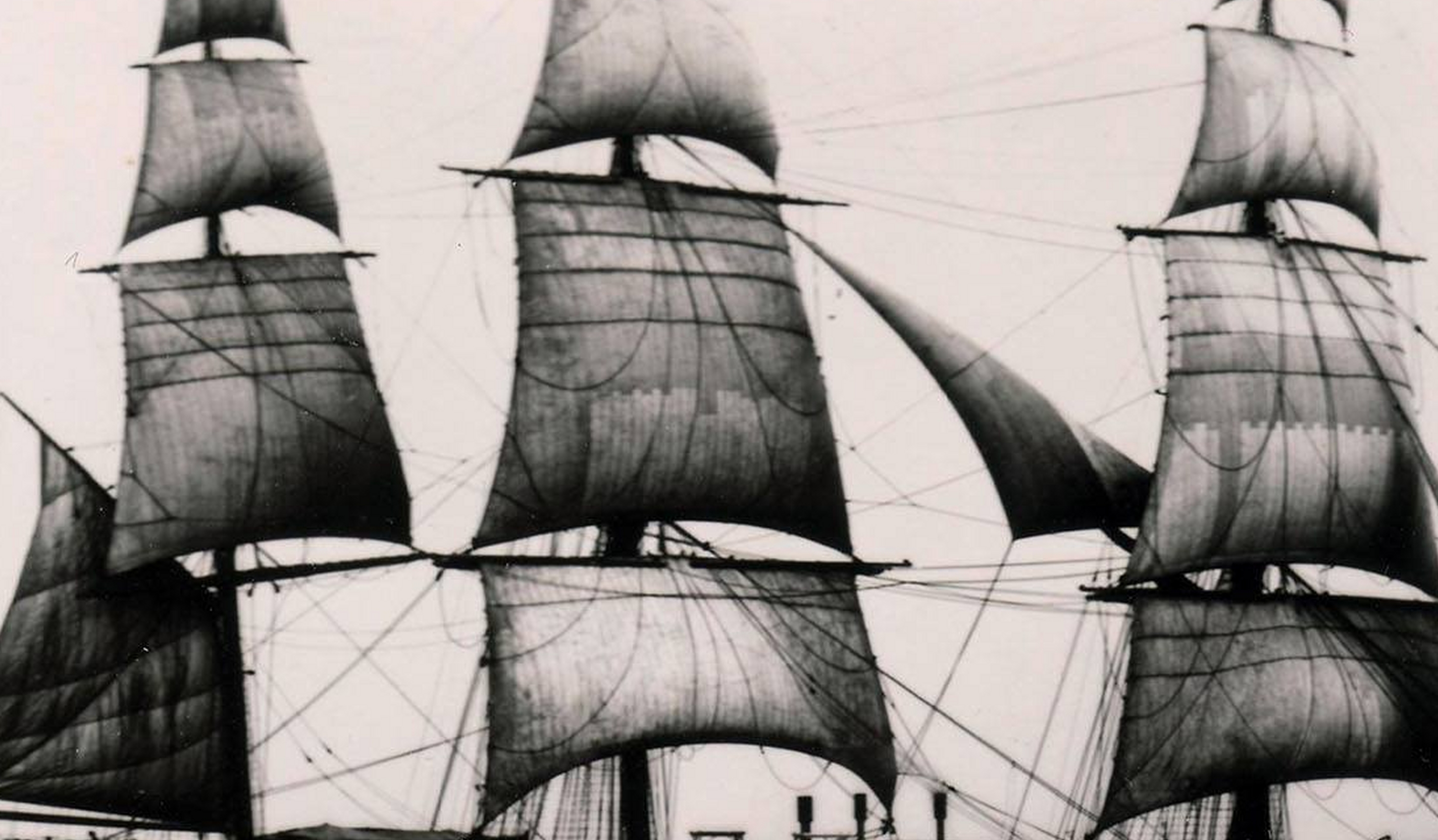

I moved back onto the sails, using this image below as my inspiration
The ship is French and a similar era, but importantly its on a broad reach in a decent breeze;
and well demonstrates French rigging practice.
it is rare to find photographs of ships of this era powering along under sail, usually they are standing still or drying their sails
37933957_1700362236750060_8659297377527529472_n.jpg [ 164.72 KiB | Viewed 467 times ]

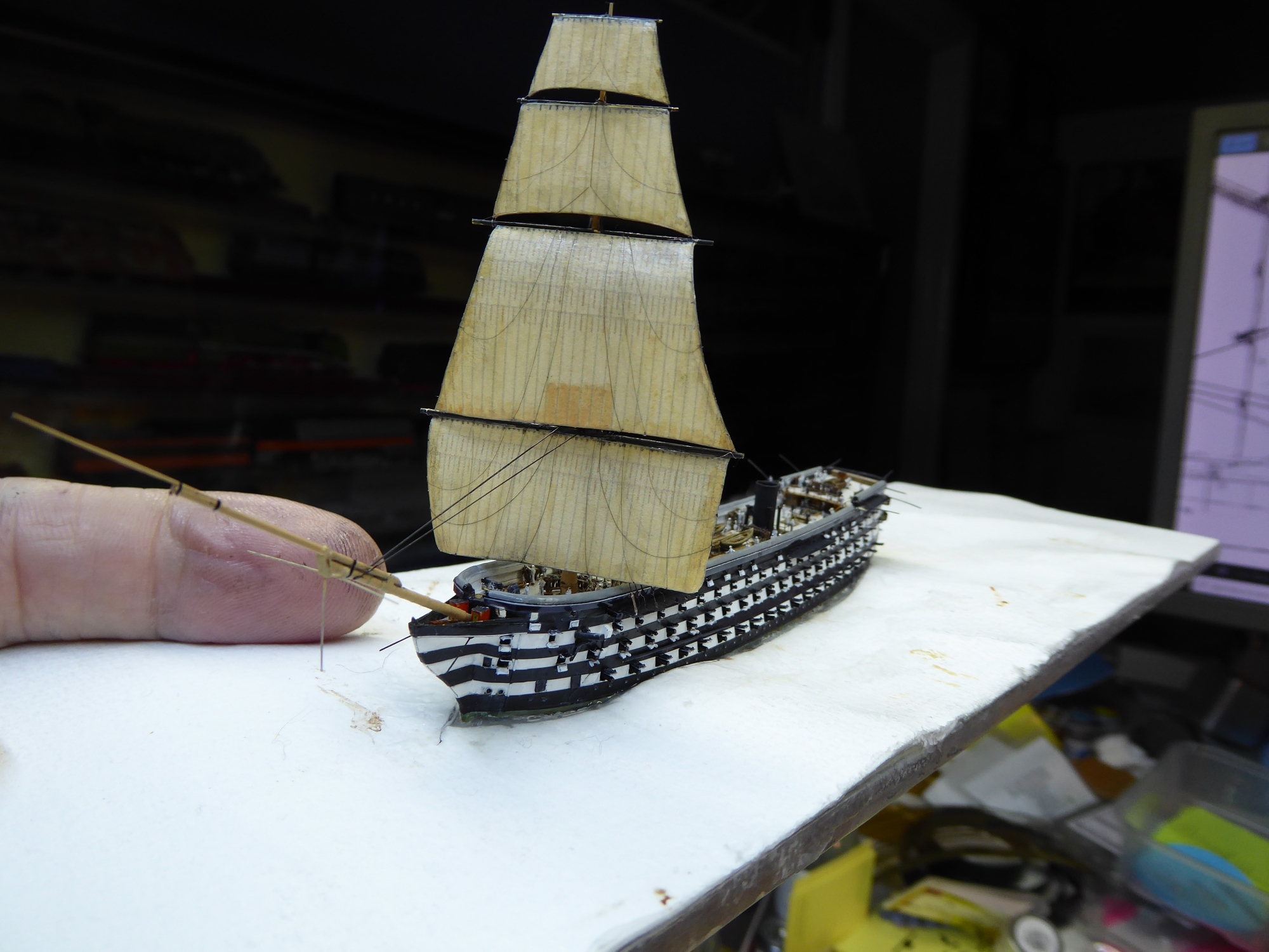

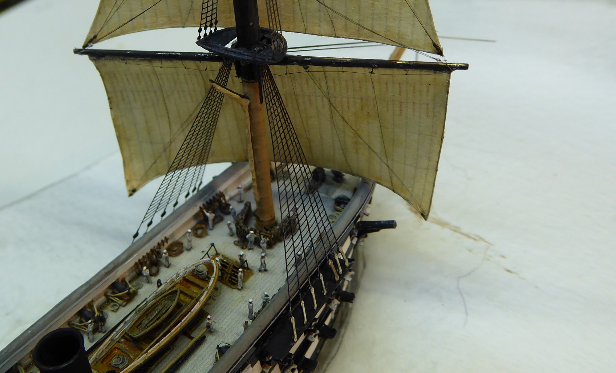

now just to emulate all those ( furling ) bunt lines and clew-lines etc !!
I chose to reef the lower main course sail so that the ( raised) Funnels would not interfere with the sail and the smoke
( with raised funnels 'my 'ship is getting steam up to go upwind on the next leg of the course
--ergo ' motorsailing ') :big_grin:

Wow! That's quite the update. She's really rounding into shape. Great work, as always.

How did you do the furled sails exactly? They vary so much based on various images, some have a lower center section sagging, whil eothers looks pretty uniformly rolled in. Did you furl a big sail or you preshaped it as furling an actual small sail will be too hard?
PostPosted: Thu Nov 21, 2024 12:11 pm
Posts: 5568
@ Pascal ( check you PM's ref Nomadic and e-mail me please jb yacht services @ gmail.com ) ( remove the gaps)
The furled sail was a hybrid!!
I cut the rough asymmetric shape ( they were rarely terribly neat if furled underway ) out of my pre-made sail so that the top row of reef lines would be visible, curled the bottom under, and crease it up a bit then set it with CA on the inside,
then cut a " back side " and curled it under and buttjoined it -the filled it with white glue
then painted the sagging crease shadows in back and front
still to be fitted with the bunt lines front and back that bisect the creases

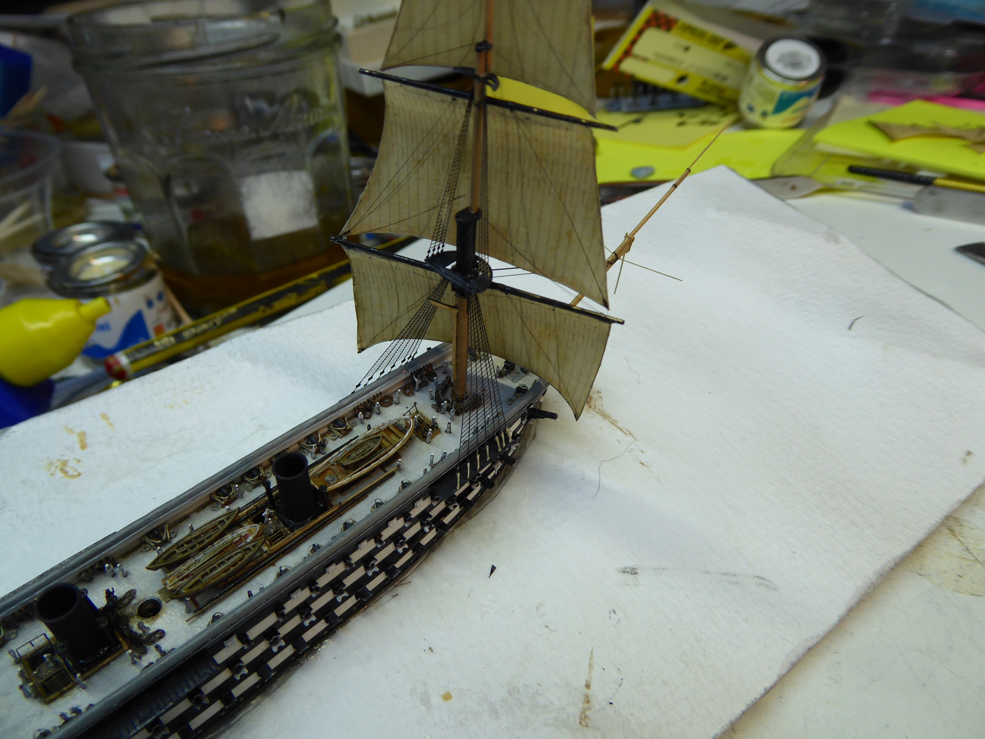

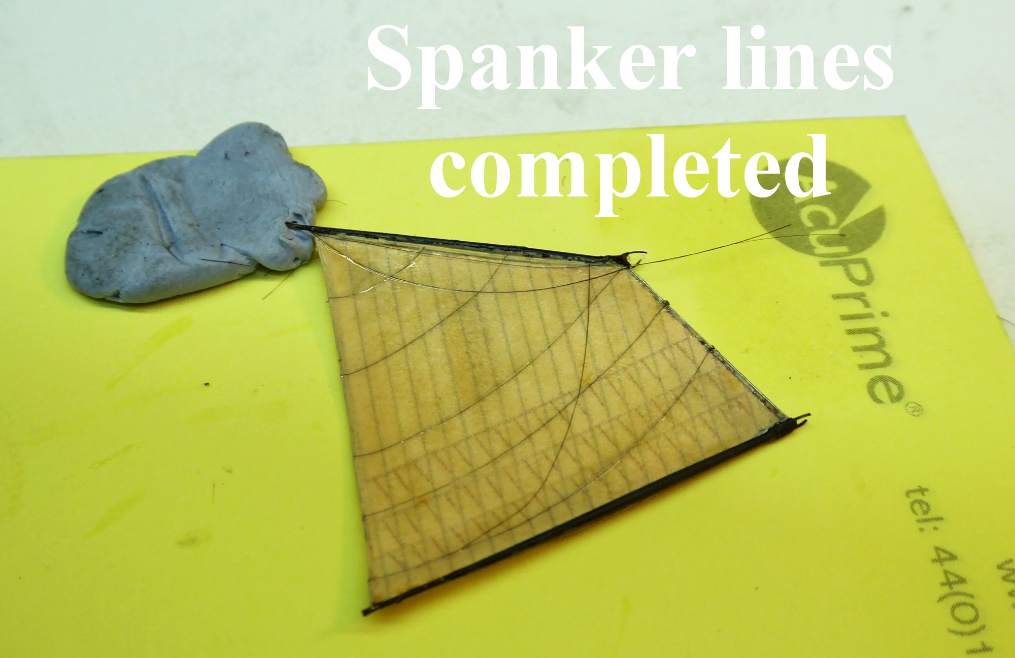

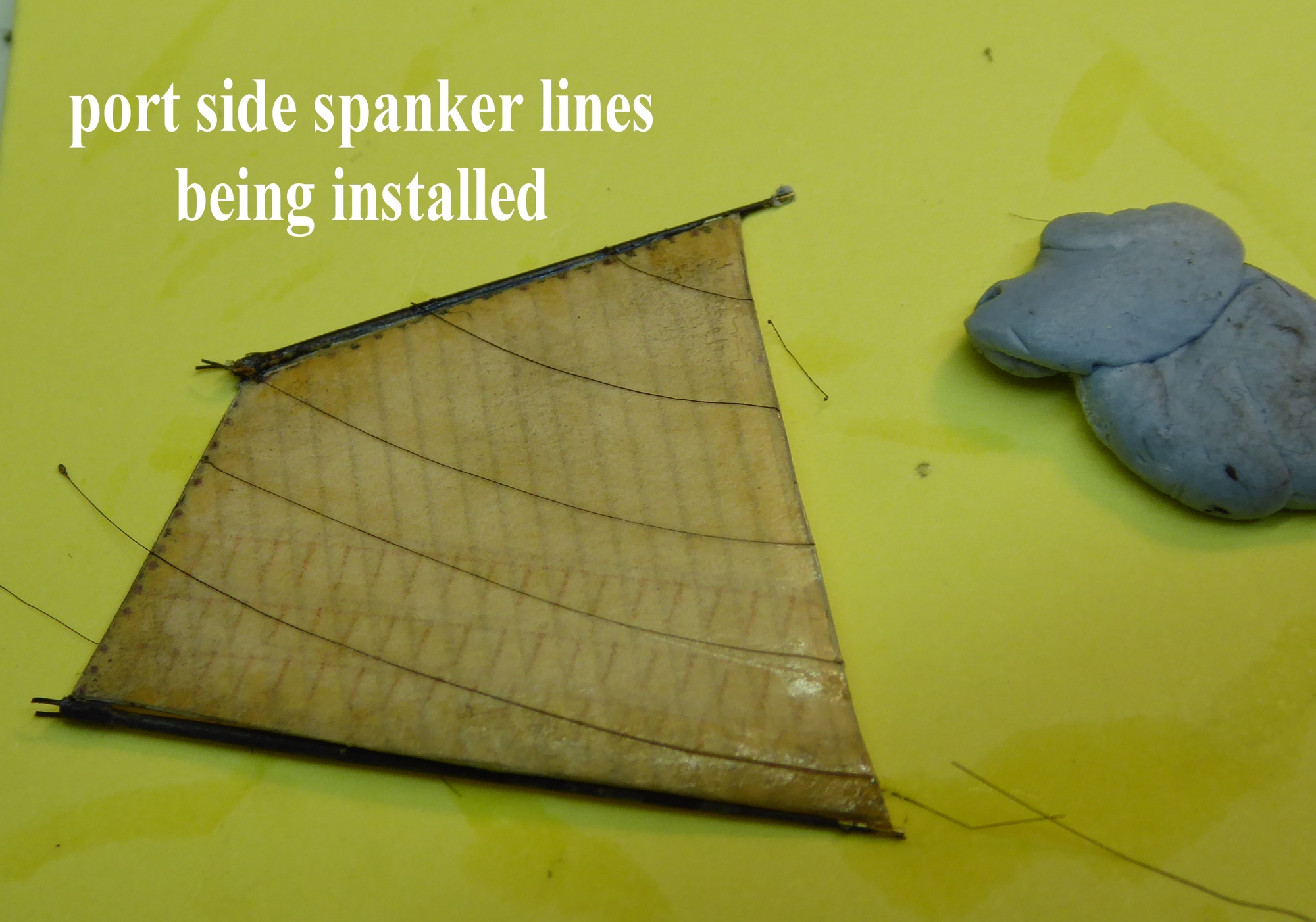

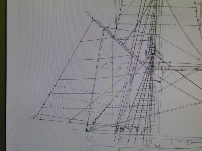

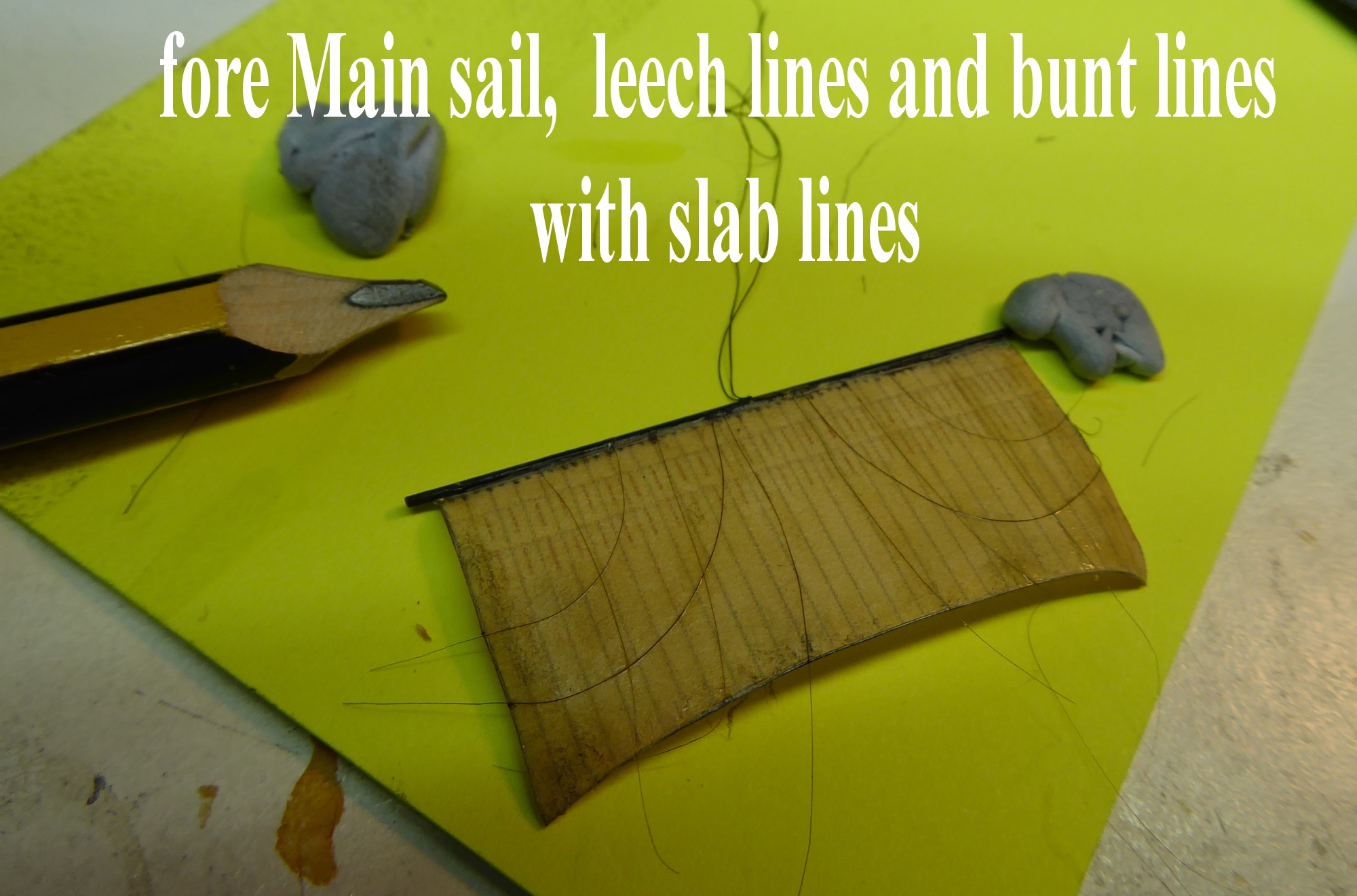

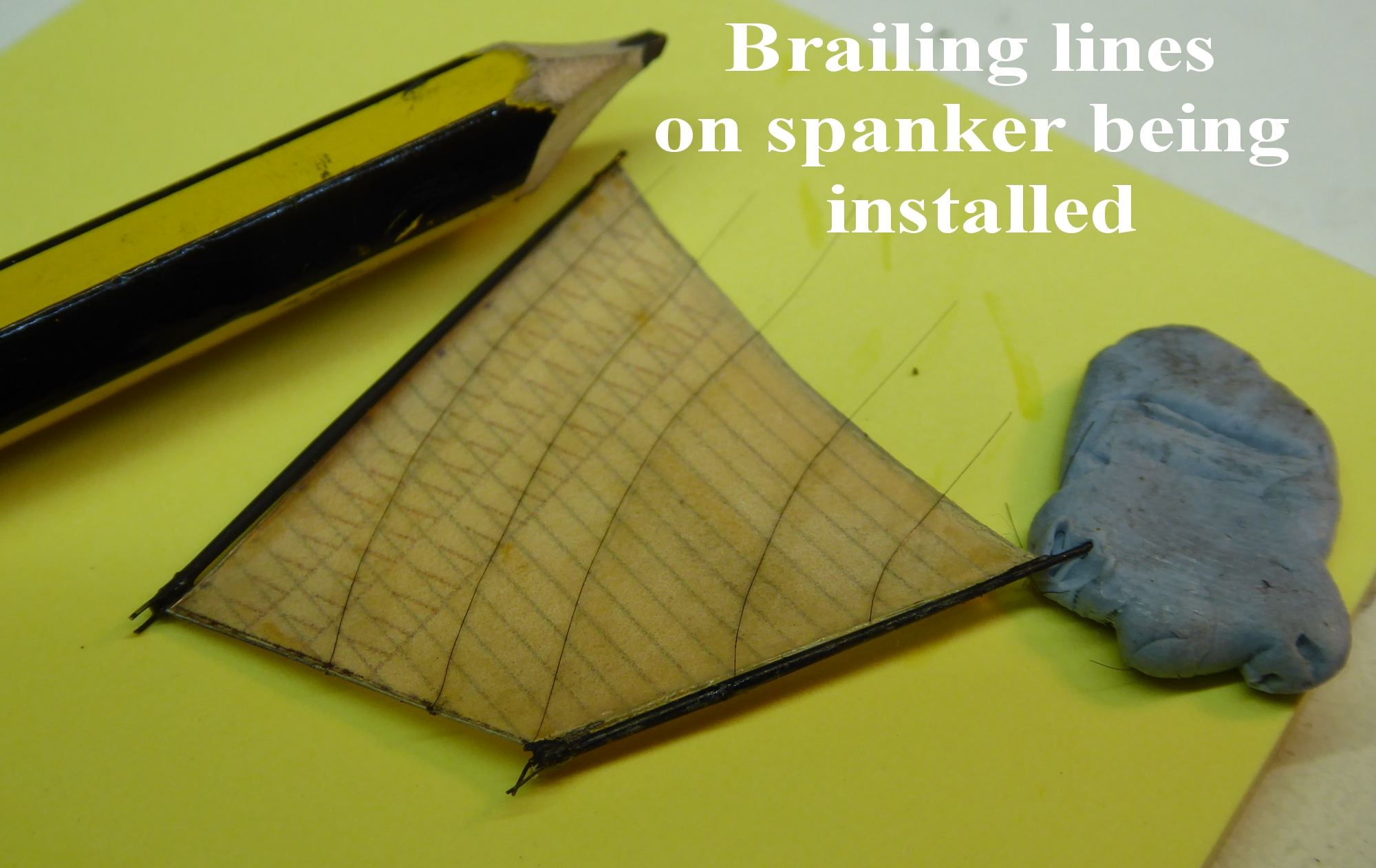

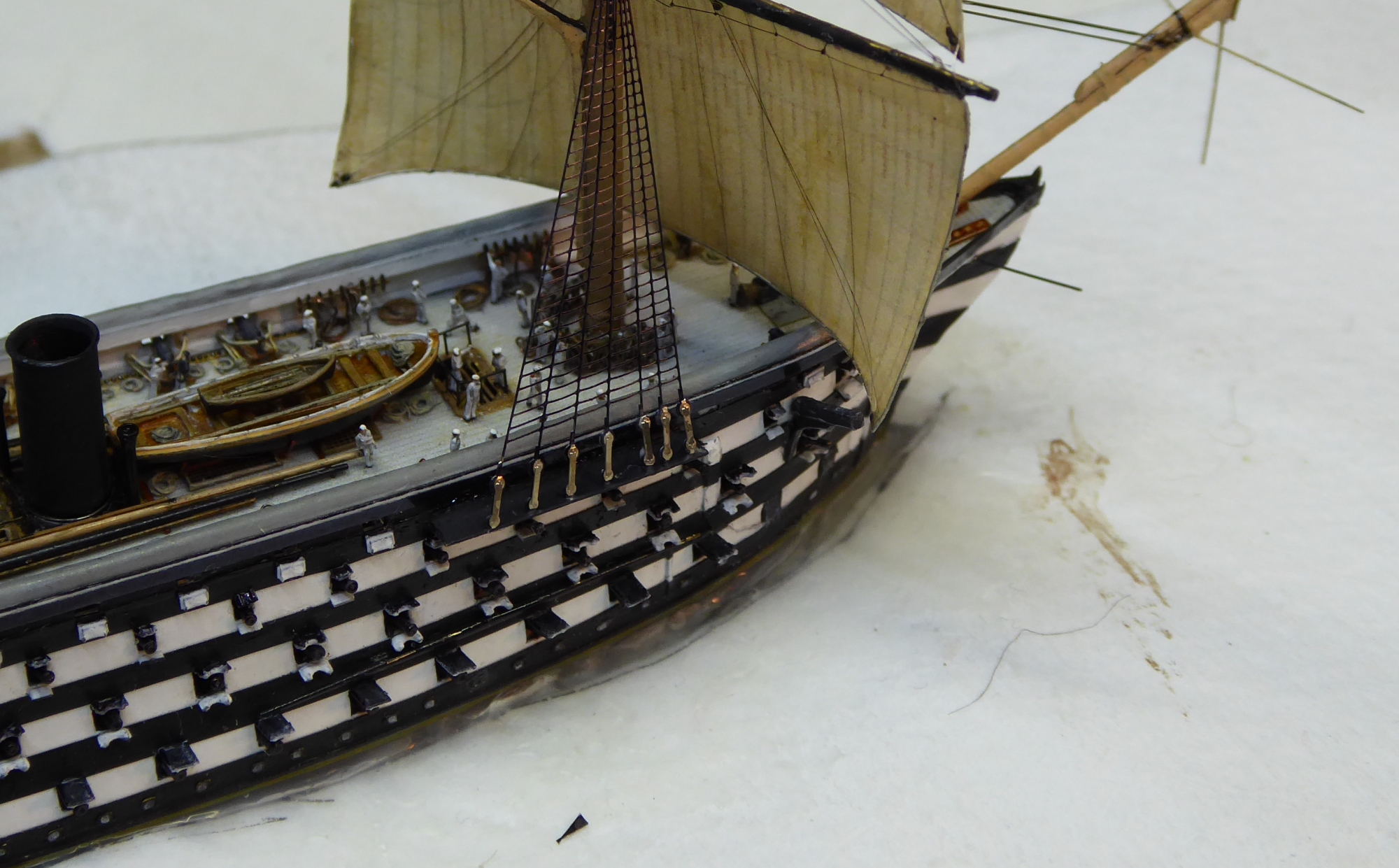

installing the various control lines to the sails according to the builders plans but also
in PHOTOGRAPHED evidence of French practice around that time
as here below
37933957_1700362236750060_8659297377527529472_n.jpg [ 164.72 KiB | Viewed 253 times ]
and closer in
aaaaaaaaaaaa 57_1700362236750060_8659297377527529472_n.jpg [ 1.22 MiB | Viewed 253 times ]

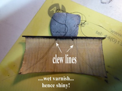

I used stretched sprue, dark grey-- installed with matt enamel varnish applied with fine brush-
-which allowed subtle 3-D curves to be formed on a 3-D sail to be formed with ease--
the varnish also inhibits accidental damage or movement

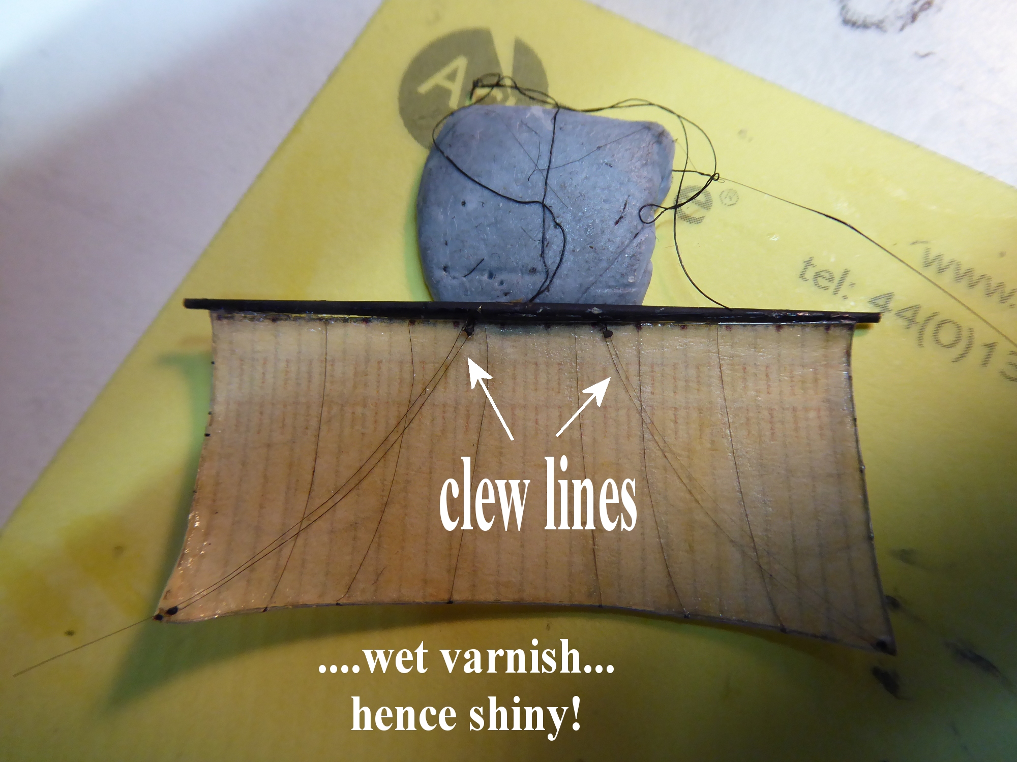

and more string, the clew lines which would remain pretty slack when sailing
(and often these get sucked on to the sail)

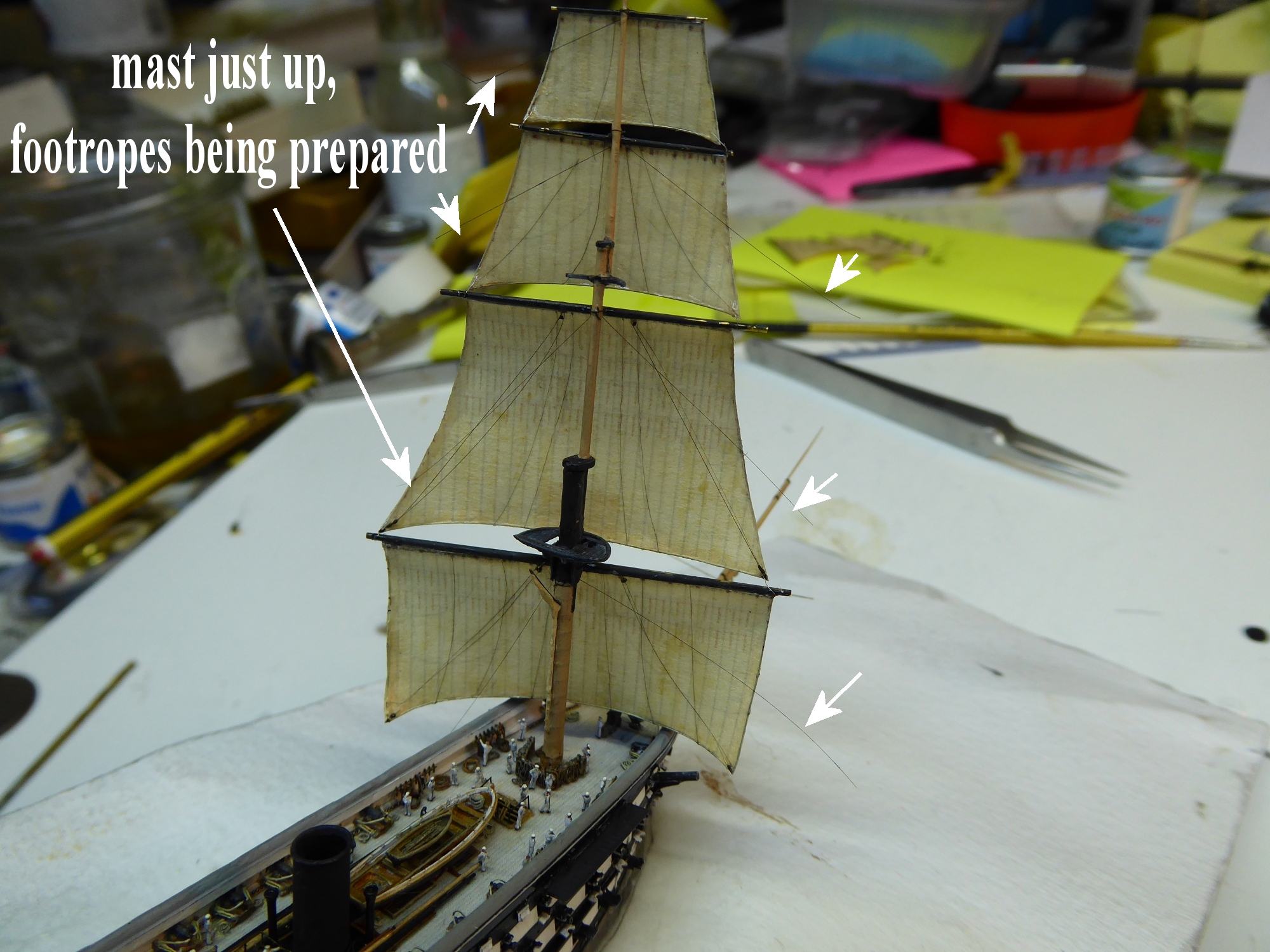

It had to happen eventually....
Masts up! ...actually--
On larger models it works well putting all masts up together, then the big preventer stays ;
and work from inside to outside with the rigging process ....
alas --in small 1/700 scales...-- our hands and tweezers stay the same 1:1 scale--
and working-room is at a premium ! :Mad_6: :Mad_5: :censored_2: :scratch:
I elected to work from FWD to AFT.
These ships carried vast amount of string; and to emulate the weight of ropes.--
-- it not possible to just use thicker lines to give the feel of weight of lines--
...one has to put on as much as possible
including all the tails and up and down hauls--down to the belaying pin rails
I want my model to look like this
HMS Marlborough- flagship of the Mediterranean fleet at anchor in the Grand Harbour of Valletta, Malta, sometime between 1858 and 1864..jpg
HMS Marlborough- flagship of the Mediterranean fleet at anchor in the Grand Harbour of Valletta, Malta, sometime between 1858 and 1864..jpg [ 263.61 KiB | Viewed 253 times ]
and this
and this
-- most of the rigging work is 'aft of the sails--thereby working from fwd -to aft I stood a chance of adding the footropes, halyards lifts etc rigging ,
and ratlines without knocking anything off
its tricky--to keep everything thin
- the images below show mast up, ratlines being attached and a work in progress

The subtle weathering and shading of the ratlines + the exquisite sails, what a joy to see this build compete wtih marijn van gils diorama. thanks gents for such quality content lately.
PostPosted: Wed Nov 27, 2024 1:06 pm
Posts: 301
Exquisite work! Getting better and better :thumbs_up_1:
