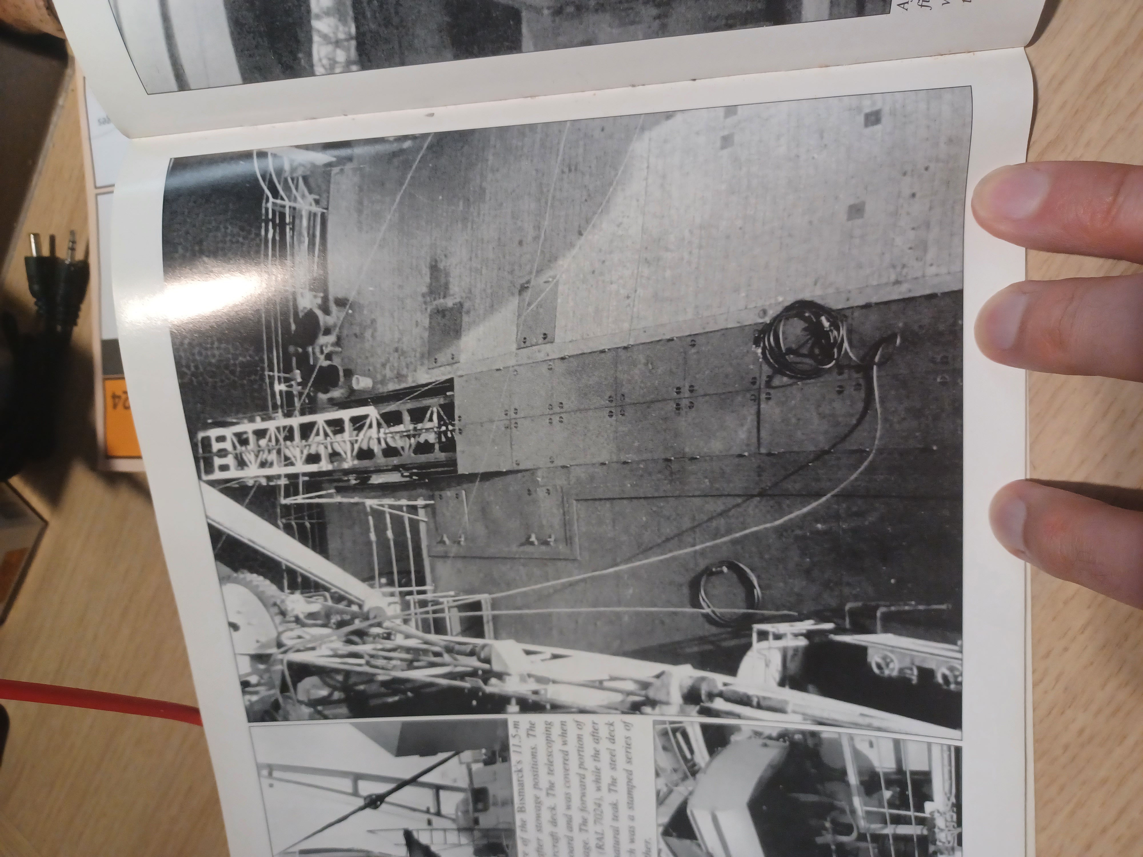

Which books do you have? I used this one and found it useful. I believe the rails would be extended only when the hangar was open.
