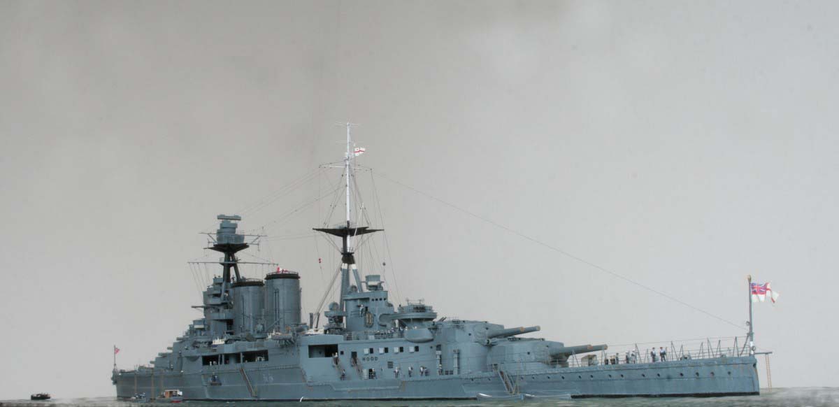

On of my favourite Hood models to date, full of atmosphere...
is this 1/350 offering from my friend Nick Dogger
link http://www.modelshipgallery.com/gallery ... /index.htm
and an inspiring image!

Thank you very much for sharing Mr Nick Dogger’s build, that’s sure a beauty. Doing a diorama is something I would love to do for the hopefully coming models.
I think I should widen my view a bit since I more or less only have looked at other 1/200 builds thus far. There are quite some great 1/350 builds as well worth looking up.
