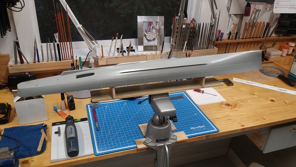

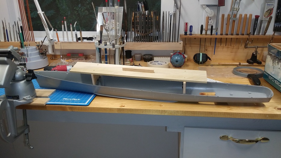

09/02/20 - Now that my workshop is fairly complete I will be able to begin the STODDARD build in earnest. Tonight I built a wooden jig to hold the hull upside down while I make the necessary penetrations & openings for intakes, discharges, and SONAR dome, etc.

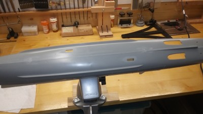

09/03/20 - This evening I measured the 2 salt water condenser intakes, located them, and cut out the basic openings.

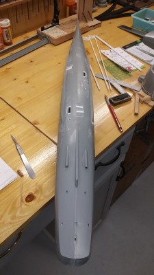

OK, I'm winding down on the bottom of the hull penetration work, with mostly double checking the dockyard plan for DD-628 (USS WREN) to make sure I'm on track. I will build the salt water intakes once the wooden cradle is temporarily removed and I have access to the inside of the hull. I've gotten the two shaft alley pieces in place and will putty them tomorrow. So, here's the hull:
(the parts taped on the hull are for the salt water intake boxes) I have not yet begun to sand with very fine emery paper (crocus paper) to smooth out the surface of the hull.
I've just taken stock of my 3D parts and what has and has not been cured under the UV lamp. Since these have all been sitting in their shipping bubble wrap for the last 2 years, some of them are yellow, some white, some about the same. I'm guessing they're all still good - I'd hate to have to buy new ones all over again. :doh_1:
Note: Using the 1952 Charleston, SC shipyard DryDock Plan for USS WREN (DD-568), my hull penetrations may not be identical to those that Willie has drilled into his hull. Close, but not identical.

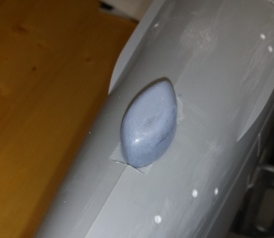

The last couple days have been correspondance with Rick E. Davis regarding SONAR domes, FLETCHER class DD's, and what these pieces of exterior equipment looked like, etc. We both found an illustration which more than likely was the appropriate dome and after a call to one of my former shipmates, who JUST happened to be an S03 during our cruise, was able to correctly locate the dome on the bottom of the hull (STODDARD's unit was located on the centerline of the ship, not to one side). So, last night and today I created the SQS-4 dome out of basswood and after some final dimensional corrections today, came up with the final version which is thus:
Tomorrow evening I'll putty the base of the dome & hull area and once it has set up, shape it to the proper contours, etc.
After a double check of all my bottom of hull openings I'll then remove the cradle and construct the insides of the salt water intakes in order to complete their assembly (has to be done from the inside of the hull).

BB62vet wrote:
(...) I created the SQS-4 dome out of basswood and after some final dimensional corrections today, came up with the final version (...)
Again a very good solution, that makes me wonder (a) what picture you are talking about, and (b) if this is the sonar dome that I have to build for my Jorge Juan as well. If Mr. Davis is reading this and if he would like to lend a (further) hand, his expertise would be as always more than welcome.
I suppose we are talking about this sonar (USS Cassing Young, I think, but I am not sure):
The shape seems to be the same, but the position seems to be way more forward than in USS Stoddard. And Hank, if it happened that I have to build the same sonar, and you wanted to give the the measures of yours, I would really appreciate it.
Keep the good job, and very best regards from this side,
Willie.

Willie wrote:
Willie,
Over the last several days I have been in contact with Rick E. Davis and a fellow shipmate (SONARMan) whom I served with in order to pin down some info that up to this point evaded me as to the correct SONAR dome that STODDARD had installed when I was aboard. So, Rick has provided me with a couple photos of the later SQS-4 SONAR dome as was fitted in 1956 on STODDARD. It was further updated in 1959 with new components, but the dome remained the same. I will email you these photos so you can see them better than posting them here. Determining the exact size is a bit tricky - we do know that dome was 185" long from fore to aft and located centerline on the hull. You'll see this in the photos. I have some further shaping work to do on my model's dome in order to make it as accurate as possible, esp. after seeing the photos myself. This is the same dome as shown on the photo you included of CASSIN YOUNG.
We also found online a good simple illustration of a typical SONAR dome which more than likely was like the one installed. However, there were no dimensions, so that took a bit of guesswork on our part and some math to come up with 3 dimensions when only one is known.
I am sending you an email with photos and further info regarding what we've come up with and so forth.
10PM Edit - However, the 2nd photo I sent you shows a tape measure and I've explained in my email how I arrived at the dimension for the overall depth of the dome. I've adjusted the sizes given for your ship due to the shorter dome length. All in millimeters (mm). Lastly, my former shipmate and Rick seem to think that the domes are the same color as the hull, and I tend to agree. I just checked my photos from the 2019 Norfolk harbor cruise where I got pix of an ARLEIGH BURKE DD in drydock. the SONAR dome was red all the way down to the plastic sheeting covering the dome which tells me it's all red. So, that's my story and I'm sticking to it :big_grin:
PostPosted: Thu Oct 01, 2020 9:15 pm
Posts: 5060
Hank:
From the photo you sent me the dome looks at the same position as on Cassin Young if the bilge keel on the kit is correctly located. I have the Alan Raven Fletcher AOS book and (amazingly) there is not hint one that the ship had any sonar dome at all. Did the model kit have one? Out of sight out of mind I guess!
Looking good! Cheers: Tom
