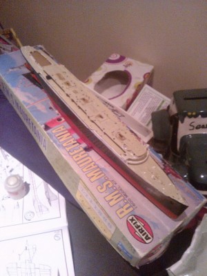

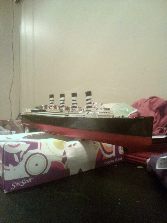

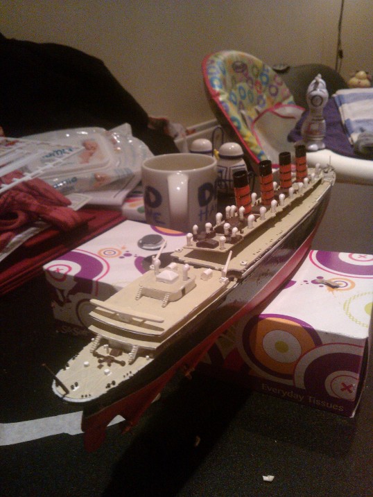

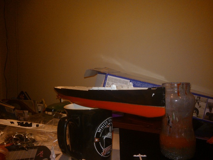

I bought this kit about ten years ago and to be honest I had very little interest in building it because when I received from an ebay purchase it was missing parts so was put in the pile.
I decided to build as I know how rare these kits are getting and matches my queen Elizabeth and qe2.
The kit I received had no fixed parts of bag so all I got was the parts minus a couple, the manual and transfers.
Unfortunately like all airfix kits, the detail was terrible such as missing windows on all most decks, missing support girders.
the girders I will put in with donor parts of plastic and I will draw all the windows with cd pen.
As you can see by the picks below the ship is in terrible condition with inaccurate paintwork so I first cleaned the hull up with base coat which is a dramatic improvement.
Will keep posted as build goes on.

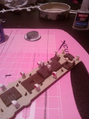

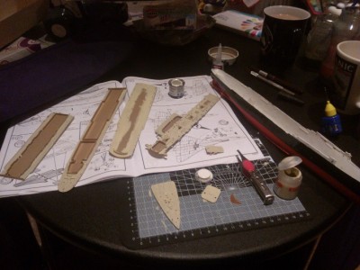

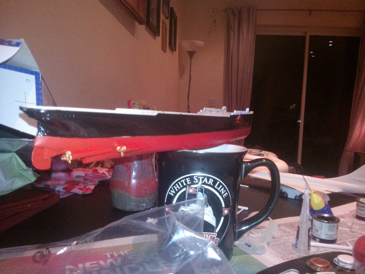

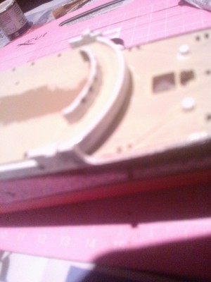

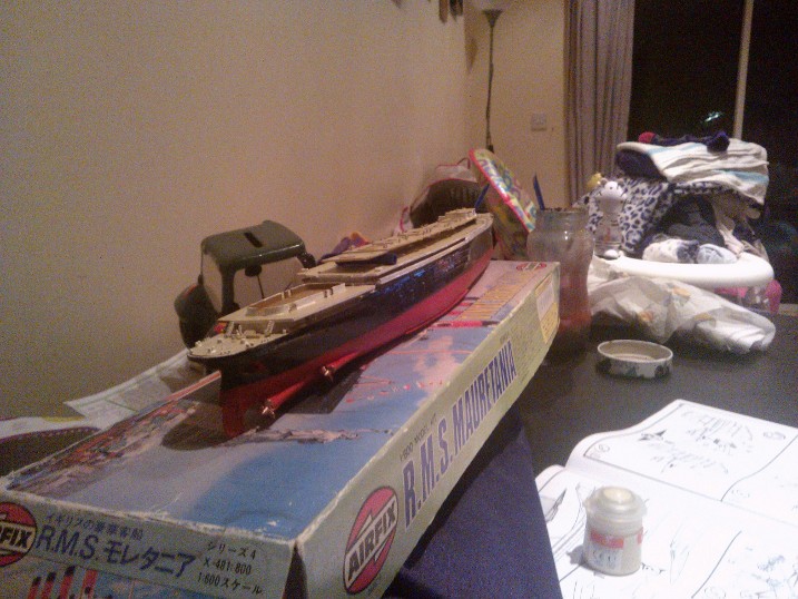

Performed more paintwork to the decks and the deck walls.
Also fastened the fan tail and forecastle in place.
Checked details of the ship against plans and found water line indicated on the model is too low so will have to amend that one.
Also included pics with all deck dry fitted showing the missing parts which are the second class open space and entrance towards the stern and the recessed deck wall on the forecastle.
In the pics you can see the major fault with this kit which is the lack of any girders which support the decks above in the exposed promenade.
These will all have to be made. Still working that one out .

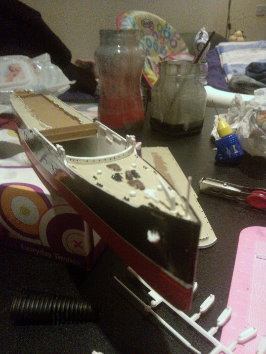

I decided to base the model early in the ships career when she had similar colouring to Lusitania so most skylights were brown on the top of the house as can be seen in the photo of the mauretania in Liverpool.
I started by reconstructing the missing sections of the model. The first section I was missing was the second class open deck space that supported the docking bridge. To reconstruct the section I measures the thickness of the existing decks and matched 4 sections of acetate. I outlined the existing section of deck after cutting off the steps before re-attaching as it was a similar shape and used the plans of the ship to calculate the reduction in size as it was wedding cake tear in profile. Using the other deck section I matched the curvature in the deck. I also cut out the sections around the mast and the area of the baggage cranes.
I also recreated the recessed bulwark in a similar manner on the forecastle deck.
I painted the sections, mounted the docking bridge, dry fitted the decks again, attached all the cowl vents in fist class and made a start on the funnels by assembling\painting.
There is a massive amount of flash on these parts that have to be cleared and the fit of the decks, particularly the boat deck are questionable and might need alteration as it appears too long.

Tonight I decided to focus on correcting the paintwork and the boat deck on the ship.
In the previous pictures you can clearly see the over hang of the boat deck where it ends at the main mast. This was confusing as this did not really exist on the ship but when I compared the piece to the plans the airfix deck was the correct size. I found the problem was where the deck meets the hull behind funnel number 1, there seemed to be an extra bit in added which can be seen in the fist pick. The impact can be seen in the second pick where the forward bulwark of the boat deck is retracted into the superstructure too far. To resolve this I cut out this section which resulted in the boat deck sitting in the correct position and the second class deck positions in the right place showing a perfect wedding tear shape.
I corrected the waterline height on the starboard side and added the white band on top of the waterline.
The black line at the top of the hull on the Lusitania was lower than the mauretania which can be seen on the photo above. The black line on the mauretania actually went one third up the A deck bulwark which airfix have beautifully represented here in the mold of the hull. On the Lusitania it stopped at the top of B deck. This has now been completed on the model and the second class A deck exterior plating has been painted black also. This was also not the case on the Lusitania.
The funnels on the model have now received their characteristic orange.
I intentionally have not added the boat deck housing yet because the rigging of the funnels needs to be completed which wraps inside this deck housing.
Next up I need to complete the paintwork on the port side and start re-creating the second class lounge and sky lights.

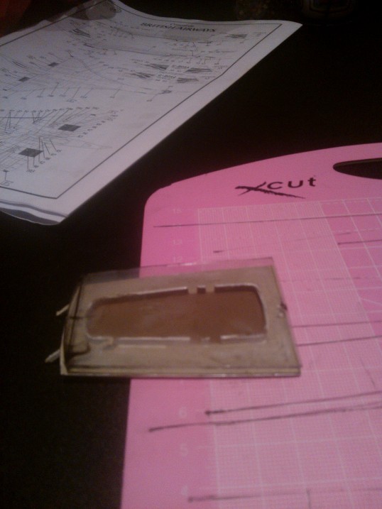

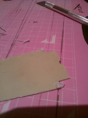

The first thing done tonight was to input the missing steam pipe on funnel number 1. This was made from spare evergreen plastic. Unfortunately the fresh water tanks were another item missing from the kit so I created new tanks from larger scale bollards as I liked the rimmed detail which simulate the lines on the tanks.
Way aft by the café parisienne on the boat deck, all the cowl vents were missing so I carved to scale new cowl vents. I painted in the windows on the sky lights on the top of the house, using a battleship grey which blended in nicely with the brown and does not overly stand out. The inside funnels also received a coat of black.
Next up was the recreation of the second class deck which was completely missing. I started by carving new mounts for the cranes with evergreen plastic. These were then put in place and cranes mounted.
I created the skylights in the same manner. Using acetate plastic sheets I created the wall of the second class lounge, measuring the height from the first class boat deck walls of 4mm. I could have cut out windows but to be honest I wanted to keep the look of the kit consistent. Glues and painted the walls.
Airfix did something peculiar with hose pipes in the anchors and molded them straight. Instead of drilling to make larger I cut the anchors down to size so they sat in the holes.
I mounted the flag staffs and painted.
I also mounted the anchor and corresponding crane. Flash was consistent and cleared.
I also moved the a deck wall on the fore castle forward as it was set back to compensate for the mistake in the boat take previously stated. It was now populated with portholes.
A fair amount done and lots more to do.
