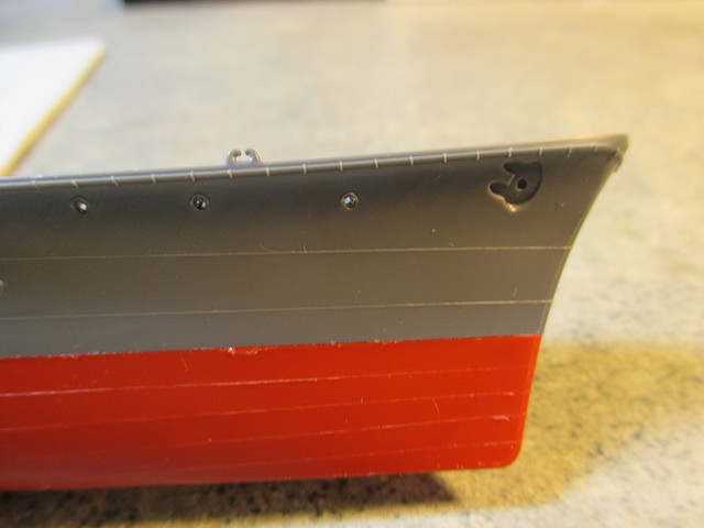

Will I finally have started building the Shimakaze. And right of the bat I missed up. When I glued the hull together I got some glue on the surface.
And when I went to sand it off I took some of the detail off with it
Now I am gone to have to use seam putty to add it back in.

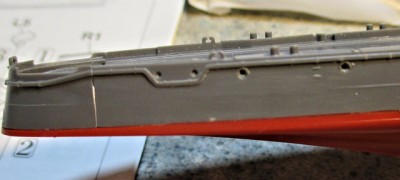

When I do this I will also full the seams where I glued the stern of the model on.
I will also need to full some places on the seam where the hull joins to get a smooth joint
