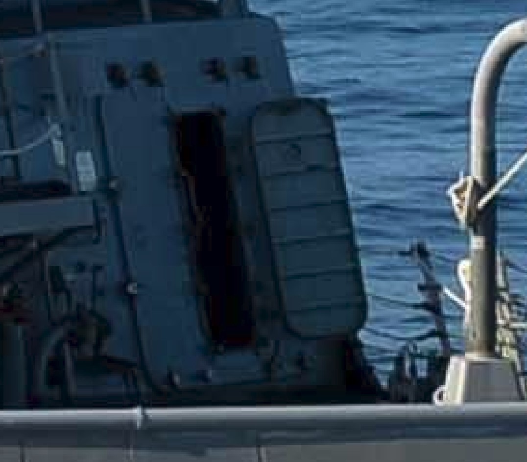

PostPosted: Sat Feb 25, 2023 4:27 pm
Posts: 12330
It's all meant to be one piece, so just fold along where they connect so that it's flat side to flat side. The "door frame" goes on the ship's bulkhead, the panel next to the frame would face the inside of the ship if depicted closed, and the panel farthest to the right is the one facing outwards if closed.
See example below showing one hatch open while its counterpart on the other side of the ship is closed:
