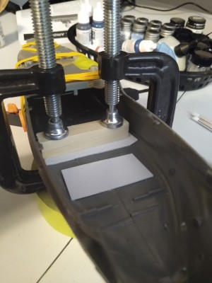

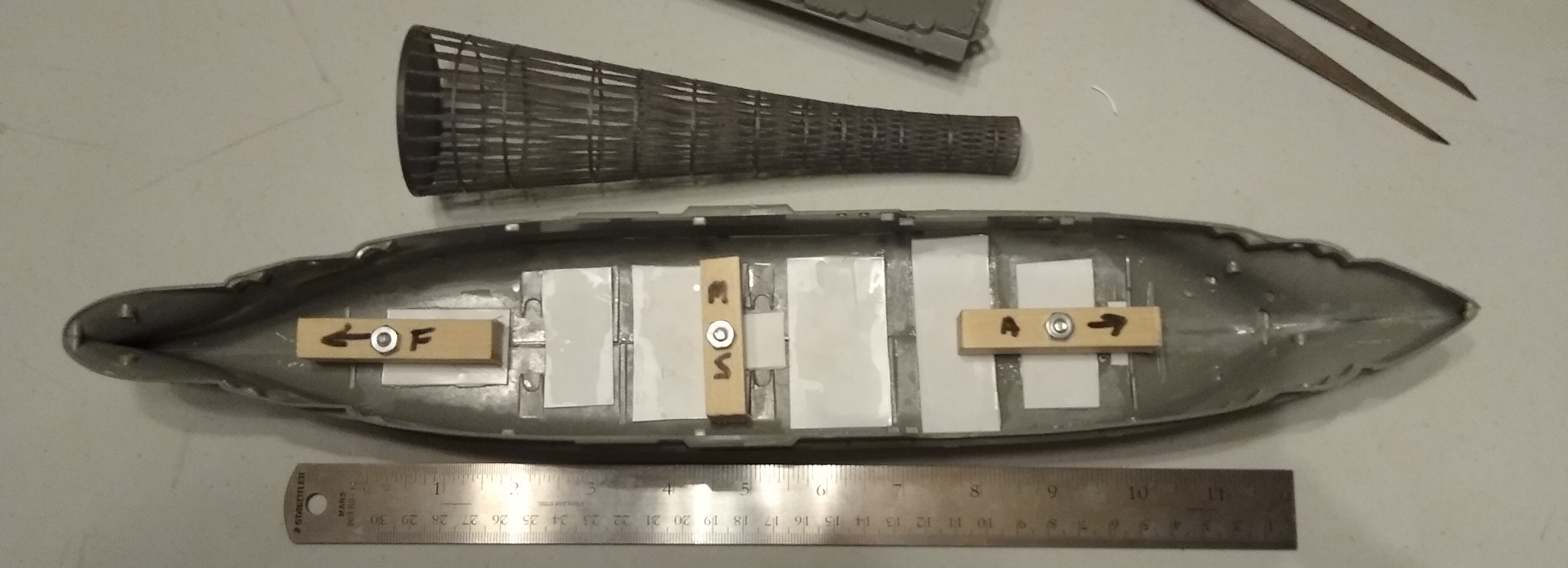

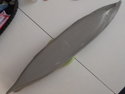

I've been toying with the idea of making custom 3DP parts for this kit and I was going to jump right into customizing one to represent the USS Arizona as constructed but, I realized that it's been decades since I've actually built a plastic model and I never really built them well ; (
So.. I figured I should try to build one out of the box, for practice.

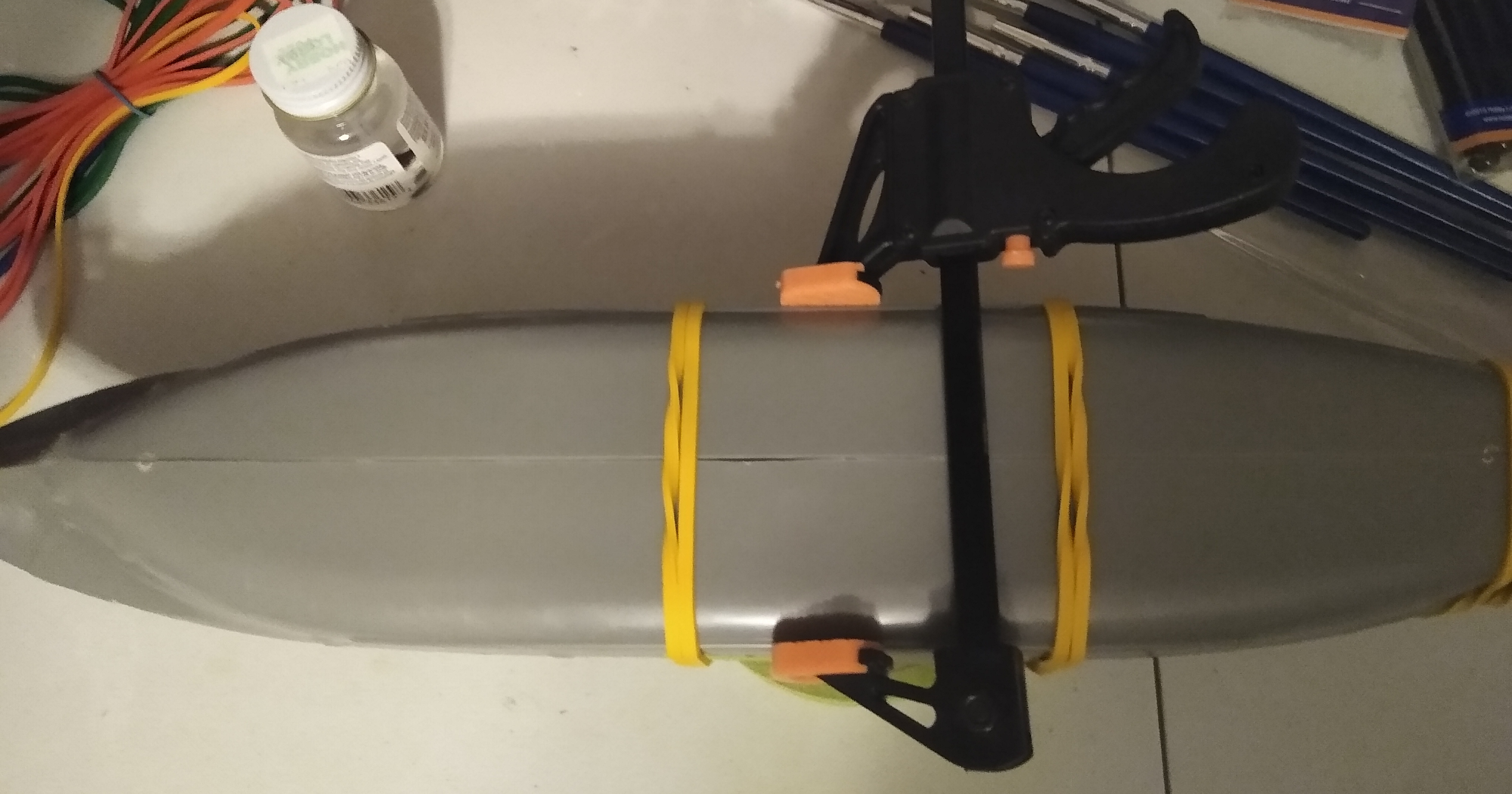

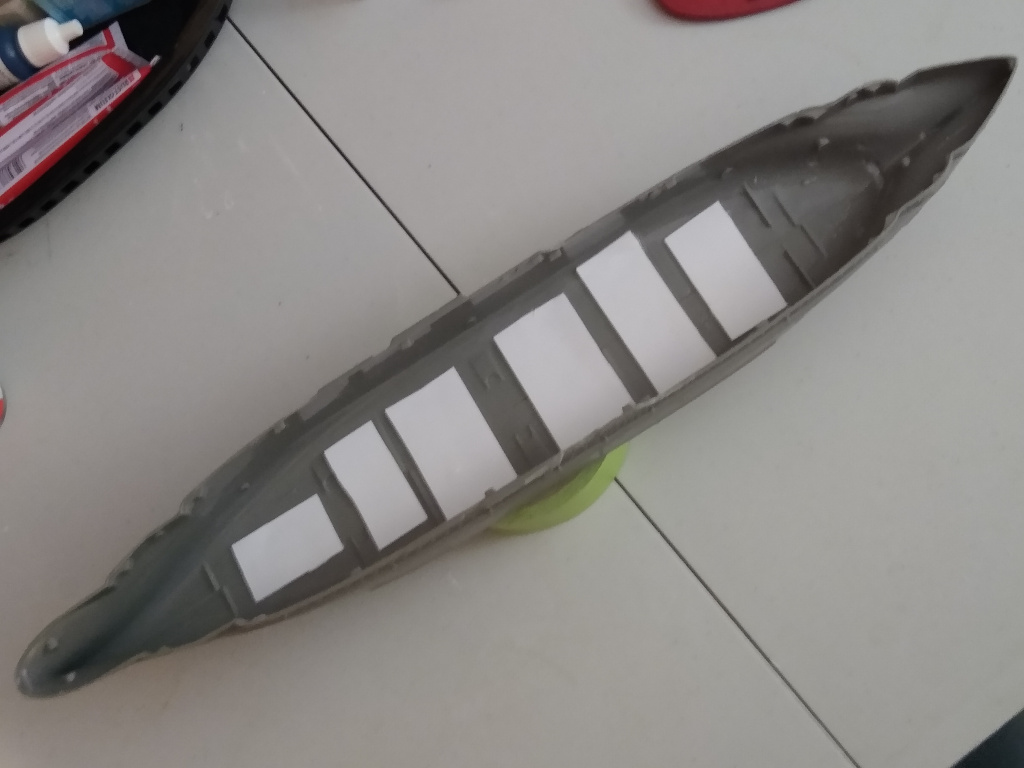

This particular kit has been on "the shelf" for a couple of years because the seam down the center of the hull looked pretty awful and I'd read that the pressure from some rubber bands would fix that, given enough time. It did not, and I'd seen some other build threads where people had glued in bits of sprue to bridge and strengthen hull seams. I figured I'd see if that'd work. I found a pistol grip clamp at hobby lobby that seemed like a good size and while it closed up the gap, the bottom was no where near flat.
I decided that I'd hold it flat with some lengths of 1/2" square dowels, some small C-clamps, and glue in plates of 1mm styrene to keep it that way. It was pretty awkward as I didn't really have enough small clamps but, I think I've gotten the job done.
I'm guessing that I'll still need to fill the seam on the bottom though. I guess I'll see what it looks like when it's dry and all the clamps are off.

On the first picture if I follow the center seam there might have been 2 small burrs present causing this trouble. Old models sometimes have protruding pin ejector marks or simply overly long locator pins on the glue surface.
They weren't helping and, yeah, I cleaned things up after that first pic : )
I think it's good enough now that I'm just gonna paint it.

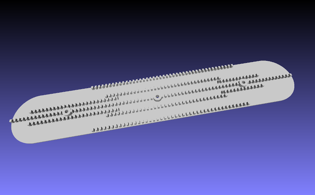

I got sidetracked for a a while because I decided that I didn't want to use the display legs that came with the kit. I didn't feel like turning finials out of brass and the only wooden square stock I had was way too big to suggest blocks. So what to do?
Spend hours tracking down the docking plan and designing a nearly scale 3DP model of the keel block arrangement, of course : P So.. that's done and printing now. I'll have to spot the holes in the hull and test fit it later.

DavidP wrote:
how thick is the base that the blocks are printed on? how long & wide is that base? why 3 mounting holes as I would have used the 1st & 3rd & kept all the center keel blocks the same height to flatten the bottom of the hull?
It's roughly 1.5 mm thick, 350mm long, and 60 mm wide. It printed pretty well on my filament printer. The center hole is to clamp down on a wooden cross beam that will make sure that the hull touches down on the outer rows of blocks.

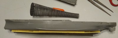

Got the base with the keel blocks test fit and it doesn't look too bad.
It definitely hides the hull seam : )
I guess it shouldn't be a surprise that the model doesn't match up to the scale docking plan?
Even with some excessive clamping, not all the blocks touch the hull.
The next iteration should probably have the outer rows of blocks be a mm or two taller.
I trimmed the semicircular ends down so that it didn't stick out from under the hull obnoxiously.
