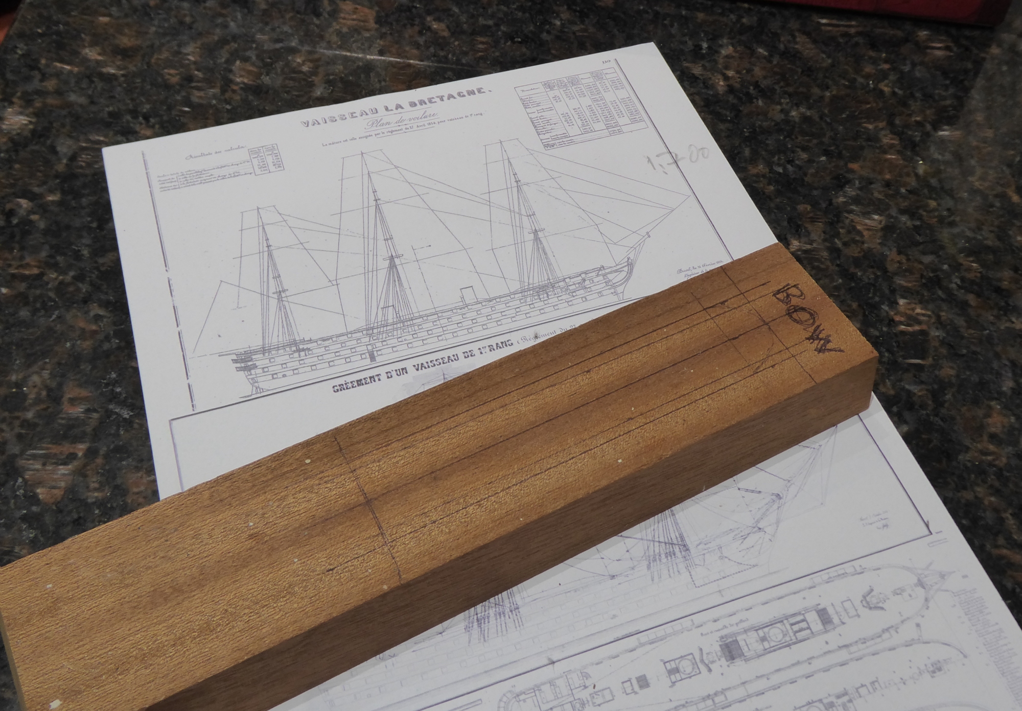

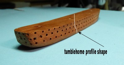

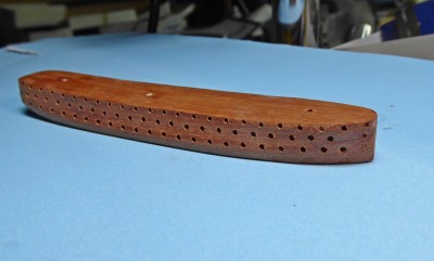

So my plan of construction is outlined below... please comment if you see a flaw in my thinking! :wave_1:
cut hull blank in Jarrah , fore and aft , sheerline to weather deck & waterline width only
Bretagne dimensions are given as WATERLINE length-- ergo
120 mm on deck( allow extra 0 .5 mm for additional sanding )
Sstick on ( Pritt!) printed scale side elevations ( as per plan and flipped)
Centre-mark/prick all the gunport centres on the ( near parallel ) sides
(but not yet extrapolate around the curves bow and stern! )

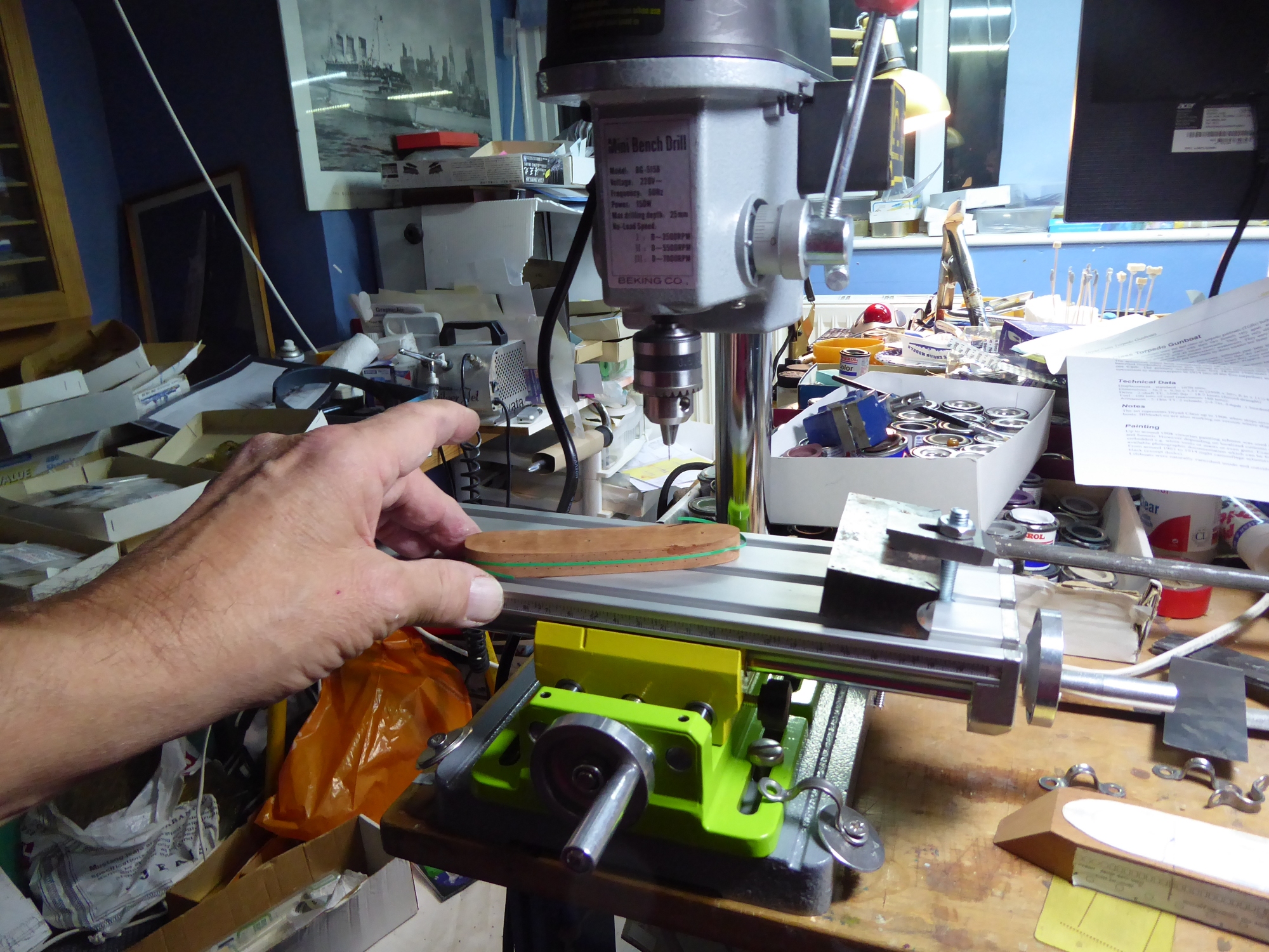

Drill through 5mm DEEP with a thin pilot drill. ( I bought a fine miniaturised Pillar drill
and adjustable machining table clamp to place the model under the drill ( more ) PRECISELY!
Create the tumble homed hull and undercut bow using negative athwart-ships templates
Form the bow and stern - and extrapolate the positions of the apertures fore and aft using photos and plans
Drill open the small pilot holes to the diameter of the gunport OUTER frame sizes 1.5 mm deep
( each row is different size gunport! )
Cut and form square-ish corners with a No 11p scalpel -- insert brass squares cut from my huge stocks of
old-overscale-square-aperture-ladders PE glue in and secure with CA
( as done before on 1/700 Jeanne d'Arc--except this time it will be much better! )
Run automotive stopper ( ultrafine filler as used on classic cars! ) over the gunport rows
Fine-sand until the brass , wood and filler are uniformly smooth
Form decks, bulwarks , gratings , Fore and aft raised decks, hammock stores funnels, bridges, stern walks, masts, spars and sails
this should see me through to March.... :big_grin: :big_grin: :big_grin: :big_grin: :big_grin:

What you guys said about the changing angle of incidence is absolutely true and correct!
However-- I only pricked the centres and drilled the ' locater ' holes down the near parallel sides; only
that way the deep pilot holes--relative to the sheer-line and deck-levels was correct,
==> regardless of how much of the hull sides was removed :thumbs_up_1:
( I checked the with green tape )

I cut out lots (and lots ! ) of half section templates to guide the tumble-home shaping
On this solid hull, the hollow shapes of the tumble-home shaping would appear a challenge...
and it was ! :thumbs_up_1:
I used various sizes Ball shaped grinding tools, as well as 'parallel-sides-drum-with-positive-curved-cone-point cutting-face
( what would be the correct name for that...?? )
these various grinding bits and cutters were installed in my vertical pillar Drill chuck and the the hull mounted on a copper plate,
( low friction and stable larger surface datum plate for handling
This was slid around at various heights along the rotating cutters and grinding tools until an agreeable
and ( near!?) correct shape -according to the templates - was achieved.

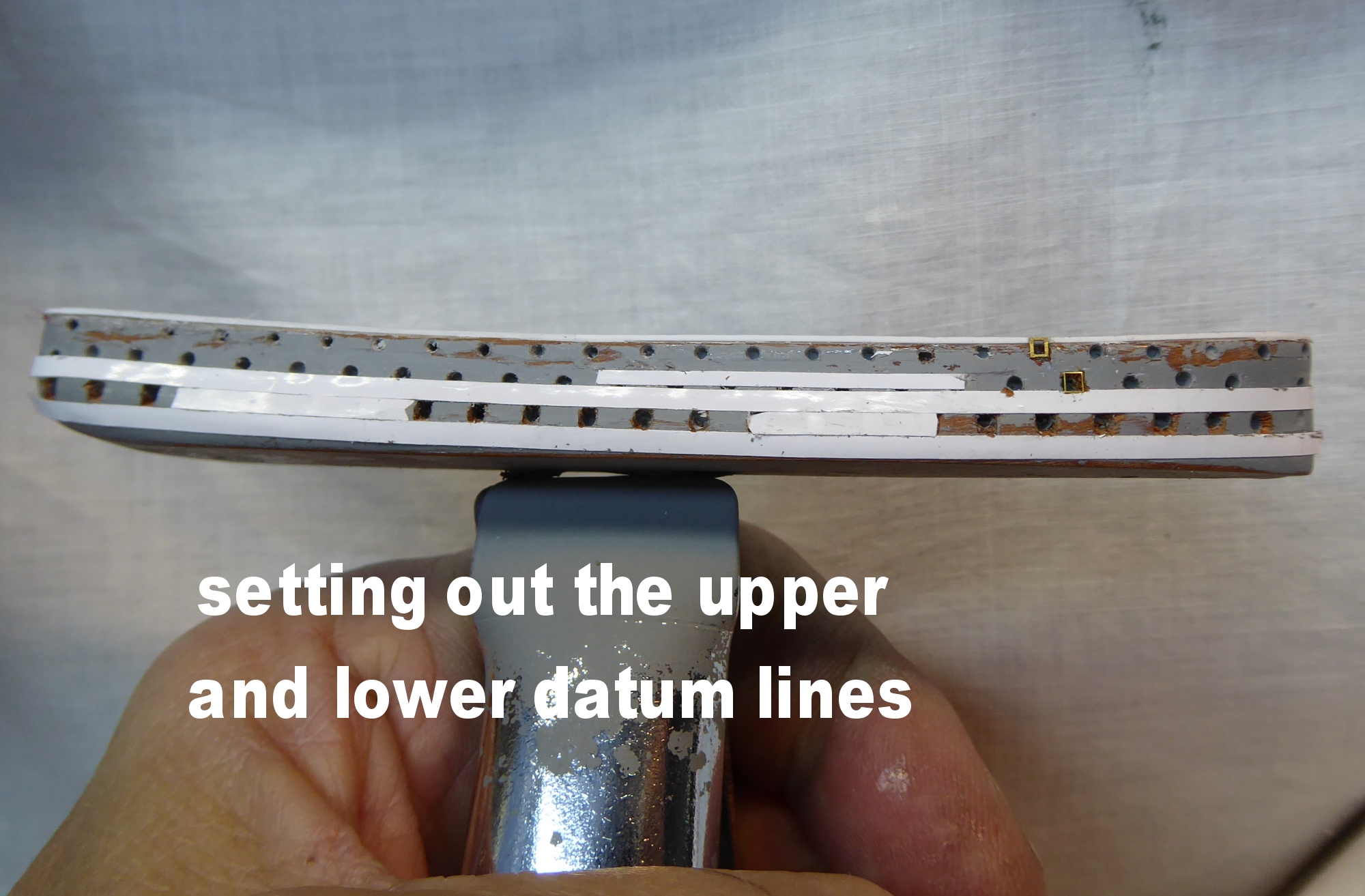

a light sanding and then white tape was applied below the pilot holes of all three rows of gunports and the
continuation lines thereof, allowing accurate marking off with dividers for the remaining pilot holes.
Then large enough drill bits ( different size for lower 2 x rows than the upper)
to cut holes big enough for the brass squares to be inserted
( This looks crude and brutal at the moment ) but the holes follow the lines sweetly!

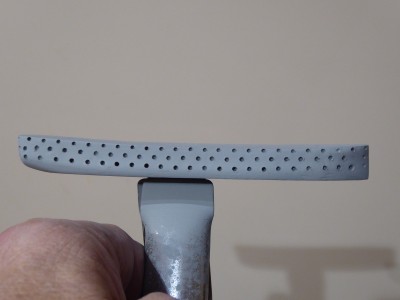

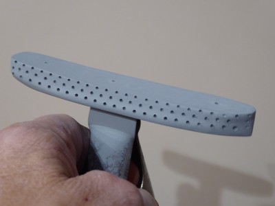

I gave the hull a couple of coats of high build primer in readiness to sand off - when hard- to get rid of imperfections.

I used tape to establish datums of spacing for the cuts in the wood
( Swann Morton 11 Pointed Blade)

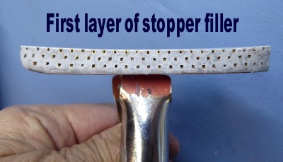

But with the addition of the ' Stopper filler ' things look much improved :wave_1: :big_grin:
The sanding vindicates that the gun-port apertures
are level in plane to the surface of the hull sides

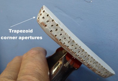

The trapezoid shaped windows on the aft corners --seen here on the real thing in build
shows the corner windows having a trapezoid shape created by the double curvature of the hull
Making these was quite tricky, requiring the brass ' frame' to pulled in opposite corners very gently with pliers
