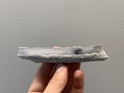

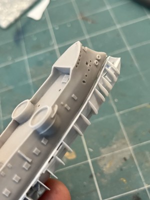

I will use Doggy Industries 1/700 resin kit as a base. At the time it came out, not much was available in French ships of the era out there. Today (2 years ago?) I would have gone with Combrig kit of Trident, but this in itself is also fun.
The ships were smaller versions of Amiral Duperre ironclads and built for overseas station. Bayard is notable for action during Sino-French wars and it is her that I decided to build. She differs to Turenne in her funnel layout if we go with most easily identifiable features. The smoke stacks are twin format, without the cowl that is added on Turenne, and have those little covers on them that look like Micky Mouse ears once they are are open. Bayard had most action on record and more interesting to build.
The kit is reviewed nicely here: https://www.modellmarine.de/index.php?o ... industries

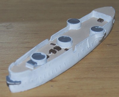

This pic from the review shows the hull how it looked out of the box.

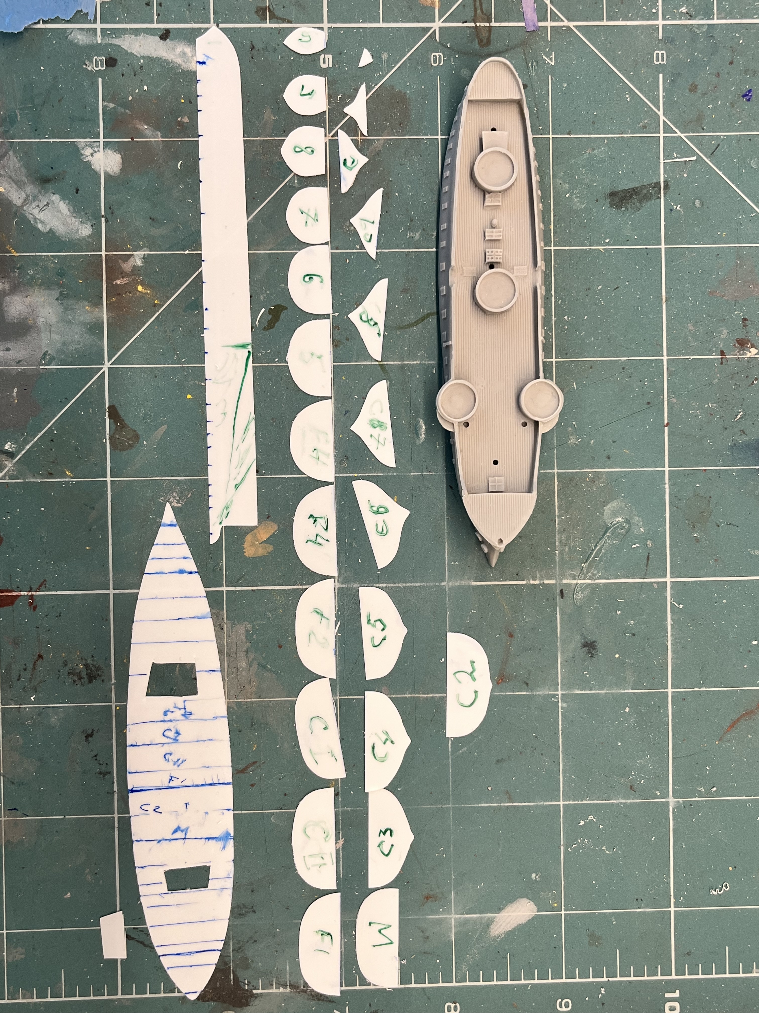

The start was to use available plans to built the lower hull. I used styrene to cut out the cross section parts and add putty in between, sand it all down, and marry this to the upper hull. Unfortunately this is where my plans ran into reality of the hull dimensions, etc. Cue a lot of work...
I start with the lower hull as thats the main bit. Scaled down paper drawing, printed it, and used it as template to cut out thin styrene cross section parts.

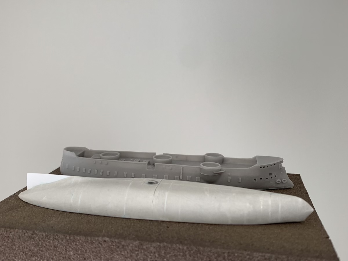

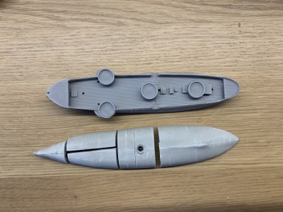

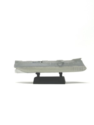

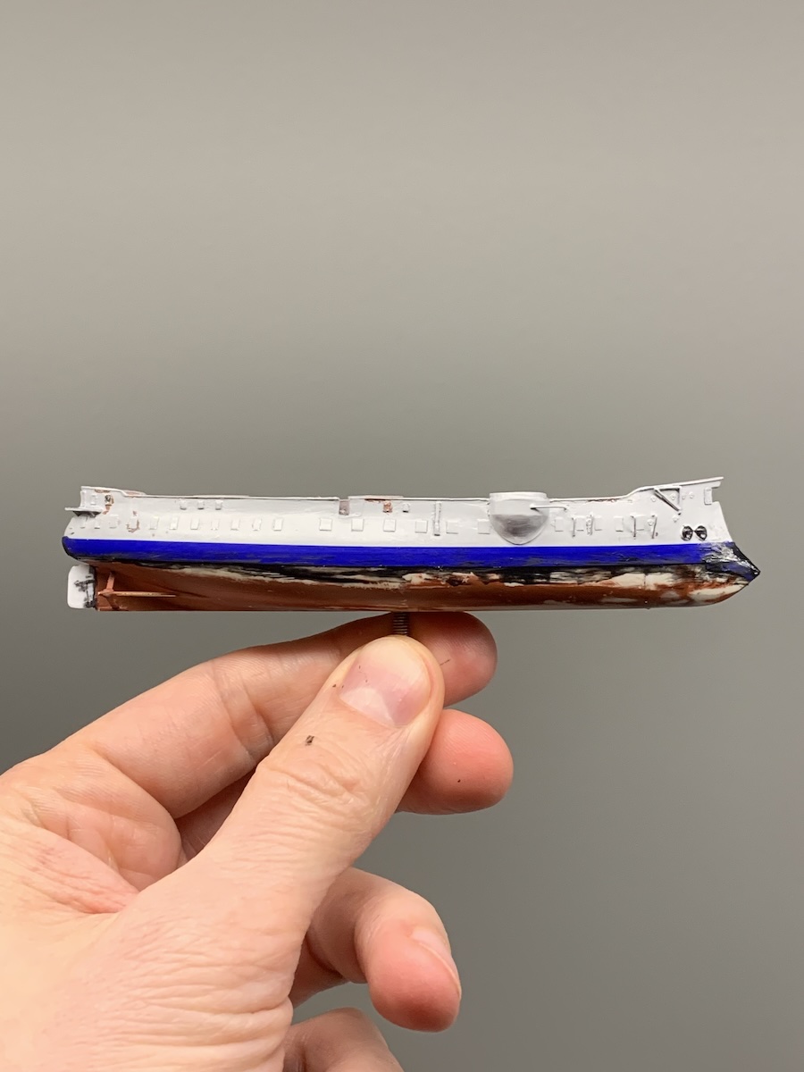

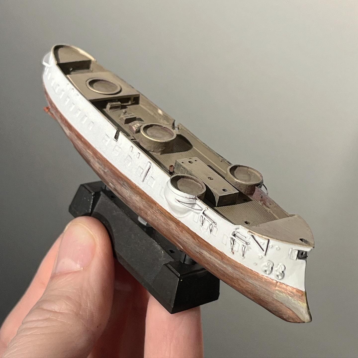

Now even if lower hull height is accurate, the upper half thats in resin is too tall. So I sanded that down as well before marrying the hull halves.
Then problem began, because the styrene was too thin, and it warped when the putty dried.. The keel and stern and bow did not align, it hogged to a side. So I have cut it all up and realigned. This is clearly showing I have no clue what Im doing but this is my first lower hull build, and I am learning.
Also I took care of adding a way to secure the ship to an base (dry dock style) for later using bolt-nut system. nice to have.
I finally was able to get the hull to fit that the ship looked like something that resembles a ship.

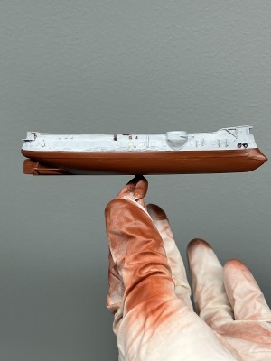

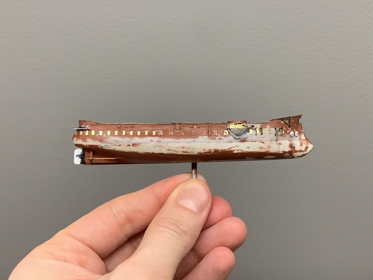

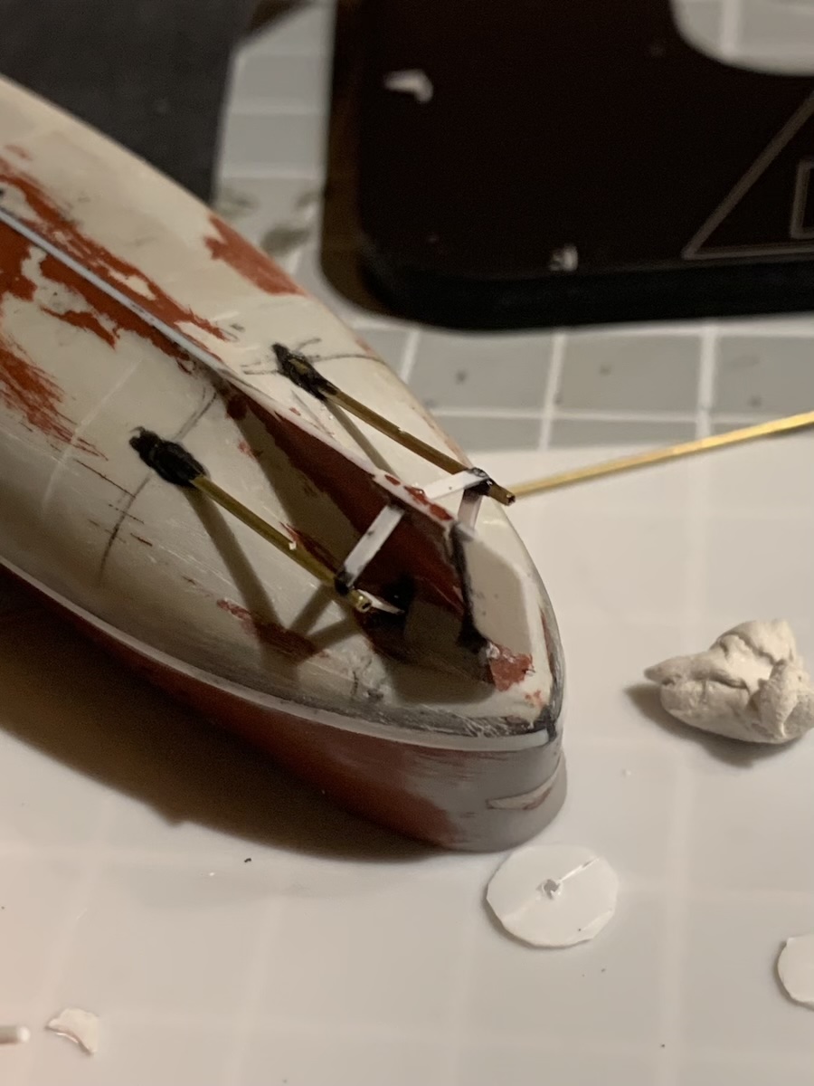

Once I thought I was happy with the lower hull, I built the prop shafts. This is eyeing things, I dont have any plans just some basic disagrams. At the end of the day, I will have to guess the size of propellers (accept they will probably be a bit too small and crude) but as I weather lower hull the copper and such will distract hopefully from a shoddy appearance!
Two brass tubes, supports, and I used approx prop templates from styrene to set the size. Some putty to marry it to the hull and build connectors. At this point I also see the rudder is too small and I will redo it later on.
I began detailing the actual hull then. Using some left over PE bits (in this case, Flyhawk ammo boxes from HMS Hood) I cut up what passes as gunports in closed position, I scored them across to imitate the shut lines (later can be pinwashed) and added them in.
I also add other details that I dont have photos of but a metal wire around the gunwales, and further ports, the sternwalk and bunch of smaller doors.
It looks something like this in the end:

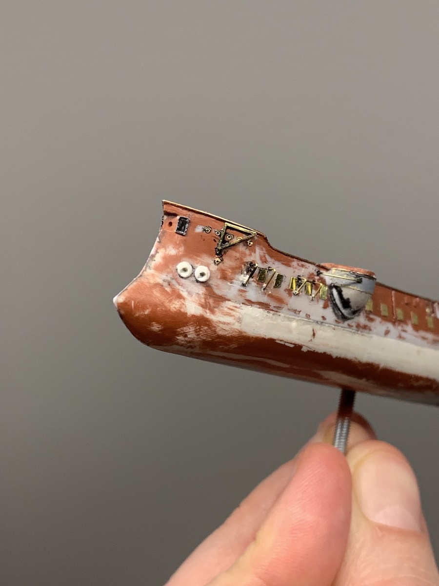

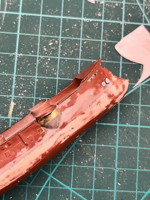

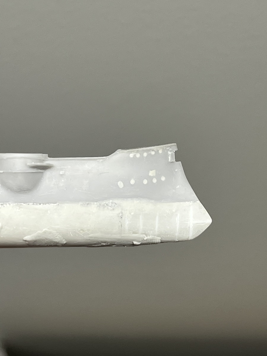

I also a this point fully redone the bow, fixing everything I didnt like about it (its curvature namely and how "dull it was")..
I chopped off the "nose" fully.
Cut out the negative template from plans and rebuilt it first with much thicker styrene from top to bottom, made sure it was sharp enough and straight (i didnt like that the lower hull bit curved slightly to the side no matter what i did) and thus the whole thing looks perfect now to my eye for this scale.
The detail of the bow with other small bits added looks like this:

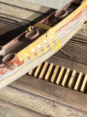

So here is the added electrical tape after couple of layers of primer was applied, I noticed some incorrect placement and reapplied it correctly.

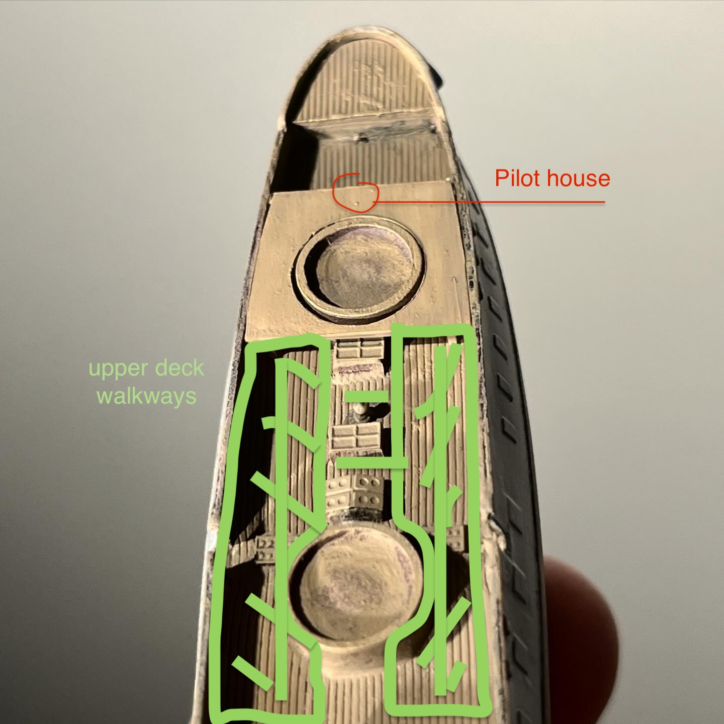

From above, we get the first view of the rather incorrect deck layout as highlighted in original post, which is the focus of my work next. This is it for now, I will be updating the thread from now on as I build, as I have caught up to where I am today.

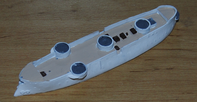

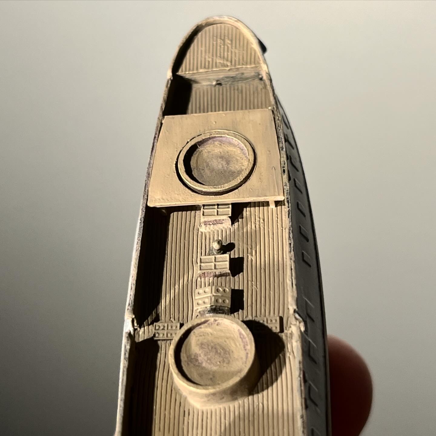

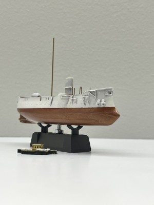

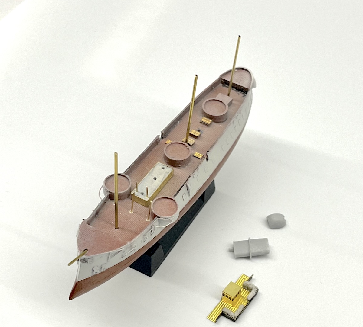

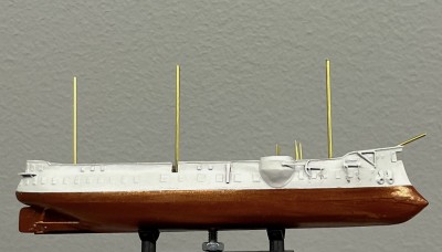

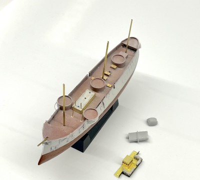

I did a little more on the kit, started to paint the main deck before adding the upper walks (stern section is a test fit). Should be good, I cant figure out why they did this - covering main deck areas, the ratlines going down through it, etc. Oh well, French ship. :)
