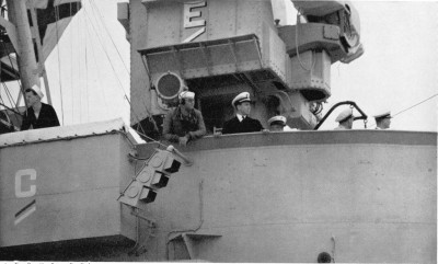

Can anyone tell me what the box-shaped object in the picture is? And, would this object be open to the top, or closed?
PostPosted: Thu Jan 24, 2019 1:38 pm
Posts: 1611
Location: The beautiful PNW
Looks like the flag locker, so open on the top.

PostPosted: Thu Jan 24, 2019 2:14 pm
Posts: 2465
Location: Hoboken, NJ
Agreed, those are "flag bags", open from top. Photo below.

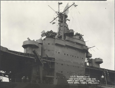

Here is a close up of it,
She also had one on the Starboard side, later date but can be made out in earlier distant shots.
HTH
