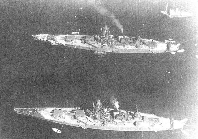

Note that Dunkerque did not have the round breakwater around turret #1
Damn the torpedoes, full speed ahead! - David Glasgow Farragut
PostPosted: Sat Nov 09, 2024 8:09 pm
Posts: 551
Thanks for the comments, the build is now taking off slowly.
It seems like at some time there was a breakwater difference. It seems that an angular plate was used in stead of the round one here, or is this something else as I see the rounded shape at the far side of the turret? I would have to alter the deck planking for that. But this difference was temporary, in attachment below you see a shot of both ships with a round breakwater.

aerial-view-of-the-two-dunkerque-class-battleships-v0-huvn7exxe2j91.jpg [ 68.81 KiB | Viewed 2114 times ]
