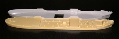

A word about this kit, marketed as eight different sisters. It’s great to have a styrene kit of this class, and most folks will be satisfied by it. That said, it’s about as simplistic, generic and inaccurate a kit as Fujimi has ever released. It certainly does not measure up to the detail and general level of accuracy of Fujimi’s other 1/700 IJN releases of the last few years. The bow and stern are wrong, the hull plating grossly overscale, a generic layout is used for the configuration of piping and hatches on the main deck, the forward and aft bridgeworks are also generic (though some kits contain as many as three different bridge facings; a nice touch to try and differentiate among the sisters but, also oversimplified), and a host of smaller errors.

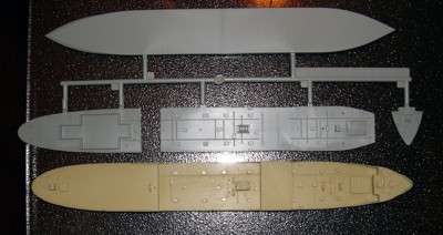

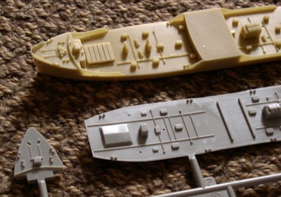

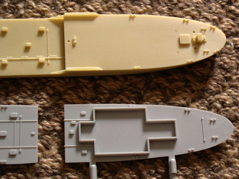

The H-P kit isn't entirely accurate either, but it certainly captures more of the shapes and details correctly. Here are some comparison views between the Fujimi kit and the H-P kit.

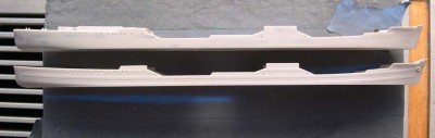

First things – the hull plating has to come off, and the prow straightened. I’ll need to work the bow to make it finer; it’s pretty blunt. I also installed the rear bulkhead. I will keep updating as time allows.

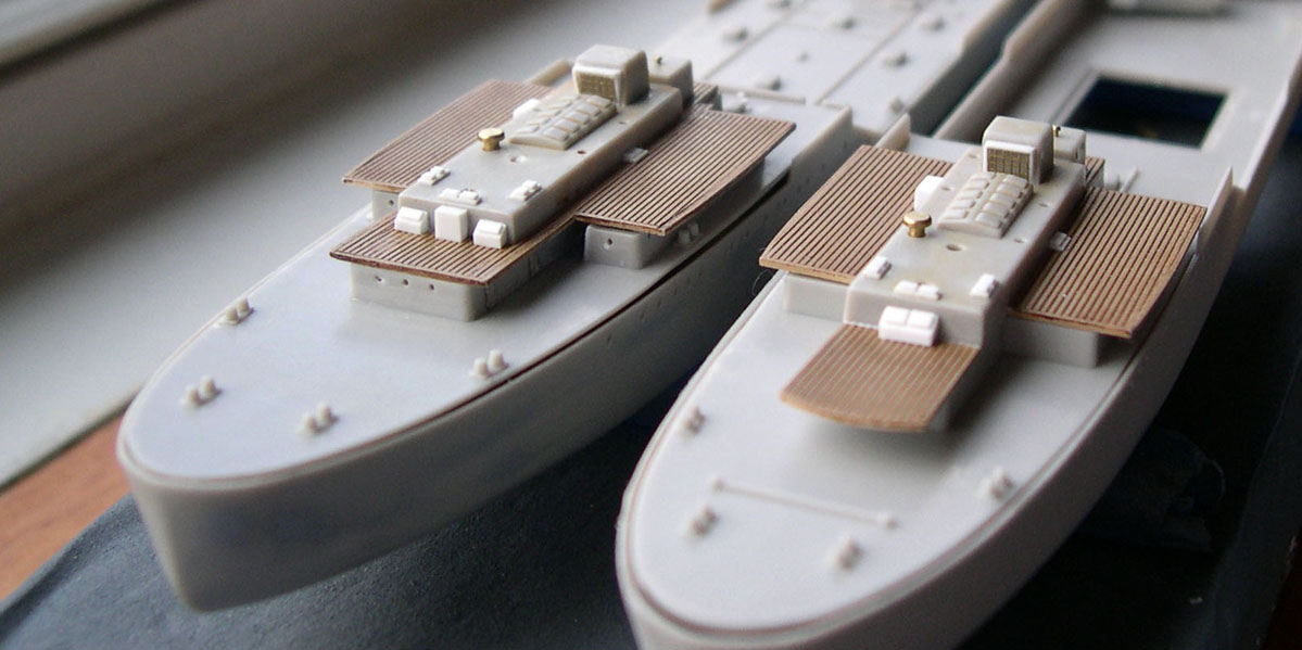

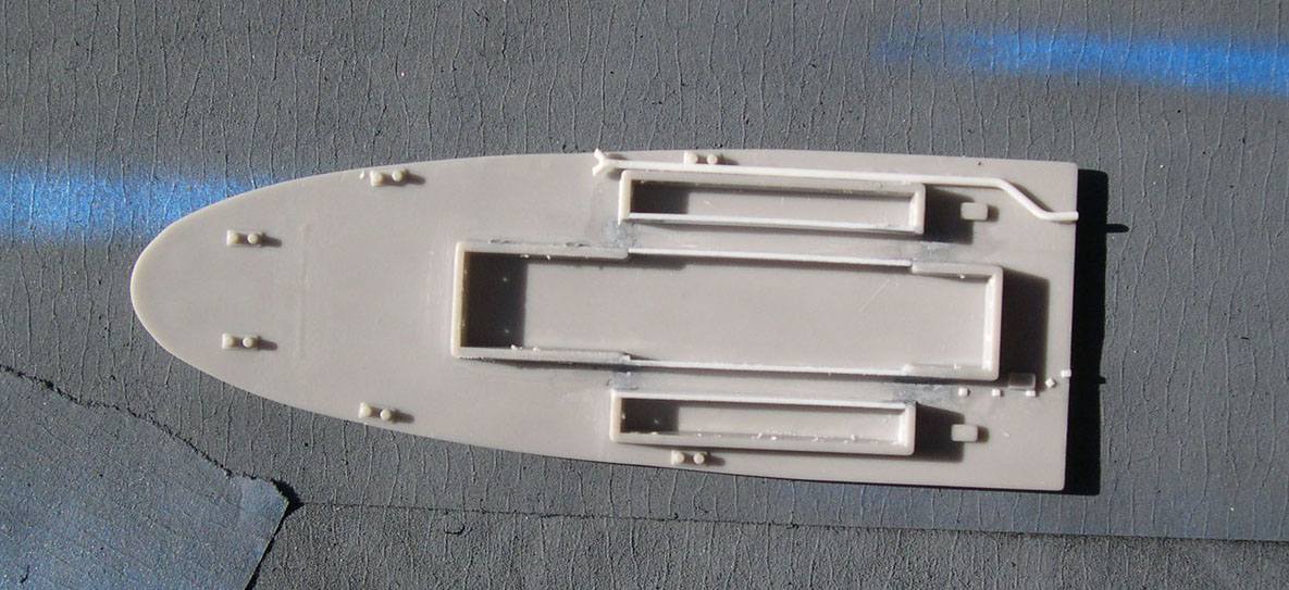

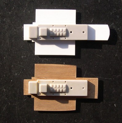

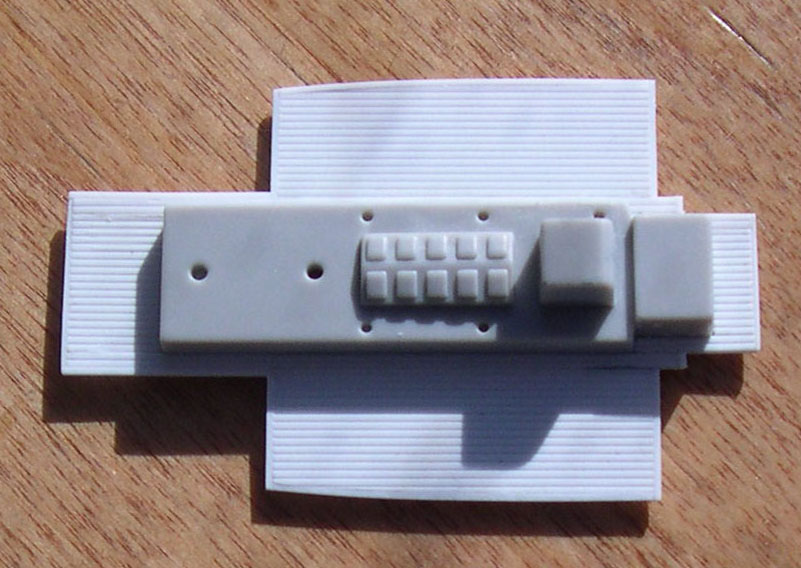

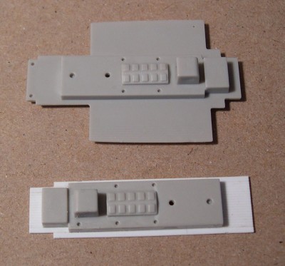

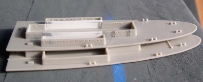

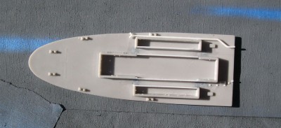

The next step was to re-create the boat deck. The kit deck is closest to that of Nippon Maru, which only had a portion of this deck planked with wood. Most all the other sisters had fully planked decks, though the overall outline changed subtly between groupings. I chose to retain the superstructure portion of the kit and sliced off all the decking, replacing it with .2020 V groove styrene. In retrospect, I think it might have been far easier to not only replicate the deck with V groove but to also scratch built the actual superstructure. Oh, well.

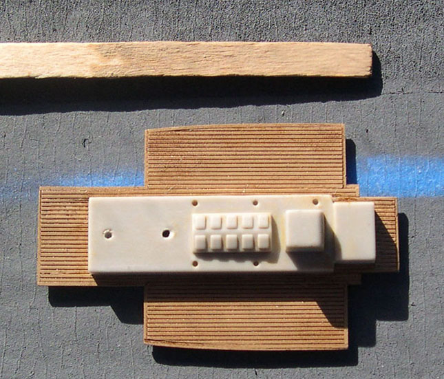

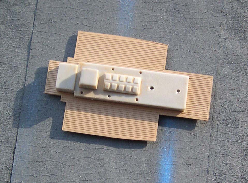

Once the deck was complete, I sprayed the planking with the new Tamiya deck tan (flat). Then came a coat of Future, and a wash of burnt umber. I thought it turned out well. For comparison’s sake, I included a stir stick covered with just the Tamiya deck tan.

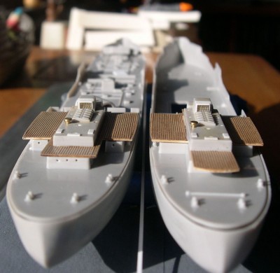

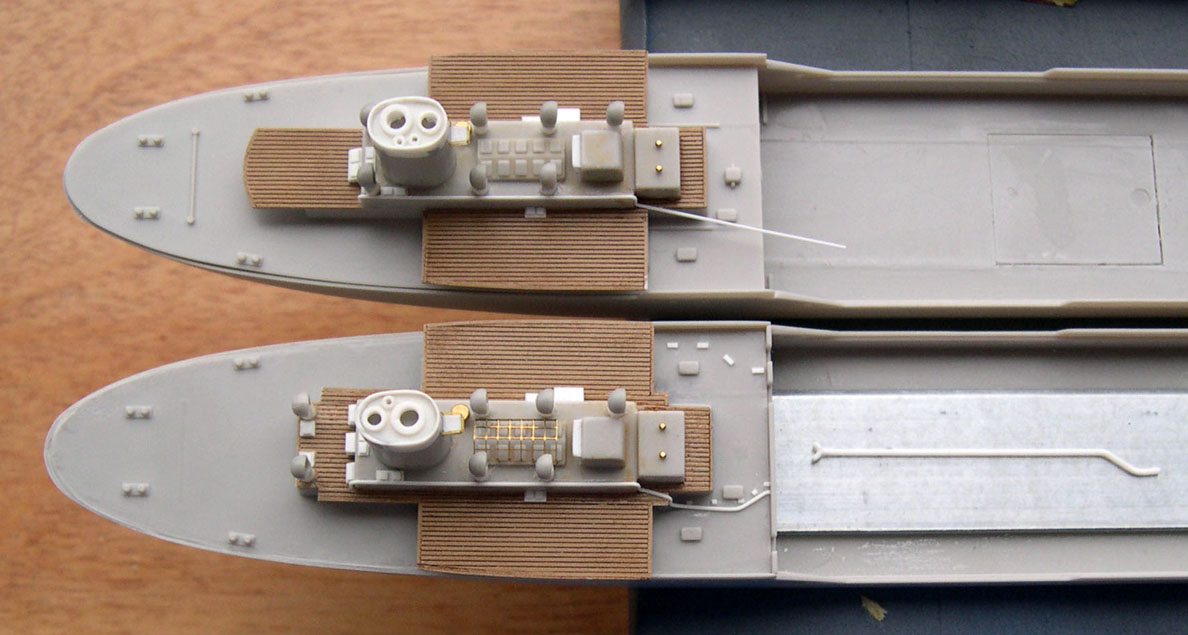

Two thoughts that I neglected to bring up in my last post: 1) The boat deck is bordered with a .015” x .02” strip, which will provide the footing for the railings. The border idea came from Motoyuki-san’s work and I think is an excellent idea. 2) I actually attempted to use the kit supplied boat deck first. Doing so required scraping off the raised planking detail (which is very nice – if only their carriers had it this way, which kind of proves my point about Fujimi’s arbitrary planking choices) and scribe new planking lines. Ultimately, that didn’t work out as I couldn’t space the ruler edge properly. Hence, the move to V-groove Evergreen sheet.
Taking advantage of the initial learning curve, I then replicated the boat deck for Kyokuto Maru (top).

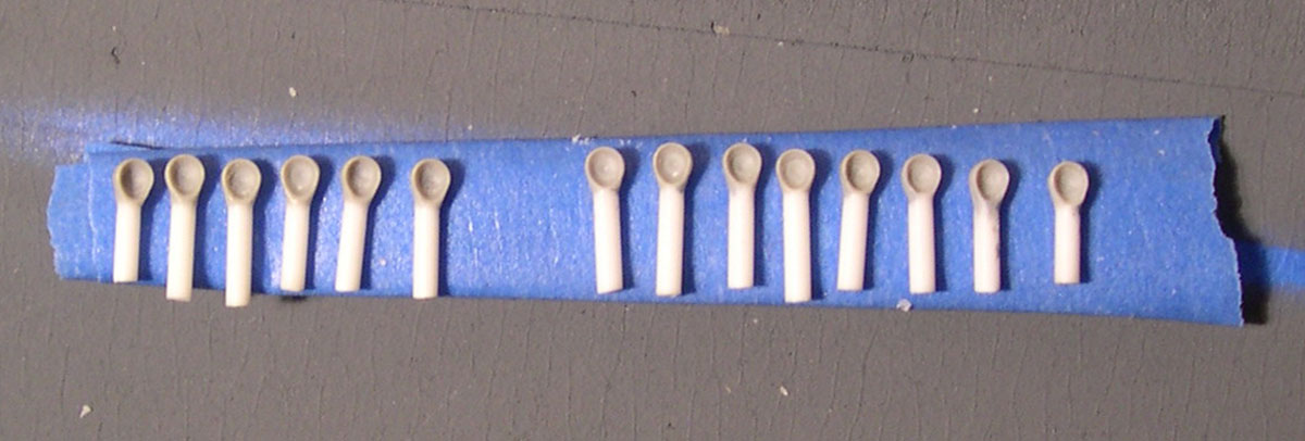

There were a couple of options open to me. Casting was one but, frankly, it’s not an area of expertise for me. There are a number of resin & styrene versions, though I don’t have all of them. Pictured are (l to r) ventilators from the H-P Itsukushima set, those from the Fujimi kit, a version from the PitRoad Kimikawa/Kamikawa Maru kit that’s also sold as part of a sprue for merchant auxiliaries, and one from the old PitRoad E-38/E5 equipment set, which turned out to be the closest match
