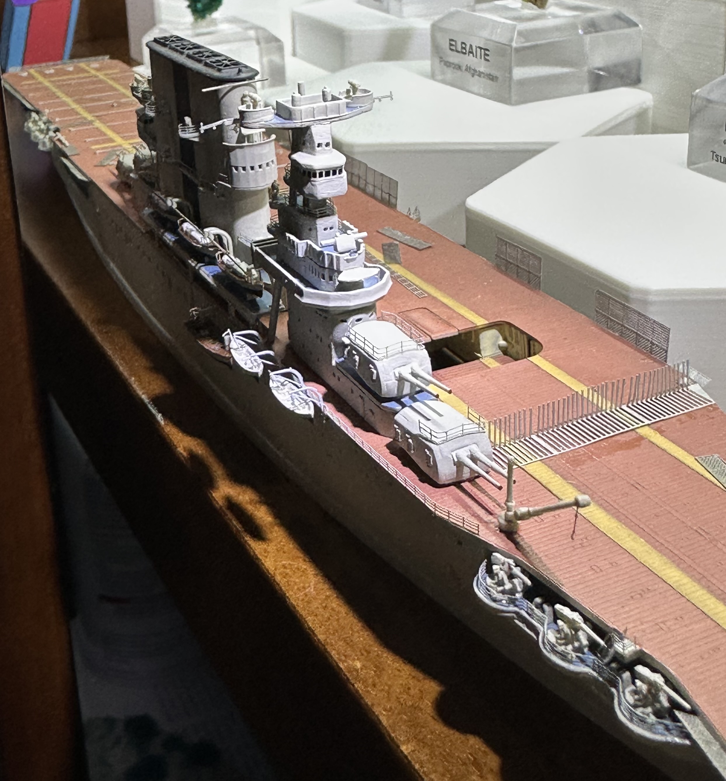

The first on the slipway is an 90% complete pre-war Saratoga that needs a little TLC. It was part of lot that I purchased from the collection of the late model maker John Werler. She needs her mainmast repaired, safety nets replaced and most importantly a small air wing. Fortunately that’s a quick fix.

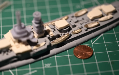

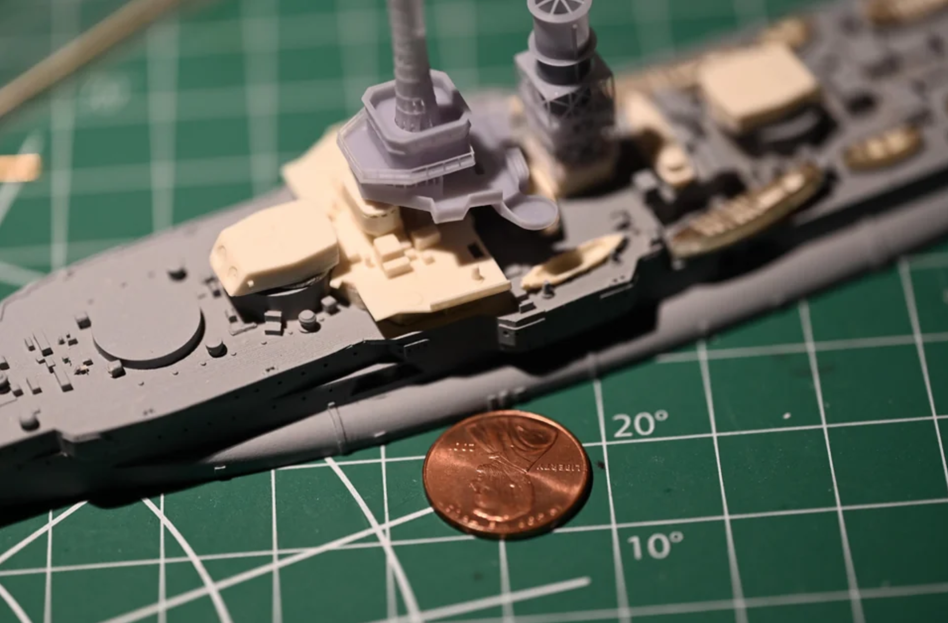

Florida and her 3D prototype parts. Brass USN 12" 45 caliber gun barrels are not available, so we're using the ones from the British version of it.
The cagemast looks good and so do the parts for her funnel. The parts for her superstructure are designed for Utah, but this is a test fit to see how it looks.
Hopefully the hull blister surgery will work.!
File comment: Amidships
File comment: Superstructure to make Florida into Utah

Pictures of what condition Saratoga is in. Lots of glue marks. I might buy an identical kit and transfer parts over for a fresh build.
File comment: Glue marks
File comment: Missing mainmast and rigging
